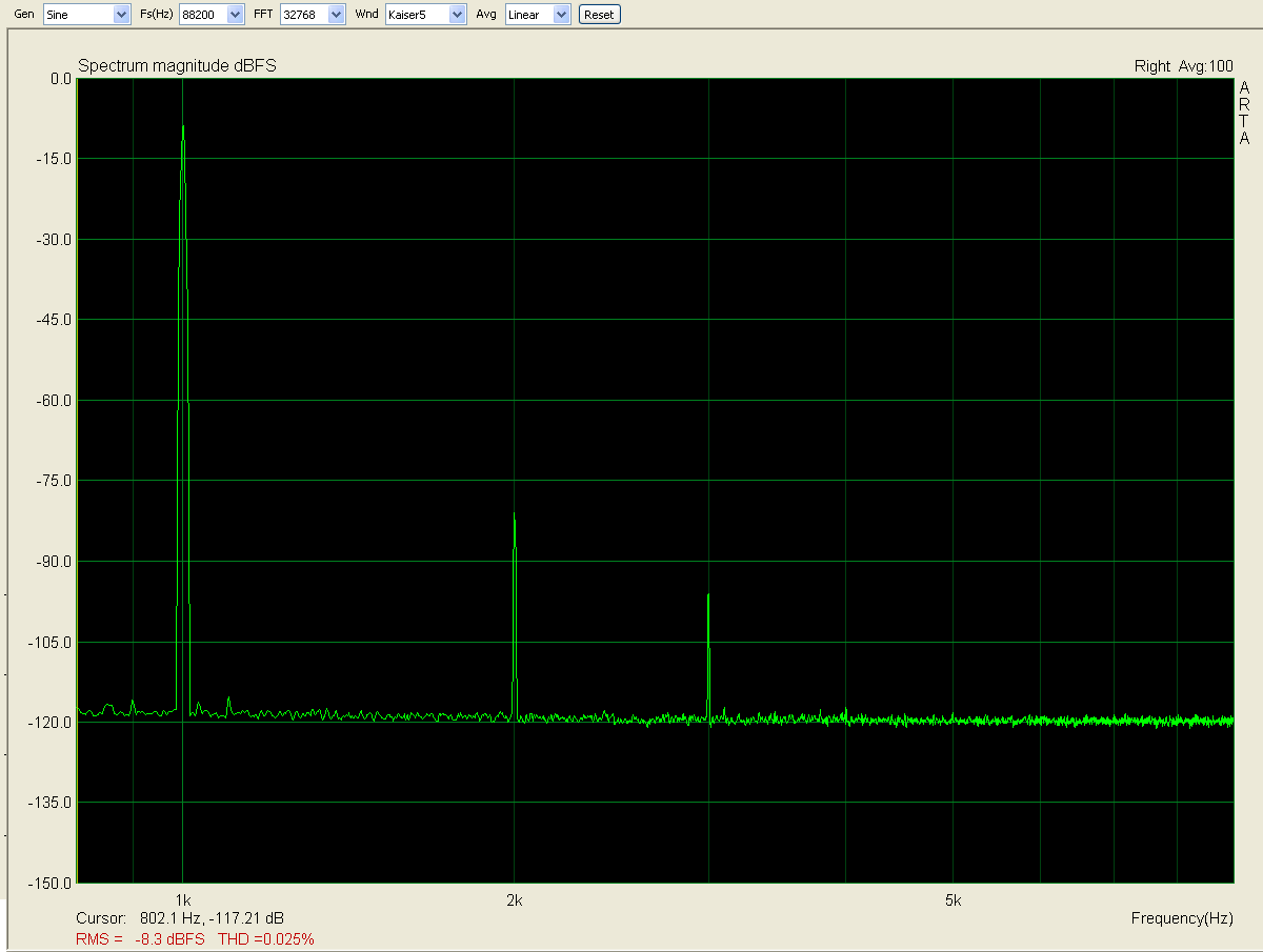

1KHz 1W 8Ohm

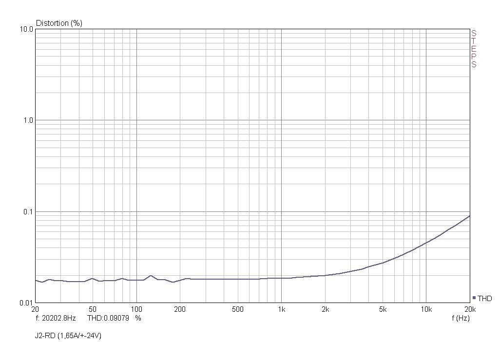

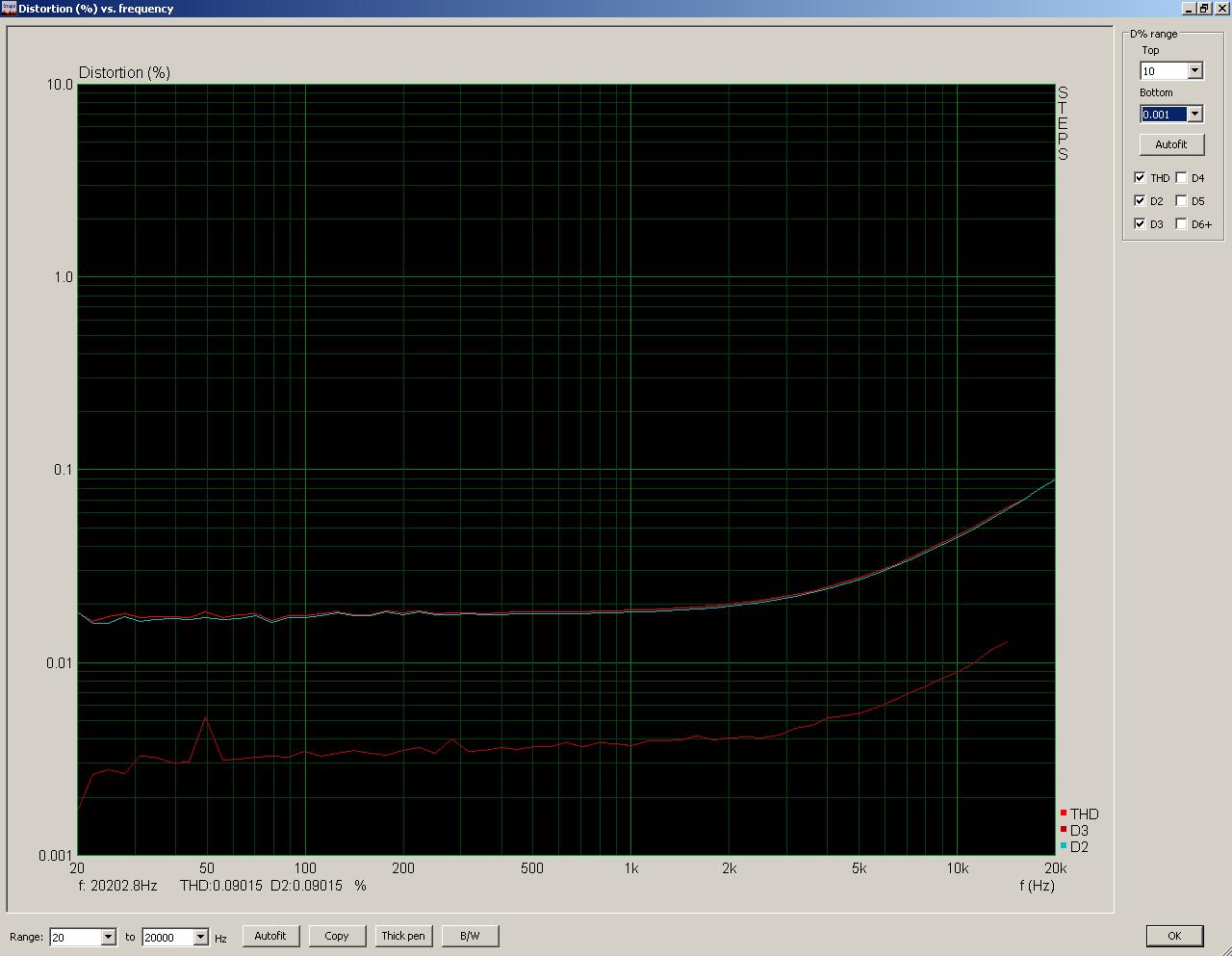

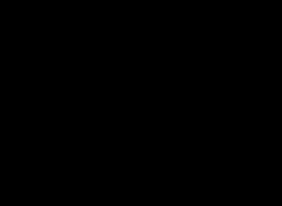

I try again...
Hi Tazz, let me guess your output stage:
It's like rev 1, and rev 1 is the attached pic, but with:
1. Zener replaced with resistor Rxxx (rev 0 used TL 431)
2. R2=R6, C4, VR left out, R1 chosen to provide symmetric drive for a given load, Rxxx and R5 (Nelsons grab box... ;-)))
Can you post your solution with your schematic - measurement looks beautiful. Can you post measurement with different loadspeaker loads??? (In my opinion a weak point)
Regs, Dirk

I did not use a voltage reference but an optocoupler to set the bias the led senses the current passing through the upper fet source resistors and the phototransistor actuates the vgs seen by the upper fet in order to set and maintain the bias. A comparatively large capacitor in parallel takes care of the AC content and limits any adjustment of the bias to very low frequency.
If it is okay with NP I can post my schematic wich I believe is fairly close to the real j2 in a weeks time or so.
