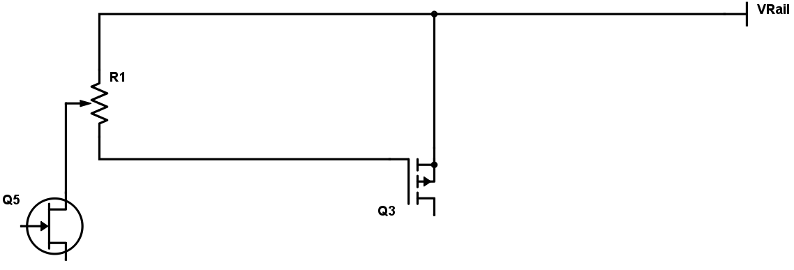

tricky arrangement to achieve gate resistance, biasing, and loading of jfet input (three birds with one stone) and calling it no gate resistance (I can think of an arrangement to achieve this)
Ok here is my 3 birds with one stone trick, before someone else claims it.

Very clever -- and it should work just fine if the leftover resistance is in a reasonable range.
A 1k multiturn trimpot should do the trick, assuming around 8mA through jfet, that should allow 700 Ohms to 800 Ohms for gate resistance depending on your bias point.Very clever -- and it should work just fine of the leftover resistance is in a reasonable range.
You could certainly try lower maybe a 500 Ohm multiturn trimpot, but you'll have less gate resistance

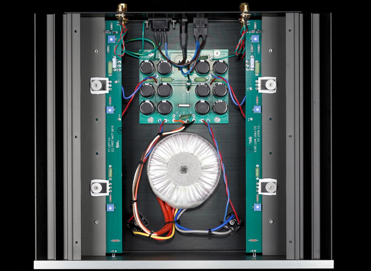

If we look at picture published on 6 moons we can clearly see that toroid main power transformer have no center tap on both secondaries coils ,
there is only four wires for primary side (120VAC+120VAC ) with series connected thermistor in between them ,and in that way that F7 amp is connected for operation on 240VAC main voltage,
and what`s left is only four wires going from two independent secondaries to two Greatz rectifiers ,
Those four green same values wire-wound power resistors on PSU-PCB are ,
-part of CRC-PSU filters
-or for making of two independent virtual or floating grounds points ,which I think that they really are ,
there is one more thermistor on PSU-PCB which is connected in between main earth wire(chassis) and amplifier ground lines for safety reason .

It seems to me the earth pin on the mains are the only connection to the chassis - safety ground that is.
The input RCA sockets are also isolated from the chassis.
The virtual/floating grounds as described by Banat are of course also isolated from the chassis.
In this way currents will not flow in the chassis at all. This is important from an EMC point of view. Currents originating from the amplifier itself will not travel on the chassis, and hence not radiate to the outer world. In the same manner, RF picked up by the chassis will not end up in the amplifying circuitry.

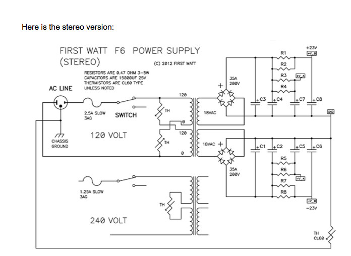

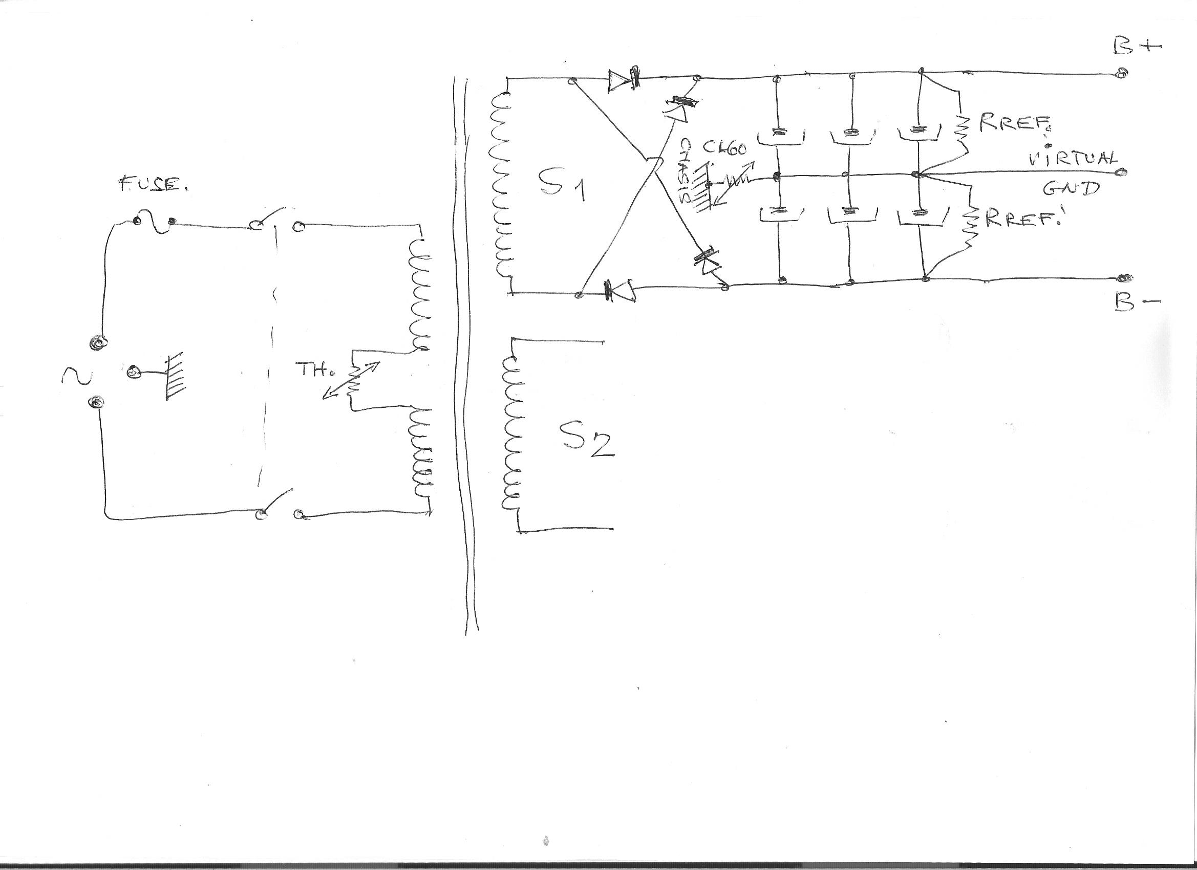

It looks to me like one secondary is for V+ and the other for V-. Each secondary drives a bridge rectifier and a CRCC filter. It would be similar to this schematic from the F6 BAF talk, except with 2 caps per channel for each rail:
I don`t exclude possibility that F7-PSU is done in same way as F6-PSU ,
but maybe this F7-PSU is done different , with two independent virtual grounds points ,
where each amp ground points is returned to associated virtual ground point ,including loudspeaker ground point (-) ,
BTW , my kitchen 24/7 Revox-A78 a/B class amp PSU is done in that way .
I still see the thermistor linking star ground to chassis ground
Yes , it must be installed there for safety reason .

If done this way the only chassis connection per audio PCB is via the thermistor. The screen of the input cable will be connected to the virtual ground. Minus pole to the loudspeaker is isolated from the chassis and is at virtual ground.
Yeah basic stuff, consistent with all the firstwatt amps.
Yes ,that`s right ,
it`s same chassis grounding scheme as for F6 ,except that now we have amps virtual two grounding points done via four reference same value power resistors , which in case that some output power device fail short in the same time limits DC current on LS , virtually protecting LS coil from damage.

whatever - from pictures at 6moon , it's visible that xformer is regular 2 x 18Vac jobie
Yes I agree is to much guessing ,
that have to be stopped by presenting original F7 scheme , done by guess who ?
Edit , now I see that white label on PT where is fuzzily signed that secondary is 2 x 18 VAC .
