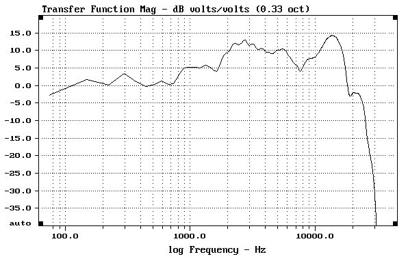

Just to throw in a word here about my OB impressions.
I am using the Basszilla/Visaton style OB design with Lowther DX4 and Eminence Definimax LO15 drivers.
I have not been running the Woofers with the DIY FirstWatt F2, but intend to (only one channel is putting out the right gain), but running them on a chipamp. With a pair of 2a3 monoblocks driving the lowthers, the open baffle beats a Medallion front loaded horn for imaging (soundstage). Detail is close, but the lowther is good there. I drive the top end with Fostex T90A-EX.
I find the low end is a bit harder to tune perfectly. I have two Adire 10" subs driven with plate amps to supplement below 70hz right now. The crossover point between 180 and 220 seems good for the eminence drivers. I am using a DCX2496 stock as a x-over. I beleive I need some help measuring the frequency response for the room, and adjusting accordingly. More likely I will play with my ears until I go nuts. :bomb:

The interface between woofers and full-range is the most difficult
part, and often does not meet expectations even when the result
is fairly flat. The crossover has to be tweaked carefully to align both
the phase and amplitude.
Most of the time, when you get that right, the response below that
region either seems adequate or is easily EQ'd.

I think the amplitude is off for sure, it sounds like there is low bass output, even though the gainclone has well , tons of gain. I may be wrong here. It's possible the bass just isn't getting in the way. When it was crossed at 250, there is a low end glare of some sort, not tubbyness (If that's a word?).
I didn't think of playing with phase. The DCX has lots of flexibility in gain, phase and crossover points to play with here. It's encouranging to know that my initial impressions are a known tweak spot.
I added the right channel for viewing pleasure.
Is this graph for Audio Nirvana Super 12? If it is, then it looks a bit disappointing. I was thinking of AN12 Cast Frame in open buffles driven by F1 amplifier, but if performance is similar to AN Super 12 then i doubt i could get any decent bass. And the highs seem more limited than in Common Sense Audio graphs too.
