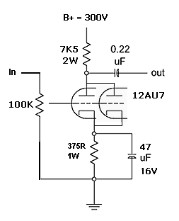

Ok this is my first try for tube preamp, your opinion on the circuit will be highly appreciated.
Below is my operating point for 12AU7 twin triode connected in parallel:
Plate Voltage = 185V
Plate Current = 7.75mA
Grid Voltage = - 6V
Thanks in advance....

fscarpa58 said:hi
How load resistance is expected for that
stage?
Federico
Hi s2kov,
Yes, your working point is o.k.
if you want less distortion try 15k at anode
and 200 at cathode. You still have 5V peak to peak before
saturation. Gain will increase of 1.8 db. But output res will rise from 2.5k to 3.2k OHm.

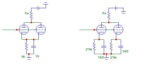

Speaking about output res it seems quite high.
I will consider the use of an output buffer or of an SRPP stage.
...by using a 180 ohm resistor and a 47ufd capacitor on each cathode...
if res and caps as to be put at each cathode (advisable thing) the value of res has to be doubled and the value of caps halved to retain the original characteristic.
Bye
Federico

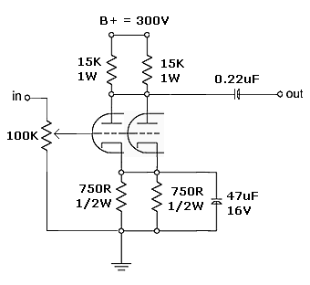

Hi Federico,
Thanks for the help! Actually, operating point for each section of triode tube, Rp is 15K and Rk is 744 ohm. Since the design is connected both halves in parallel, Plate current will become 15.5mA (7.75mA + 7.75mA) thus, Rp = 7.5K and Rk = 372 ohm
Is it right?
How did you get 200 ohm for cathode resistor?
Andy
Is it right?

Is this what you mean? Will i still get the an operating point right?....

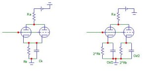

Hi s2kov
The resistor values I have suggested (ra about 15k and rk about 200) come from simulation
(I use Micro Cap 7 demo). These values allows for lower distortion.
Regarding the duplication of the resistance to assure more similar static current in case of badly matched tubes, the values are reported in the following pic.
Ciao
Federico
Ciao
Federico
