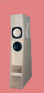

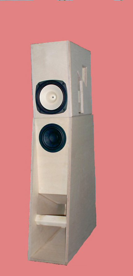

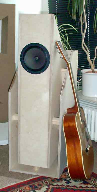

Hello,
may be this could be a solution:
Sats with sub for small rooms
Trumpet-Sat
Schalmei-Sat
sub
alphorn
or double horns like
Saxophon and
RDH20
extrem good Impedanz for Tubes.
surf my HP

Thanks for input
Hi Everyone, thanks for the input.
My carpentry skills aren't the greatest and I don't have much equipment, so the simpler the better.
- The Dallas 2 looks difficult to build.
- The Sachiko looks nice but possibly expensive and a labour of love? (Plus if it doesn't work well outside of big spaces then probably not worth it?)
- I like the simplicity of the BIB cabinets and that they appear to have good bass.
- The metronomes look nice and easy to build, but bass is weak?
- Can't get much info about the Woden.
So far it looks like the BIB boxes are the best bet!? The main challenge being size...

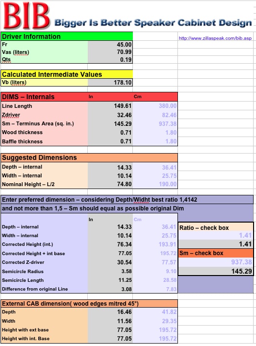

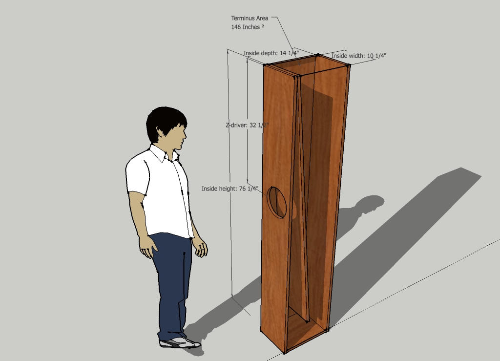

Any recommendations for where to find the best BIB plans? Or can I just use the BIB calculator spreadsheets to figure it out for myself?
Thanks.

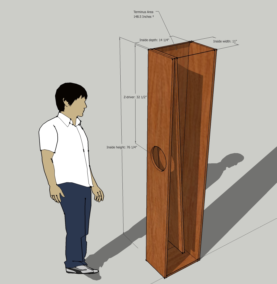

a few quick thoughts:
It's hard to get the fullest level of wide-band performance and finesse from drivers such as 126/166/206 / AudioNirvana / Lowther, etc., without enclosures as elaborate as any of the numerous BLH / Olsen style manifold designs mentioned yet or to follow, and the accompanying build complexity
Math for BIB has already been done for many popular drivers (see Jeff's site for dimensions and build suggestions)
Bigger Is Better 'BIB' Cabinet Dimensions - ZillaSpeak

1) plywood will sound better
2) if 19mm is .75" then that's great - but i like to double up the front and back
3) i use butt joints, glue and screw but i am a hack carpenter
4) i nailed little metal furniture feet to mine
5) some here will say CAT 5 (which i used in mine) but i think 16g wire is fine too
6) i used acousta stuff
If you put spikes on the bottom of your BIBs you may scratch up your floor when moving them. Sometimes i think about adding handles on the sides to help move them. When i do move them, i hug them close and hump them around into position.
Enjoy them!
Zilla
