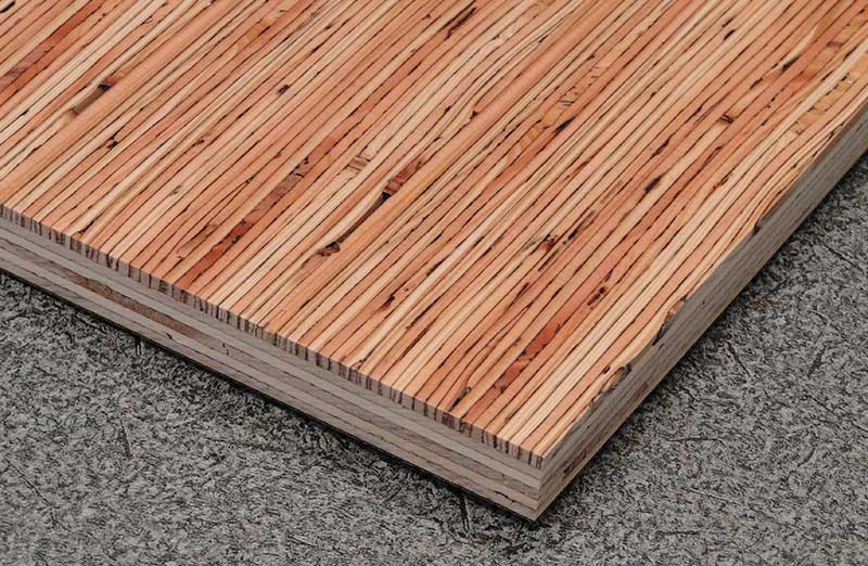

I like what this guy did with birch ply. Photobucket
That's a lamination of stacked ply. I also like that look, but it is extremely wasteful, both in material and cutting time.
If you want that look without so much waste, there's this excellent looking stuff (made in Melbourne):
MAXI Edge Plywood Panels
I dunno the cost, but am guessing it is quite high.
