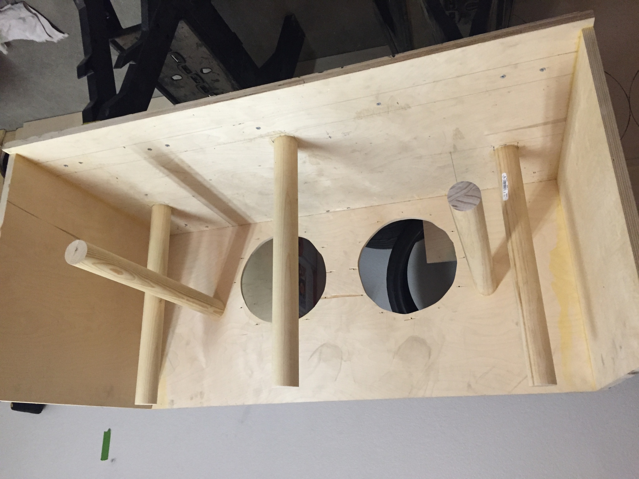

(2) Don't overthink the bracing. It would sound fine with no bracing. Just think of it as a way of using up all of your offcuts. That's easy to do. It makes sense. It costs nothing and might be an improvement.
I've attached another example to show how simple / humble it can be.

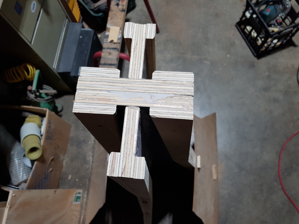

The photo shows my 17mm formply & some regular 12mm stuff (I think the latter is from Bunnings, what they call "Premium Grade Radiata plywood"). This photo was taken halfway through a session with a sanding block - I was grinding this section flat, to make up for my dodgy workmanship earlier.
It is easy to work with, get a good clean edge, don't have any voids.
The main drawback to formply is that you can't join it face-to face with PVA - nothing water-based will stick to the face. Dado joins would work fine, though.
I suggest you compare a bit of it vs the premium stuff with 13 layers. See if they have any offcuts lying about. If the formply seems less stiff, or cuts less cleanly, or the edge grain shows any voids, pay $100 extra for the fancy stuff.

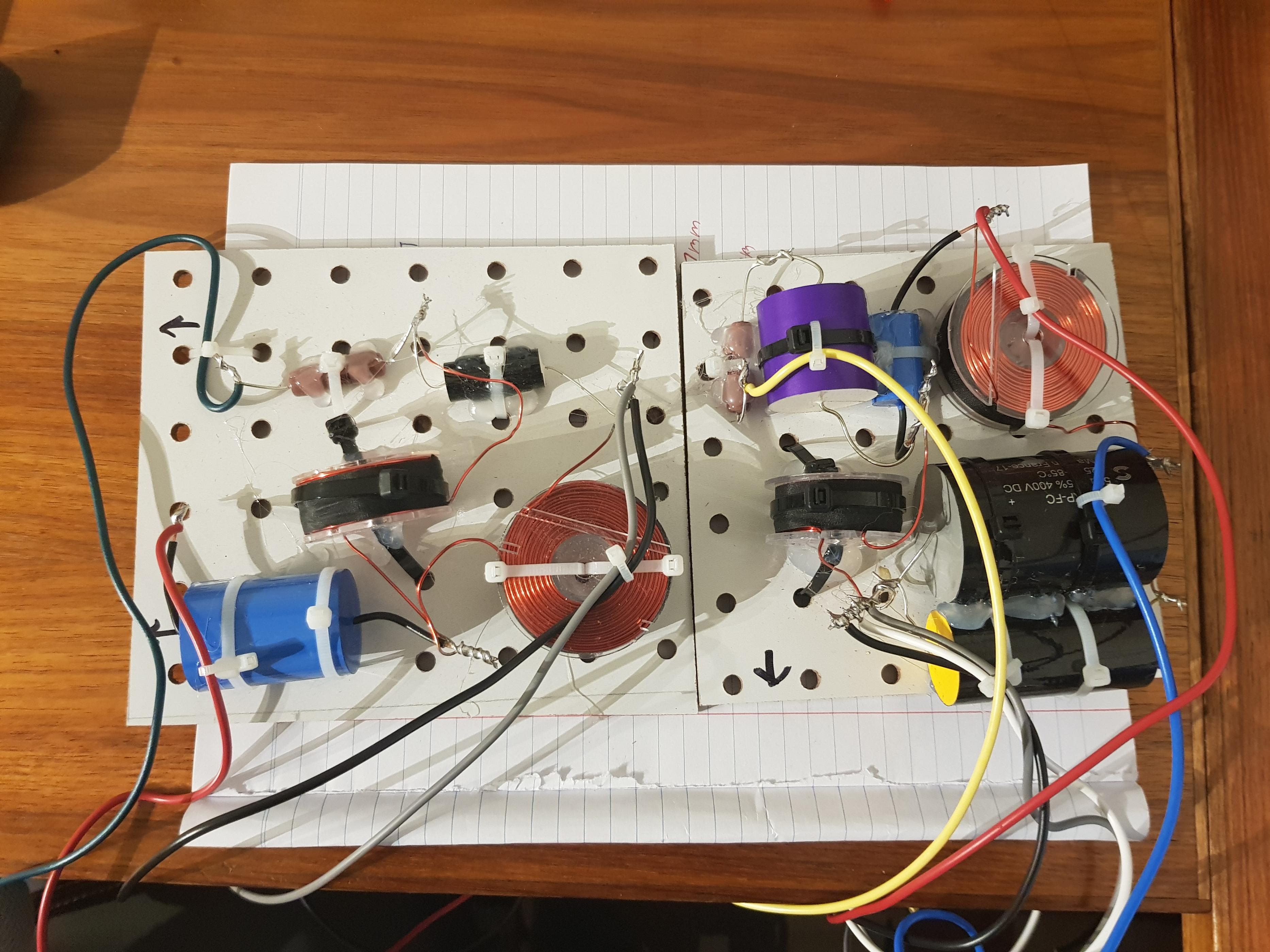

2 Crossovers needed per speaker, If I change the bracing how would I mount the crossovers. I'll take a lot at your suggestions and try adding to horizontal braces below and above the midwoofer, running the length of the cabinet interior.
Woofer is the 4ohm aluminum cone version, it is what the crossover's where designed for.
Here are a picture of the crossovers. The wires coming off it are around 50cm long.

Is there a lack of space?2 Crossovers needed per speaker, If I change the bracing how would I mount the crossovers.
I think others suggested something similar above.I'll take a lot at your suggestions and try adding to horizontal braces below and above the midwoofer, running the length of the cabinet interior.

Did you build the crossovers or were they done for you?Here are a picture of the crossovers. The wires coming off it are around 50cm long.
Crossovers came pre-assembled.
