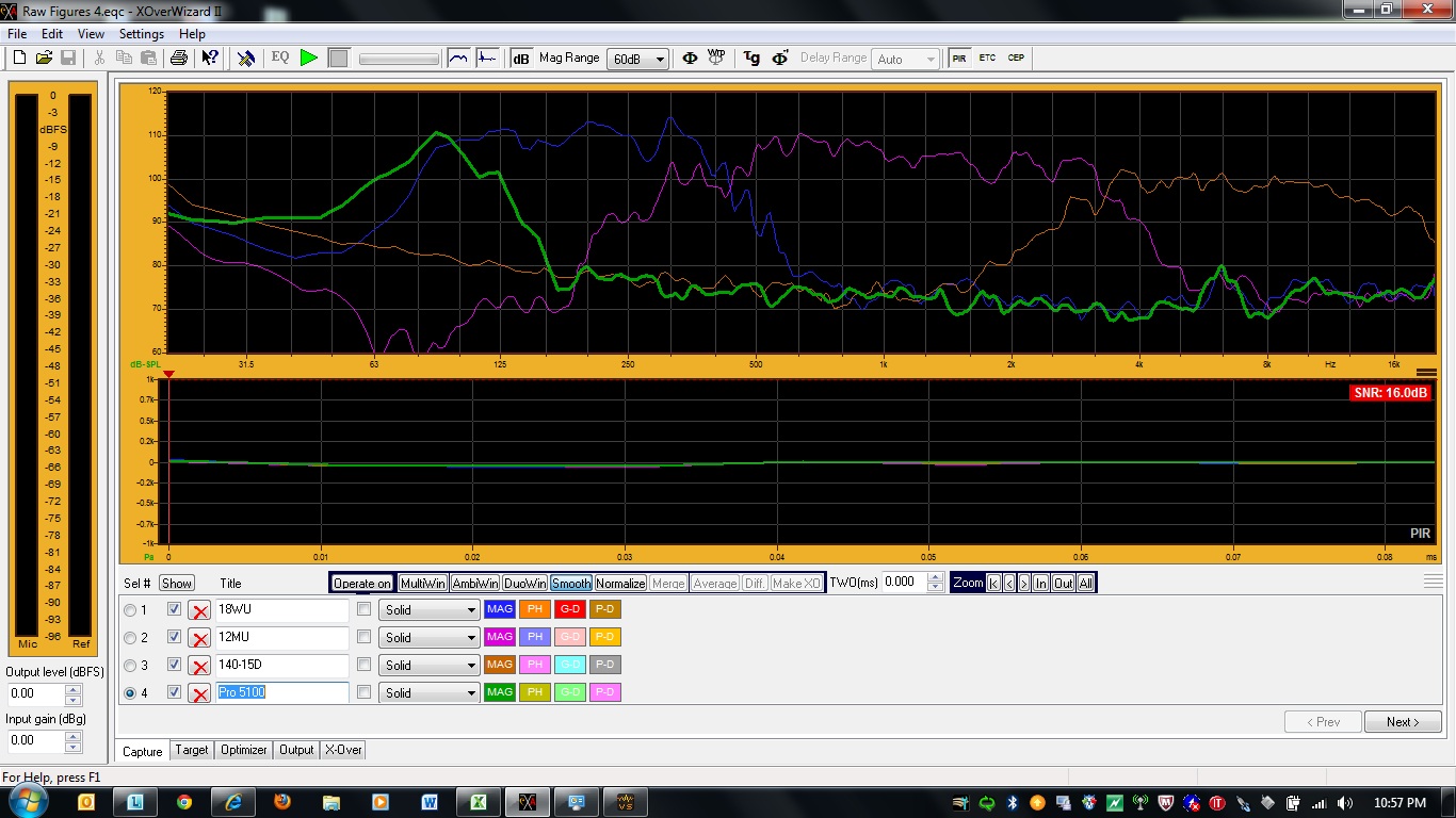

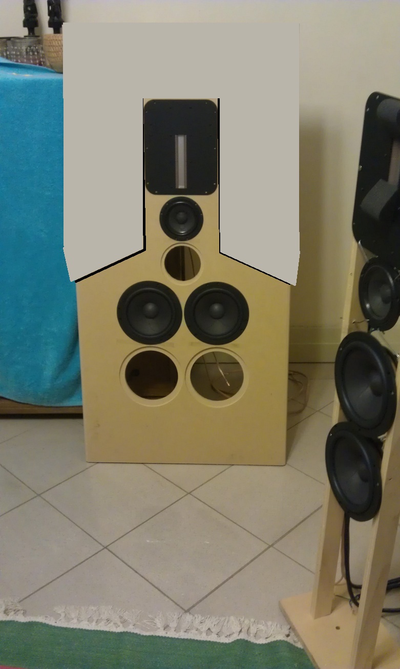

Hi Greg, I am still in the early stages of learning how to measure. My plans at the moment are to just see if one design or another lends itself to producing better results, as you can see from the two graphs even with the lumpy looking response the mid bass improved when put on the baffle whereas the mid and tweeter not so much.
I have been using the 12MUs anywhere between about 1300Hz – 1600Hz and 3500Hz, you think I still need to go even lower to around 500Hz? That wouldn’t leave a great deal for the mid woofers then would it?
Yep had already looked at a modification of the top end to something more like this.
Want to experiment with measuring in different spots and distances before I start to chop.

Well, 1.5-3.5Khz is not a mid. It's more like a filler driver for a two way. Leave just the "impact and weight" region to the midbass and get all of the primary vocal region in the mids. You will probably have to EQ their low end response to bring it up as well, but ought to be a much more accurate way to go.
Greg

I set up two copies of the software one with the old crossover and one with the new. A very different sould but crossing over low and high does make is sound much crisper.

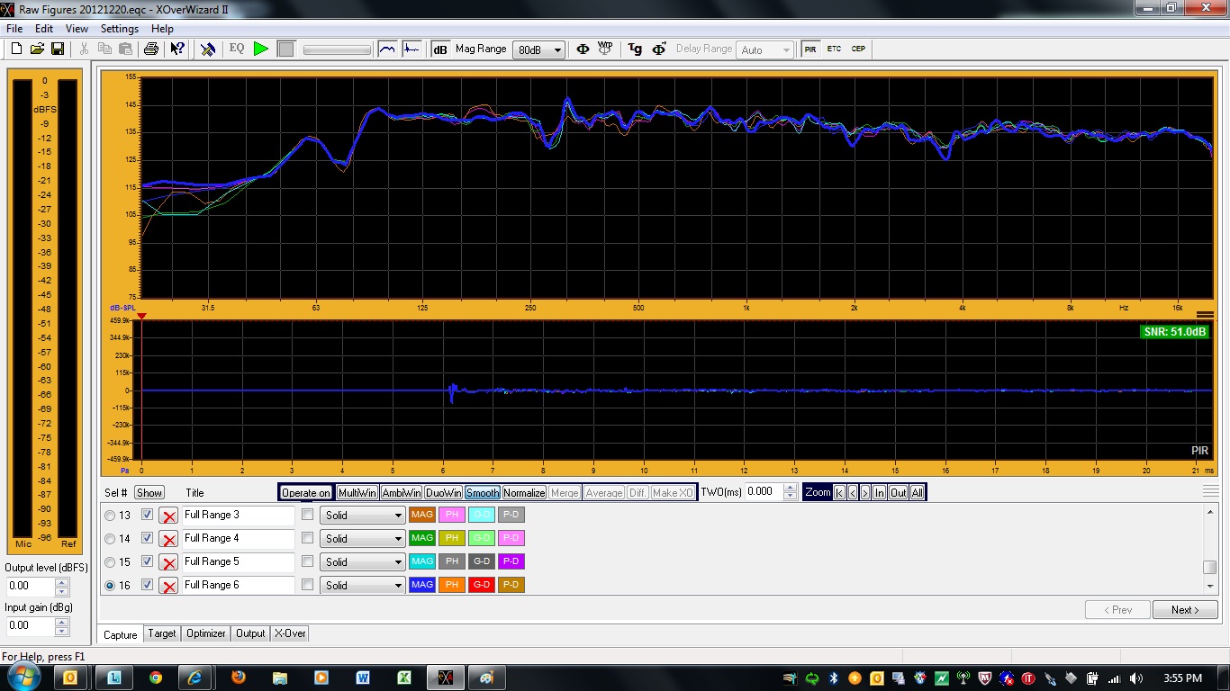

I also notice that I am not maintaining a high enough SNR. Its ok on the tweeter but by the time I get to the mid woofer it is too low cauasing all sorts of lumpy graphs.
3 out of the 4 were in the green for these measurements with only the woofer below acceptable. Notice how much more level it looks.
Also tweeked the crossover to start a bit flatter.

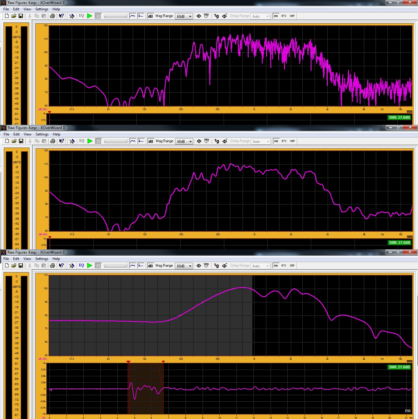

I'm using the same software. And found out that instead of using smoothing. Try "Multiwin". I shows 3 red lines. One at 0 mm seconds, one to adjust gating and the third you just leave alle the way out where it is.
So - number two red line is the one to focus on. The first pulse, is when the first direct sound hits the microphone. So the trick is to find out how far the sound has to travel from the speakerunit - down to the floor, and up to the microphone(this is your first reflection). and if you find this distance in mm-seconds, and place the second red line at this point. Then you are actually canceling out the "room" :)
The 300hz dip. Might just be the room acoustics. Measuring low in frequency is hard. Because you have to remove reflecting surfaces. putting the speaker on a tabel, helps a little. You can also try to lay the speaker on its back and hang the microphone from above. The lower the frequency, the longer the waves. Therefore you have to move reflecting surfaces farther away ;)

Thanks Tordenguden, at the moment I am just trying to get the get the basic speaker design as good as I can get it without any correction. I am using smooth simply to get a line that can be viewed (the non-smooth is impossible to view properly) not trying to get it as good as I can.
By using just the smooth I can do a much more “fair” comparison of each reading, as using MultiWin does alter each curve quite differently based on the amount of time spent refining it.
Robert has already given me a few clues on how to use the MultiWin, and I have experimented with varying degrees of success. You mention that you leave the first line at the far left (0ms) and move the second red line to the floor bounce (start of first bump). I was under the impression that you put the first red line at the point of floor bounce and the second and third red lines to the right of that. I might give what you’re doing a go and see how that goes.

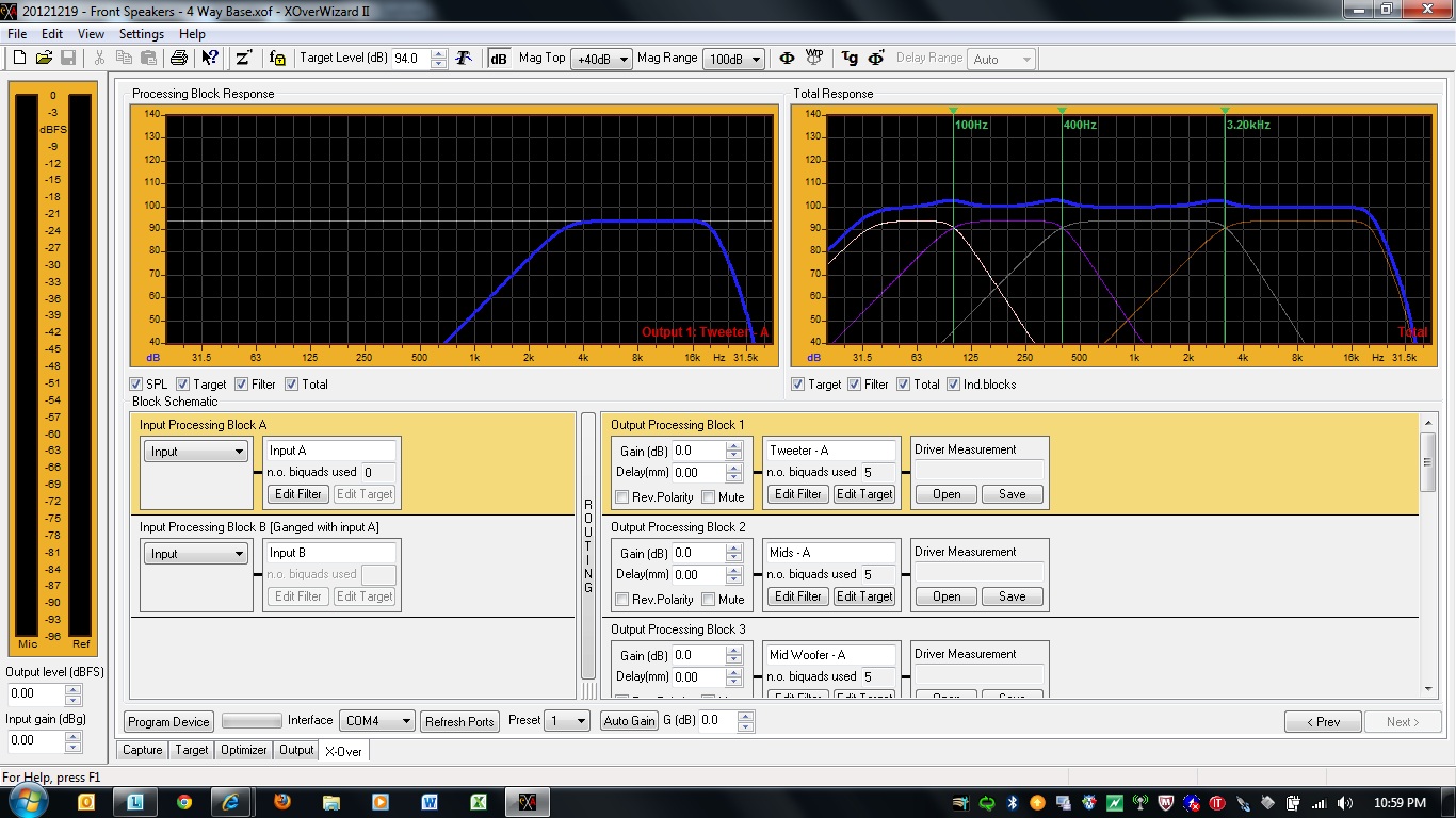

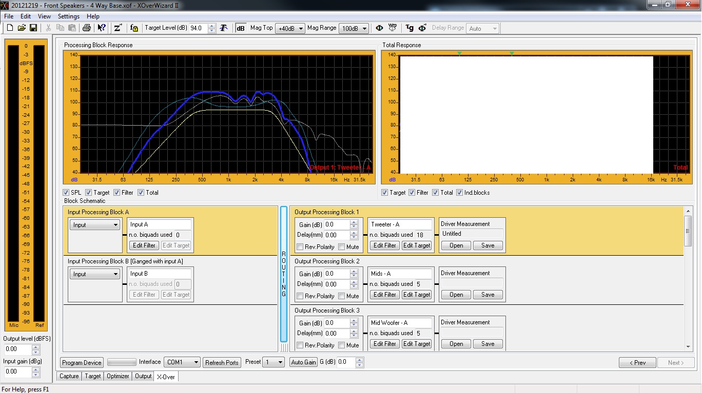

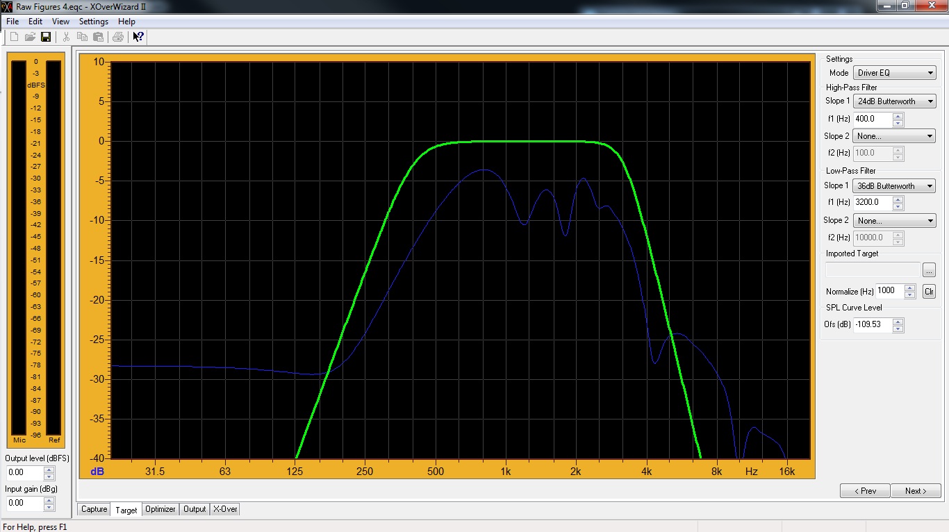

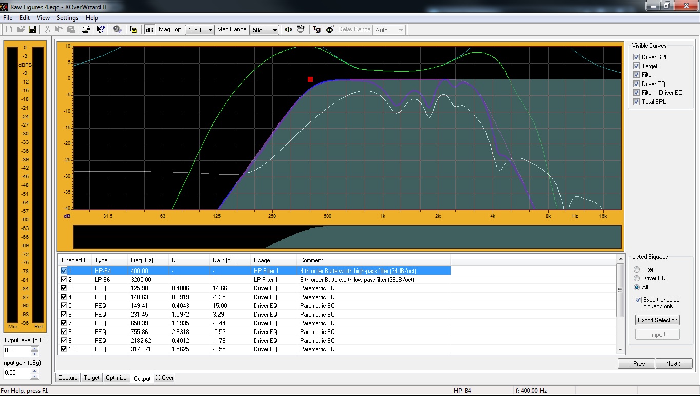

Hey Greg, the software has plenty of options for EQ built in. I am just trying to avoid colouring the results by using them at the moment. I can select and deselect just about anything in the software.
In pic 1 at the top is the raw capture, below that is with a basic smooth applied, below that is with MultiWin (gating) applied.

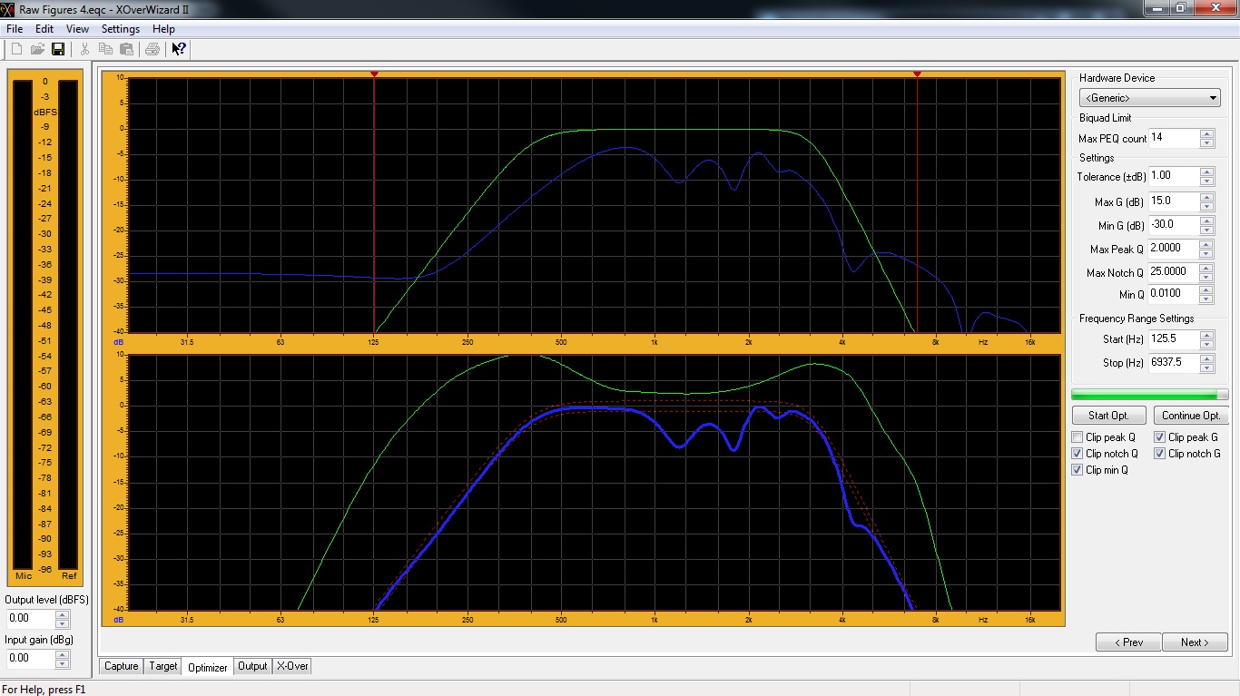

In pic 2 you tell the software what crossover slope you are aiming for so it know what to match it to.
In pic 3 it optimises the captured results to make it fit the desired crossover pattern as best it can (double red dotted lines)
In Pic 4 it shows what EQing is going to be applied to the Xover
In Pic 5 it shows the corrections added to the crossover (blue line)
You have to go through each of the drivers in turn to create an overall map of the drivers, after repeating the process for all drivers hopefully that thick blue line will be flat from start to end.

Have you considered a 3-Way+Sub? Looking at your drivers, I'd be so tempted to stack them as a line. WWMRaalMWW and let the 18" (in a simple U frame) add to the lowest octave. A simple narrow-ish (hourglass maybe) baffle with more wing(s) around the woofers. Just for kicks anyway.
