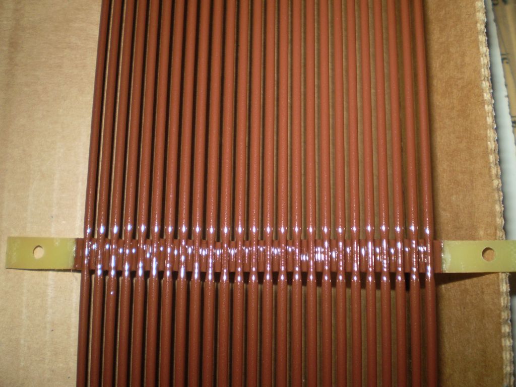

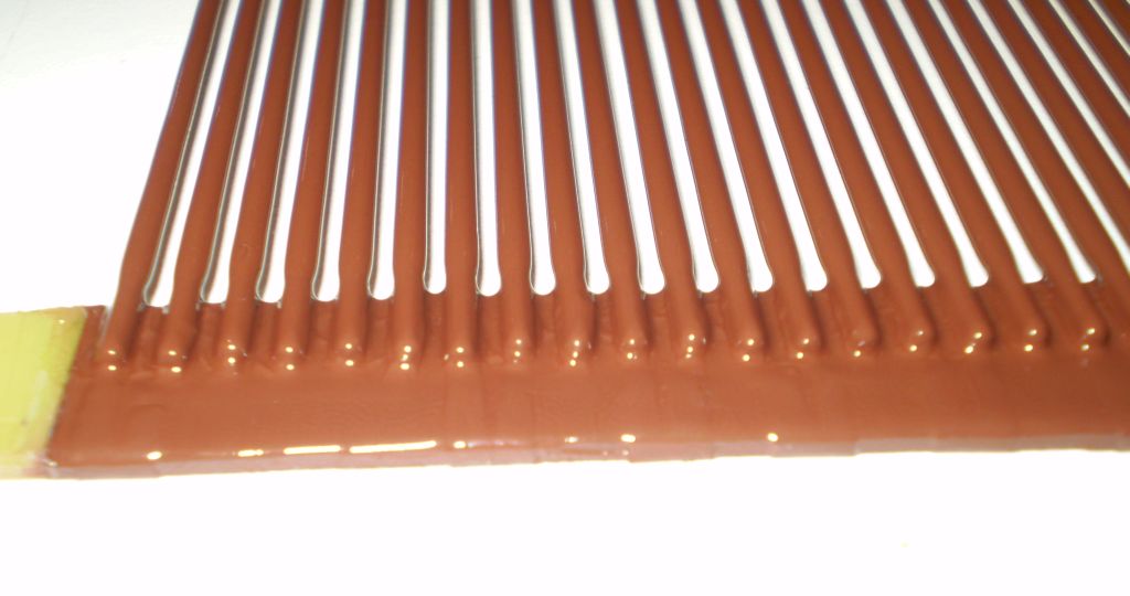

So I am having some arcing during testing. I am using the HV DC Bias to test these. The dc bias produces about 2.7 kV. Anyways, I seem to be getting a lot of very small arcs (<2mm) around the edges of the slots. Maybe 3-4 locations per slot. These locations don't appear to be damaged or anything, even with magnification. It seems as though the coating is just too thin there.
I have already coated them 1x with etching primer, 4x with red primer, and 5x with Clear 2X Gloss (rustoleum).
Do you have any recommendations? My first thought is to simply lay on more coats of clear acrylic with a focus on getting it onto the edges. I will post some pics later.
Hmmmm......that should be a pretty thick on the order of at least 8-10 mils
However it will be much thinner were ever the sharp edges are.
Now you see why we stressed that factor so much!! ;)
Yes, I would use more coats of clear concentrating on the edges and thinnest area's.
As you can see I had the same issues around my PCB stator supports and I had to mask off the area that didn't need any more to keep it from building up even more and getting to thick.
Once I got the target area built up and even with the rest of the surface then I gave the whole thing one last coat.
Since the 2X stuff is so thick you can choose to switch to regular thinner spray as this will help you to control how much build up there is.
Also it runs easier and faster, so you can use this to your advantage to prop your stator at an angle to control the enamels flow and concentrate in to the low spots.
I forgot to mention that after laying down your primer coats it is a good idea to knock down the surface's roughness with a 3M pad or very fine steel wool or even very fine emery paper.
Although it may not be necessary but it does help with the flow and not trap any air bubbles that can form due to the roughness of the primers surface.
It also exposes any that could have formed during the primer process as well.
I mean't to do some more investigating on this but I never did as I don't do this when coating Wire Mesh.
Make sure that it has been cured before you do any testing as well.
It will take a few months for it to exhibit any hardness but it is still useable after a 48 hours of drying time depending how thick the material is.
I typically waited until the next day before I added each next two coats of paint.
During my arc testing of samples I found that even though it seemed to be dry at 6-8 hours later was still a bit gummy and the static voltage was trying to pull the coating right off of the metal.
And, It did in one test!!
It pulled off an area the was a perfect circle that had a diameter of approximately 1-1.25mm.
It had perfect edges and stress cracks all around outside of the circle like someone had drill a tiny hole in a piece of glass.
It was at this point that I had discovered another reason of why having a primer base was the best method to use just as all of the painting rules will tell you.
Here is all of my Painting process pictures, But you will have to scroll through the thread to find them all,
A Segmented Stator Desktop ESL
And the pictures that I mention about the thinning around the stator supports.
Also here his the link to my description of my painting process and testing.
I forgot to post this for you as I did just recently repost this in another thread,
http://www.diyaudio.com/forums/plan...tric-coatings-fact-fiction-2.html#post2893839
jer :)

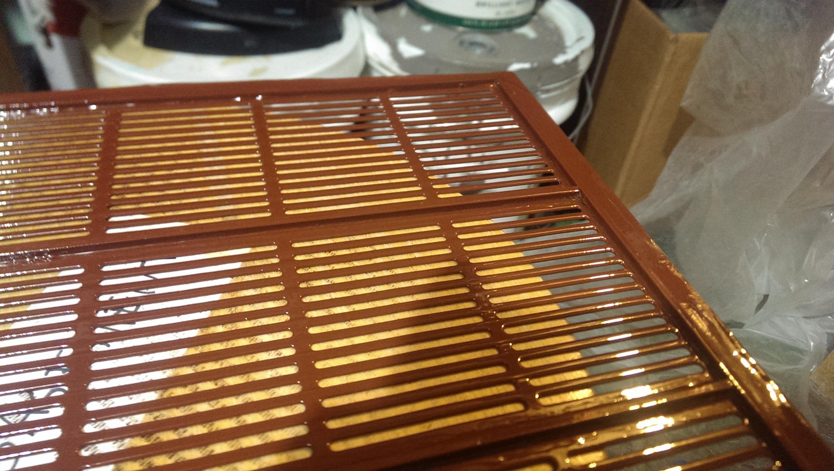

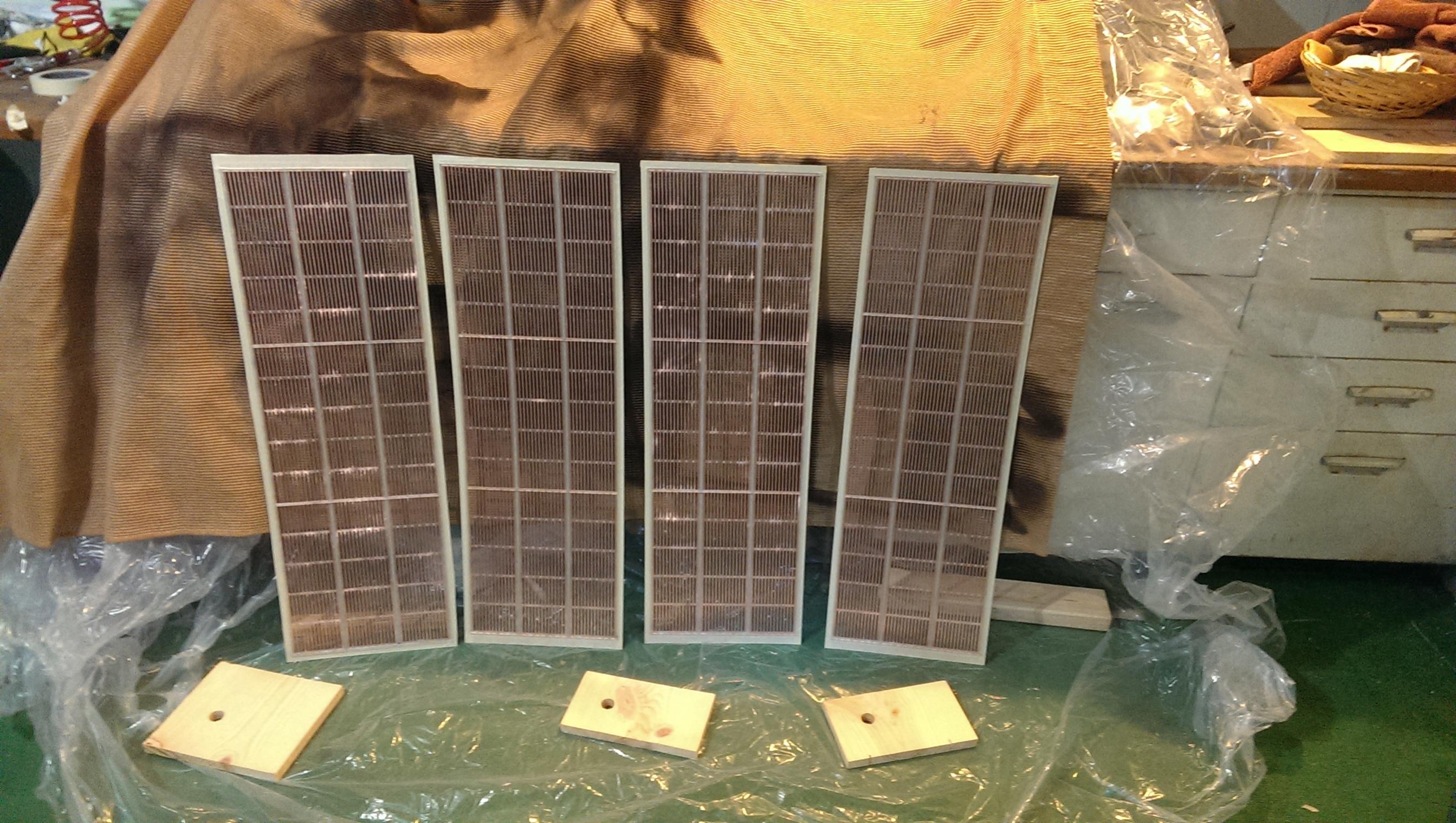

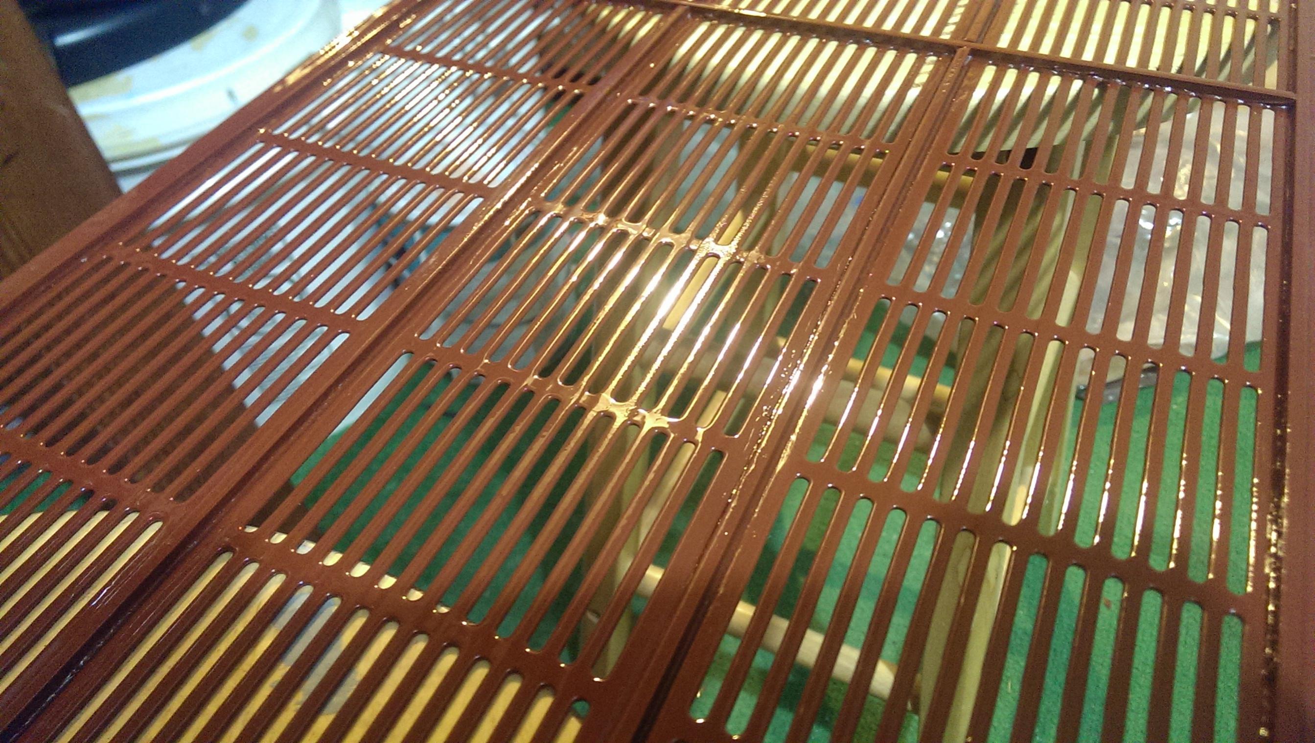

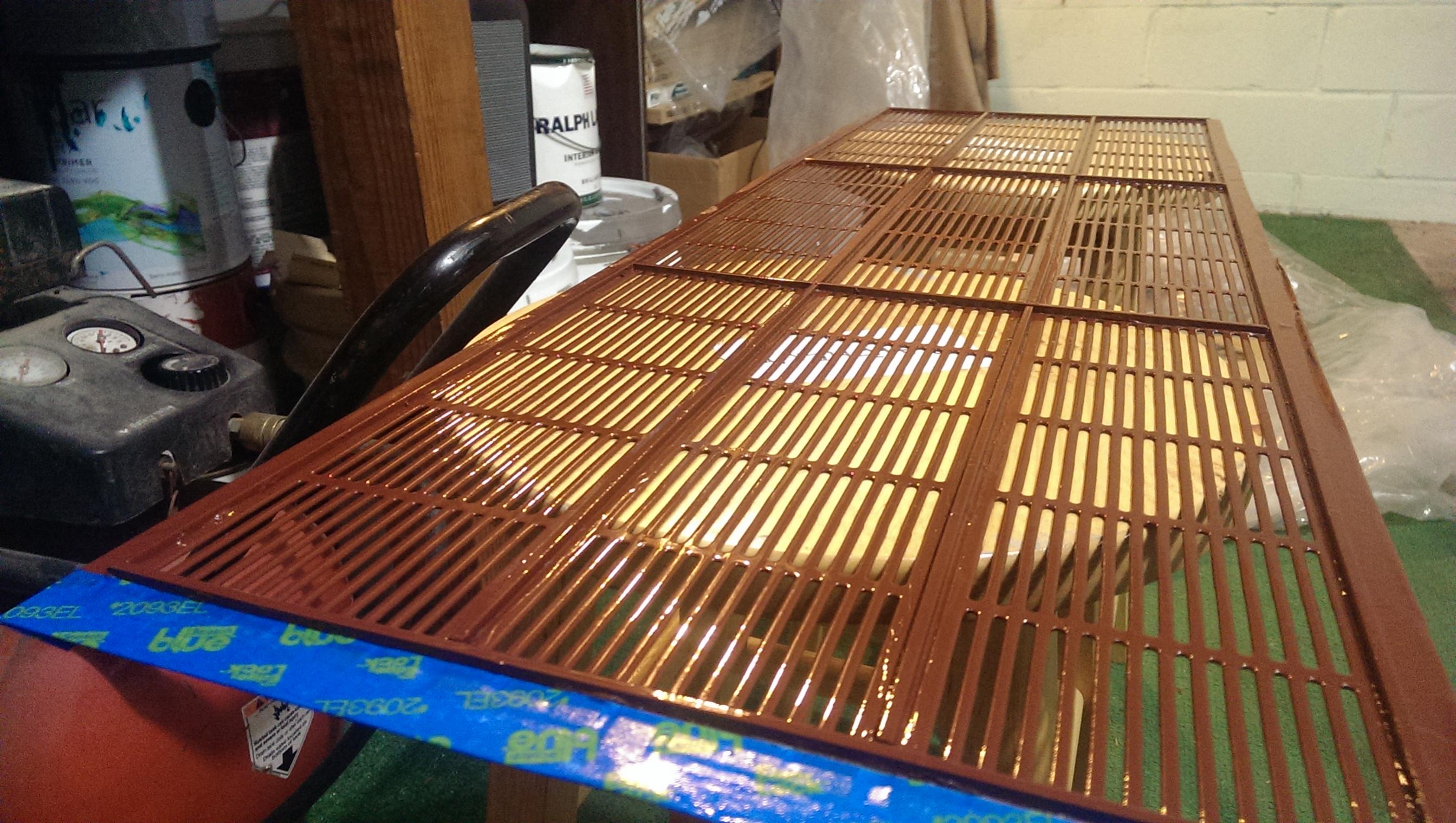

Alright, some good news. I got some regular rustoleum clear enamel and gave each panel 2 coats. For each coat I let it dry on an angle. Now, after 24 hours I seem to get very few arcs, and they are no longer at the edges. Rather, the only remaining arcs are in some tough to reach corners and such. So now I'lltry to fix it with acrylic nail polish and then recoatthe whole panel again. Then test!
So I have finished the coatings and they tested just fine using the 2.7kV DC bias. The next test is partially assemble and hook them up to an amp (no diaphragm) and transformers and look for arcs.
I have attached some pics of the panels before coating (after acrylic ribs are added), after coating, and the in-progress DC Bias (no terminals or connectors yet).

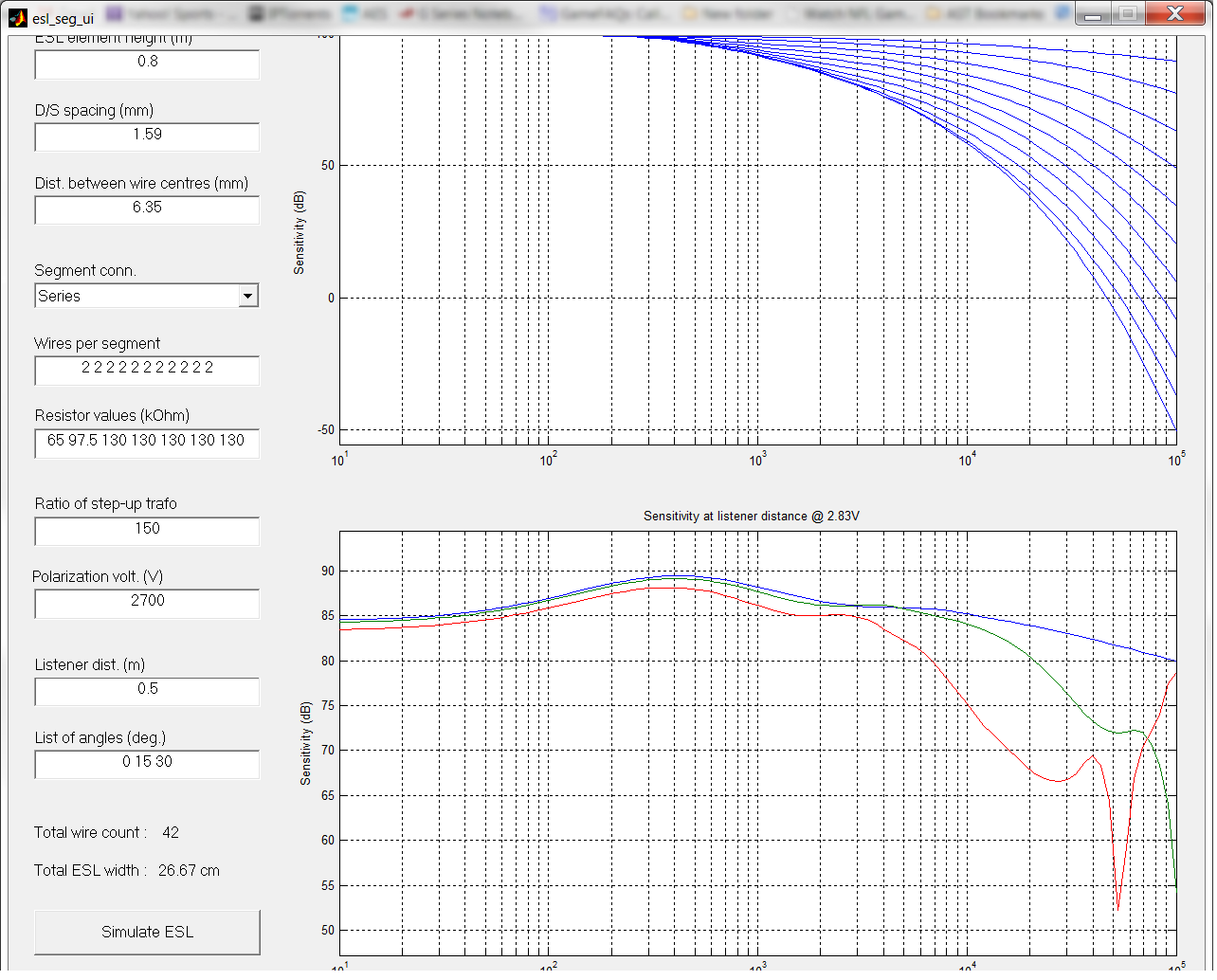

So I have made some calculations using the AES paper (along with capacitance measurements of the panel/segments, about 40pf per segment) and I calculated a R of 65kOhm. This assumes a ladder-type symmetric transmission line.
Now, using that value I have used the ESL_seg_ui to perform some simulations. The resistances come from Fig 6 in the AES paper (divided by 2 to account for the arrangement difference). I must say that the off-axis response seems to be worse than predicted by the AES paper.
Does anyone have any ideas as to why this is so? Should I be using different resistor values? Is it a consequence of the simulation? I seem to be able to get better off-axis response using some different values, so perhaps there are better ways to calculate these resistances.

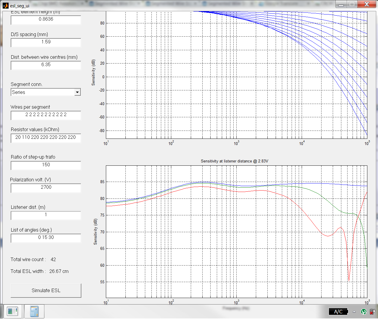

So I ran some more simulations using some new resistance values. I started off with 220 kOhm (these thick film SMDs are easy to get and cheap) and got some seemingly better results. The off-axis performance is not improved but overall it is flattened out at higher frequencies. Still though, I can't seem to change the off-axis response at all. Perhaps this is the best that can be done?
I must say that the off-axis response seems to be worse than predicted by the AES paper....Does anyone have any ideas as to why this is so? Should I be using different resistor values? Is it a consequence of the simulation?
Hmmm...I have always found simulations to match the AES paper results quite well.
I should have time during lunch to throw together some figures that will help correlate the resistor values from the AES paper with what would be equivalent in the ESL_seg_ui.
With some help from golfnut it seems that I am able to get some better results. I have achieved some much better results using ideal values. Of course, using values of easily attainable components resulted in slightly different results. This is better, though, with about -6db at 30 deg off-axis
Aah, I see golfnut has already helped out with resistor values. Thanks!

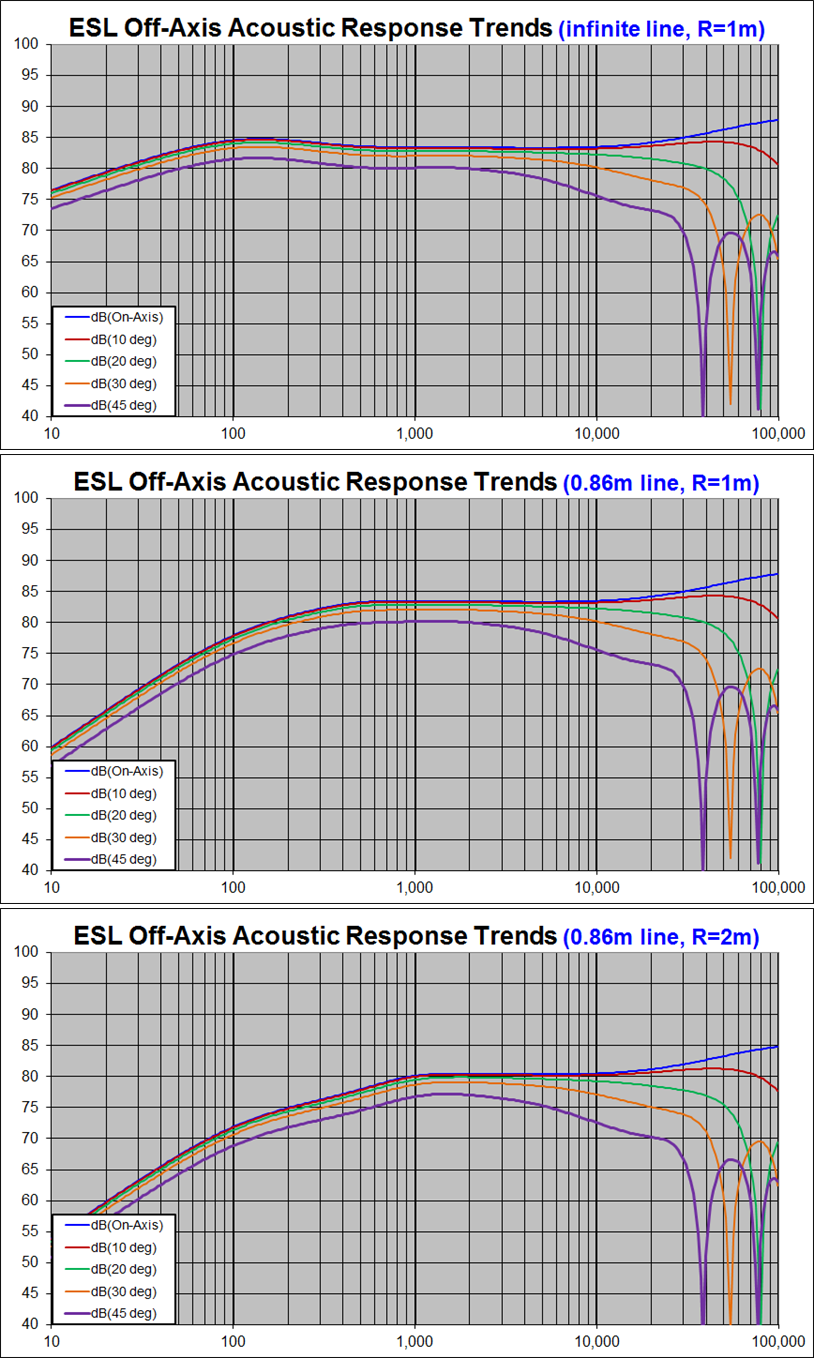

One thing I wanted to mention is that your panel is pretty short compared to floor-to-ceiling height, so it will behave like a finite line source. Attachment #1: shows a comparison of calculated response for an ideal(infinitely long) line source(assumed by ESL_seg_ui) with that for a finite source at distances of 1m and 2m. Note that as you move away from the finite line source, the LF roll off point moves up in frequency. This is the reason the AES paper recommends a floor-to-ceiling height…so that the response will not change with distance from the ESL. As it is, you will need to plan to tweak your response/crossover for your expected listening distance.
For more details on finite line sources, see post here:
http://www.diyaudio.com/forums/plan...r-esl-simulator-esl_seg_ui-2.html#post2913884

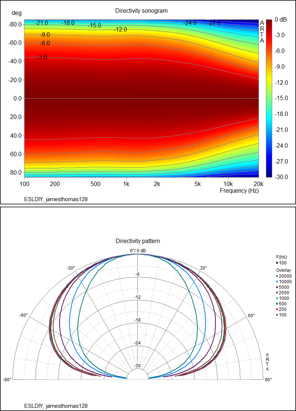

You still sounded a bit disappointed by the dispersion/polar response of your design. What exactly was your goal? The design you posted looks to have better dispersion than a 25mm tweeter. Remember you can always trade midband sensitivity for increased dispersion by increasing R values. Doubling the R values and you lose 3dB of midband sensitivity but move the knee of the directivity roll off up an octave. More details in the last paragraph of Section 2 of the paper. One other thing that may be confusing the directivity results for you is that the ESL is a dipole radiator so there is a cosine(off-axis angle) term that is not included in plots made from AES paper Equation 17/18.

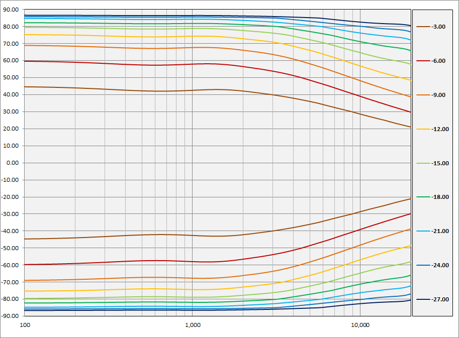

Just for fun, Attachment #2: is a contour plot of your design as calculated by my Excel spreadsheet.
The data can also be exported to ARTA for the much prettier plots shown in Attachment #3:
Look at that polar plot! That is one fat sweet spot with no off-axis lobing in sight. :up:

Actually I must say that my latest simulation was more than acceptable. It is difficult to find a good tweeter with a polar response like this. And, unlike a dynamic driver, I can change the dispersion to my liking by, as you said, sacrificing output. For now I'm going to use the resistor values from the latest simulation. I need to get these assembled to assess how much bias V and amp power I will need for my room. Then more tweaks will come I'm sure.
