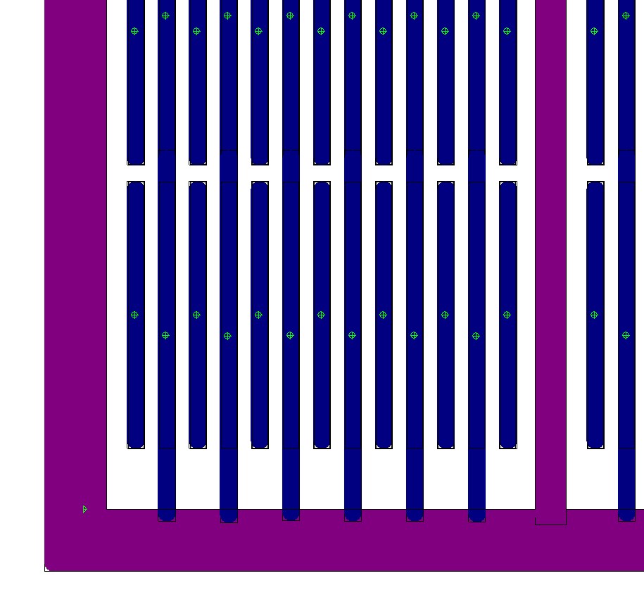

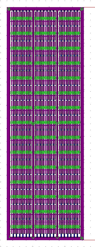

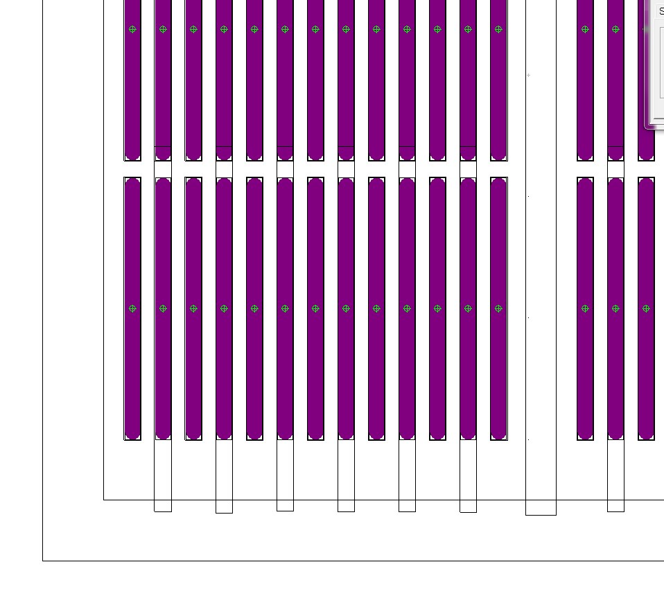

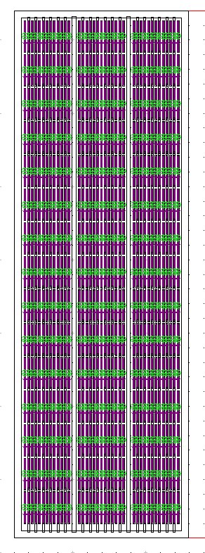

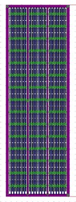

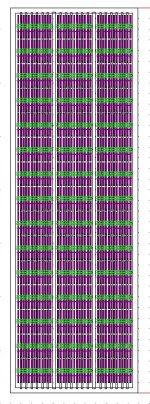

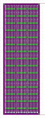

So I have completed my first draft stator diagram. My intention is to use 36x10.9375" panels with slots that are roughly 2"x.125". The slots are spaced apart by .125" in both the horizontal and vertical directions.

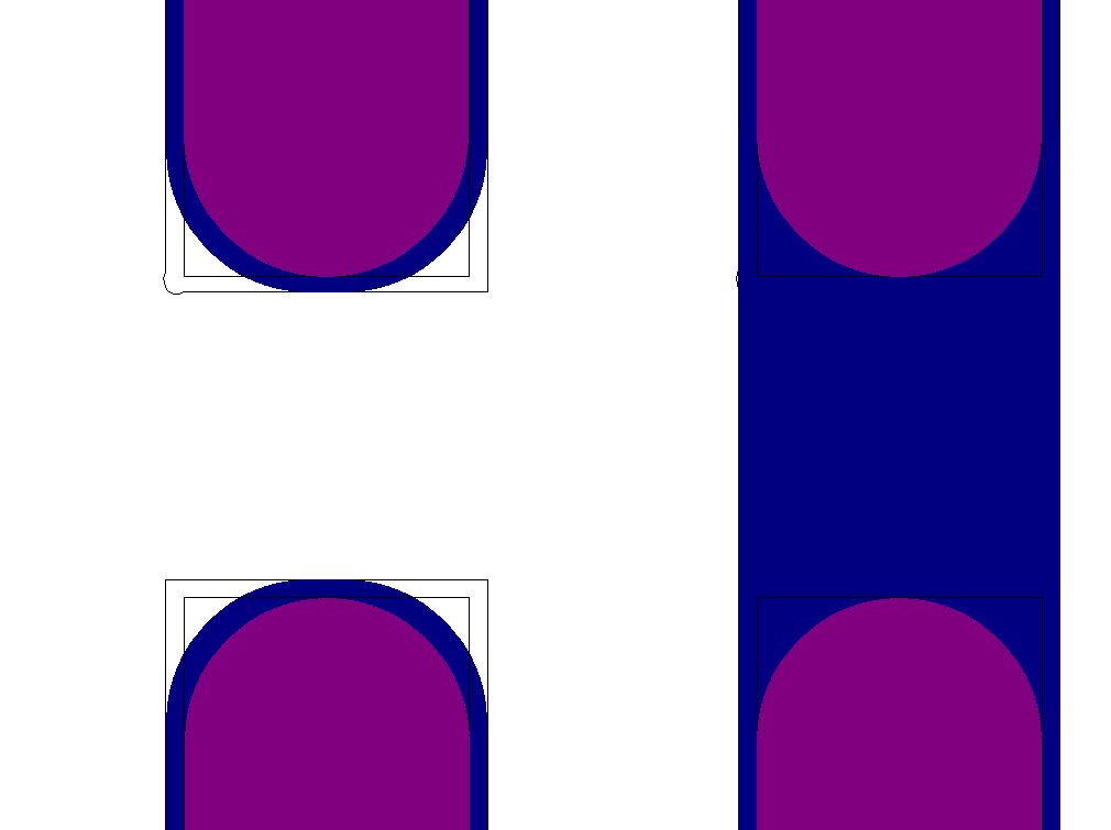

Each slot has a 0.2mm thick outline of removed Cu cladding. This is to help prevent arcing.

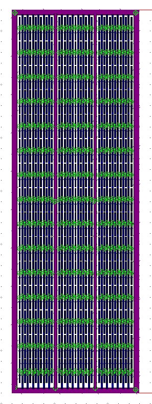

The entire panel is separated into 3 vertical sections of equal width (3.479") using spacers of 1/16" thick. These will then be broken into electrical segments (a total of 21). I also intend to use horizontal pieces of acrylic in the horizontal areas between the slots (they are of course 1/8" wide) for stiffness. The Cu cladding will of course be on the outside (coated with acrylic enamel), with the Garolite facing the diaphragm.
My issue is that my layout and spacing results in a D/S of 55.7. My intention was to run this panel down to 200-300 Hz. Is that D/S too low? I'm pretty sure that I'm stuck with the physical layout due to material size constraints, so my only recourse for changing the D/S is to increase the spacer thickness. I prefer to have an odd number of sections as I am using an odd number of evenly sized electrical segments. Could I get away with just one large section? My D/S would be 175, and the panel width be a full 10.9375". Any recommendations?
Also, any thoughts on the layout?

The inner segment looks to wide for my eyes.

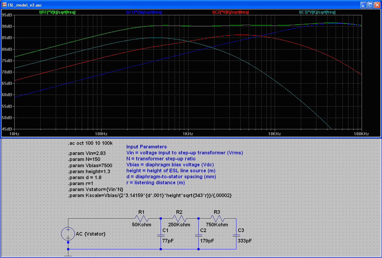

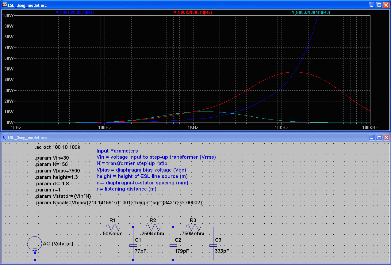

Out from a gut-feeling I'd choose a 4:1 relation between outer and inner segment -or not more than ~1 to 1.2" for the HF segment.

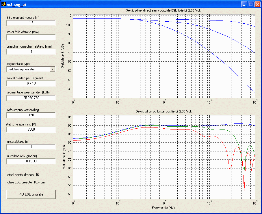

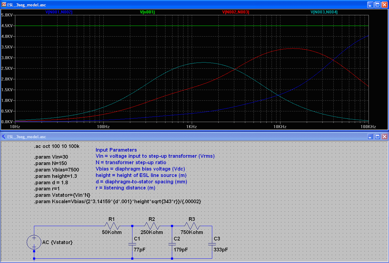

Xover resistors chosen as to give a xover point of ~3kHz.
Id also choose the base material to the outside, with standard FR4, of 1.6mm thickness.
There are laquers for PCB coating with a high viscosity that would't run into the hole/slot wands but rather sit ontop of the copper side with nicely rounded edges towards the hole/slot wands. The laquer beeing alot thinner than the FR4 base material, which increases the efficiency of the panel and which results in a very safe to touch panel.
I'd use only 'soft' spacers in vertical direction (tapes, 3M) and add only a few single silicon dots if required for dynamic membrane stability.
You certainly will need stiffening features, preferrably multiple streaks in horizontal direction, to achieve the required mechanical stiffness for the panel.

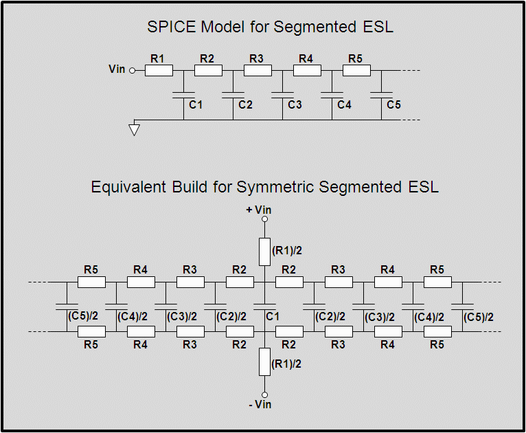

Hi jamesthomas 128
Your plans look good to me. I suspect Cal is overlooking the RC-transmission line connection of the 21 segments to equalise the line-source behaviour (??).
I presume that the Cu is one the outside faces of the stators, otherwise you'll have trouble soldering connections?
When you spray the acrylic laquer, multiple coats, spray from alternate directions to wet the inside edges of the slots, and quickly turn the PCB with the wet edge down wards at 45 degrees so that the laquer dries forming a radius over the Cu edge - its the radius of curvature that determines the breakdown voltage.
I believe that D/S is the common abbreviation for Diaphragm-to-Stator spacing.
In your case that would be 1/16", the thickness of your spacer.
The 55.7 factor you mention is the ratio = (unsupported width)/(D/S). Keeping this ratio < 100:1 is generally recquired to ensure diaphragm stability. Otherwise you may need to add some silicone or foam tape support "dots" along the centerline to keep the diaphragm from being sucked over to one of the stators when the HV bias supply is energized. A 175:1 ratio would without doubt require some stabilizing "dots" along the centerline.
You didn't mention what thickness diaphragm you planned to use, but if you use 6µm or thinner you should be able to achieve a diaphragm resonance ~100Hz with the 36" x 3.5" sections. This should work just fine with a crossover around 250Hz or higher.
As Calvin mentions, keeping the PCB flat can be a challenge. Limiting the unsupported width to 3.5" would certainly help this situation as well.
I have 6um mylar that I plan to coat with Licron for the diaphragm. I also have some elvamide that I was considering to try. Has anybody actually used it successfully? And, if so, is it any better than the Licron ESD? If not I would have a hard time justifying the extra work of applying it.
Thanks for all of the feedback gentlemen. I should get my PCB this week and I will test the machining.

I have an XLS spreadsheet that allows up to 10 segments of arbitrary segment size and ladder resistor value. However, it uses complex number math, so the Analysis Tool Pak is required. Were you ever able to get the Analysis Tool Pak working? I seem to recall you were having difficulty loading it.is there by any chance a XLS sheet that allows to enter the dimensions for each segment?
Other options to analyize arbitrary segmentation for line source ESLs:
1) use a SPICE model: (LTSpice is free)
When simulating line source ESL with SPICE, SPL is proportional to current:
Segment(dB) ∝ 20*LOG[(segment current) / sqrt(frequency)]
Total(dB) ∝ 20*LOG[(total current) / sqrt(frequency)]
http://www.diyaudio.com/forums/planars-exotics/48120-experiences-esl-directivity-9.html#post2218526
2) use the esl_seg_ui MATLAB GUI:
http://www.diyaudio.com/forums/plan...tor-esl-simulator-esl_seg_ui.html#post2908293
The Q results from the idea, that the segments may not be chosen equal.
As frequency drops linearly the required membrane area for constant output doesn´t increase linearly. With my older wire stator panels I used 3, resp. 5 sections. A thin middle section and 2 equal -but each 2 times larger than the foregoing section- sized outer sections.
For constant on-axis output from an ESL line source, the required membrane area increases by 1.414[ie sqrt(2)] for each halving of frequency. The RC transmission line with equal segment size and resistor values that golfnut analyzed in his AES paper provides this exact rate of area increase. This is also the most gradual rate of area increase possible for passive equalization, resulting in the best possible dispersion and smoothest trending off-axis response.
Using 3 segments of increasing area can provide a usefully flat response with reduced complexity. However the smoothness of the off-axis response is not as good as if a larger number of equal sized segments were used for the same total panel width. As with all things ESL...there are trade-offs.

Modeling Segmented ESLs with LTSpice
Here is a 3 segment example for modeling segmented ESLs with LTSpice; add as many sections as you like
The attached LT-Spice files(*.asc, *.plt) need the ".txt" suffix removed, to run.
For comparison with esl_seg_ui I used inputs posted by jeronimo83 for his 3 segment ESL.
http://www.diyaudio.com/forums/plan...r-esl-simulator-esl_seg_ui-6.html#post3516480
For convenience, I reposted the esl_seg_ui output here as Attachment #1.
Note that at the close 1m distance, the response below 100Hz starts to flatten out due to the proximity effect.
The LTSpice modeling does not include the proximity effect.
Attachment #2 shows the schematic of the segmented ESL to be modeled in LTSpice and the equivalent circuit for the common symmetrically built ESL.
Attachment #3 shows the LTSpice response plot, circuit, and input parameters. As mentioned in post#43, the total response is proportional to the total current(ie current thru R1)/sqrt(frequency). The response of an individual segment is proportional to the current thru the segment capacitance/sqrt(freqeuency). The plot shows output for each segment and the total.
A parameter input section is used to calculate a constant(K) to scale the currents so the plotted response level in dB corresponds with SPL levels predicted by the Walker Line source equation. The equation is derived in Section 3.3.11 of “Electrostatic Loudspeakers,” by P. J. Baxandall, Chapter 3 “Loudspeaker and Headphone Handbook, J. Borwick, Ed. The capacitance of each segment can be estimated based on the segment area and separation of the stators using the formula for a flat-plate capacitor.
If you are not interested in the absolute SPL level, you can ignore(or remove) the parameter inputs.
All that is required to plot relative response is the capacitance of each segment and the resistors connecting them.
Another thing that LTSpice modeling is handy for is determining voltage and power ratings for the ladder resistors. Attachment #4, 5 show the voltage and power requirements for the 3 resistors with a 30Vrms input. Since music is transitory by nature and HF content tends to be lower in amplitude, the power dissipation requirements are probably conservative. However, the voltage requirements are relevant as is.
I didn’t show it in this example, but it is quite easy to add the step-up transformer and its parasitics(leakage inductance, winding capacitance) to include its effects in the electrical response. Once the transformer is there, effect of damping resistors and crossovers parts can be modeled as well.
NOTE: There is no error checking to determine if:
1) bias and stator input voltages would cause arcing with the chosen diaphragm-to-stator spacing.
2) diaphragm excursion required for plotted SPL(dB) would cause diaphragm to hit the stators at lower frequencies.
