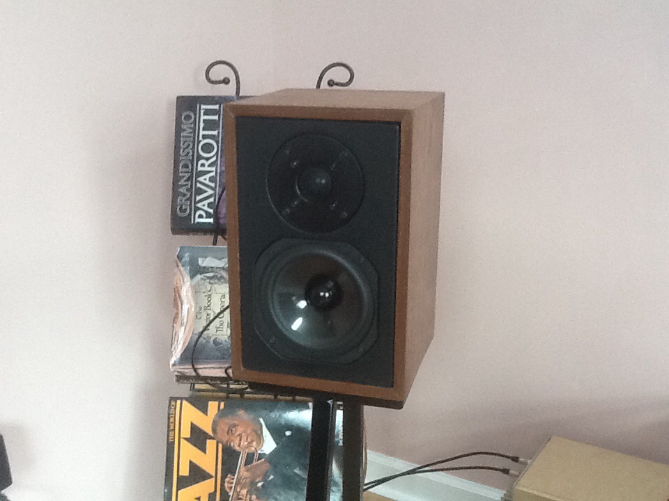

I built the Continuums a few months ago, mainly for a reference to compare to my other speaker builds that have been constructed over the last few years, including Frugalhorns, LXminhttp://986forum.com/forums/newreply.php?do=newreply&p=441993 clones, a couple of open baffle designs based loosely on Orion/Nao, Apogee TM ribbons with open baffle bass panels and a couple of stand mounted speakers, one with sloped baffle and one waveguide experiment. All except the Continuums use minidsp for crossover.
I have a small music room and all the speakers I have built suffer from mild to severe bass bloom except for the open baffle types. Hence, even with the Continuums, I use a minidsp to cut the bass emphasis and smooth out other room influenced anomalies. Consequently, they are very satisfying down to about 40hz.
I will probably build the mltl version of the Continuum sometime soon. My main pre/amp combination is a B4 buffer preamp(pinkfishmedia.com) and Symasym amplifier rated at somewhere between 50 and 100wpc.
I took the liberty of using solid walnut with 1" leather covered mdf baffle and a removable pack.

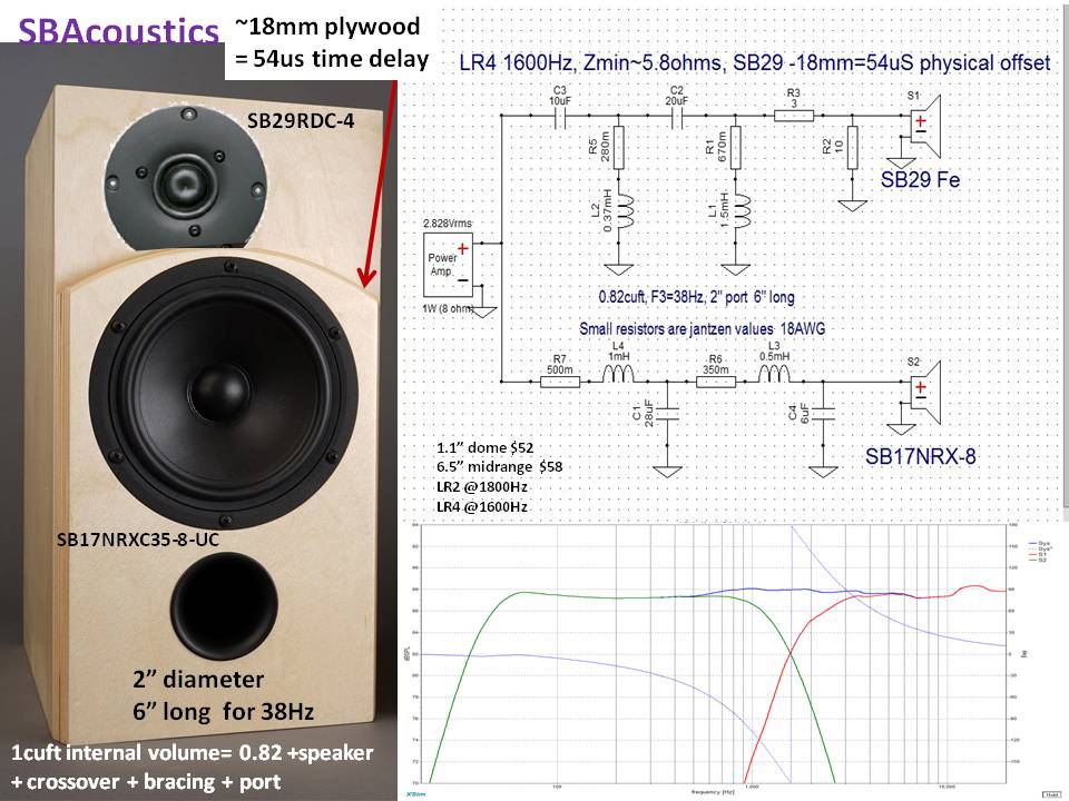

I just finished test cabinets for Mandolin. I am preparing to generate frd and zma files this weekend to build the crossover that suits me.
Could you post your frd and zma files?(in text?) I want to run them with an LR4 1600Hz crossover(attached) on a time-step baffle. My sims used measurements from a large baffle. The SB17NRXC35-8-UC shows a full/smooth 180-degree polar merge with the SB29RDC-4 dome tweeter with this crossover design.
Some fun for us.... Maybe helpful for musicgeek to get comfortable with Xsim crossover tweeks for his room.
I'm at work now but as soon as i get home i'll post them here. I'm using SB29RDC-C0004 (as suggested in Mandolin kit). Tweeter is not flush with baffle in my test cabinets so i shouldn't post measurements for it now - it does not do them justice. I can upload tweeter .frd when i get finished cabinets (built by my friend). If you insist i can upload tweeter .frd as is and combined (midbass and tweeter) response in order for you to determine the acoustic offset between them and then use your own frequency measurements of tweeter so you could simulate the xover properly.
All measurements are done at about 1m distance, mic on tweeter axis. It is quite similar to what Troels measured here:
http://www.troelsgravesen.dk/SBA-61-NRXC/red-600-SB17NRXC_0.25mtfb_-30.2.gif

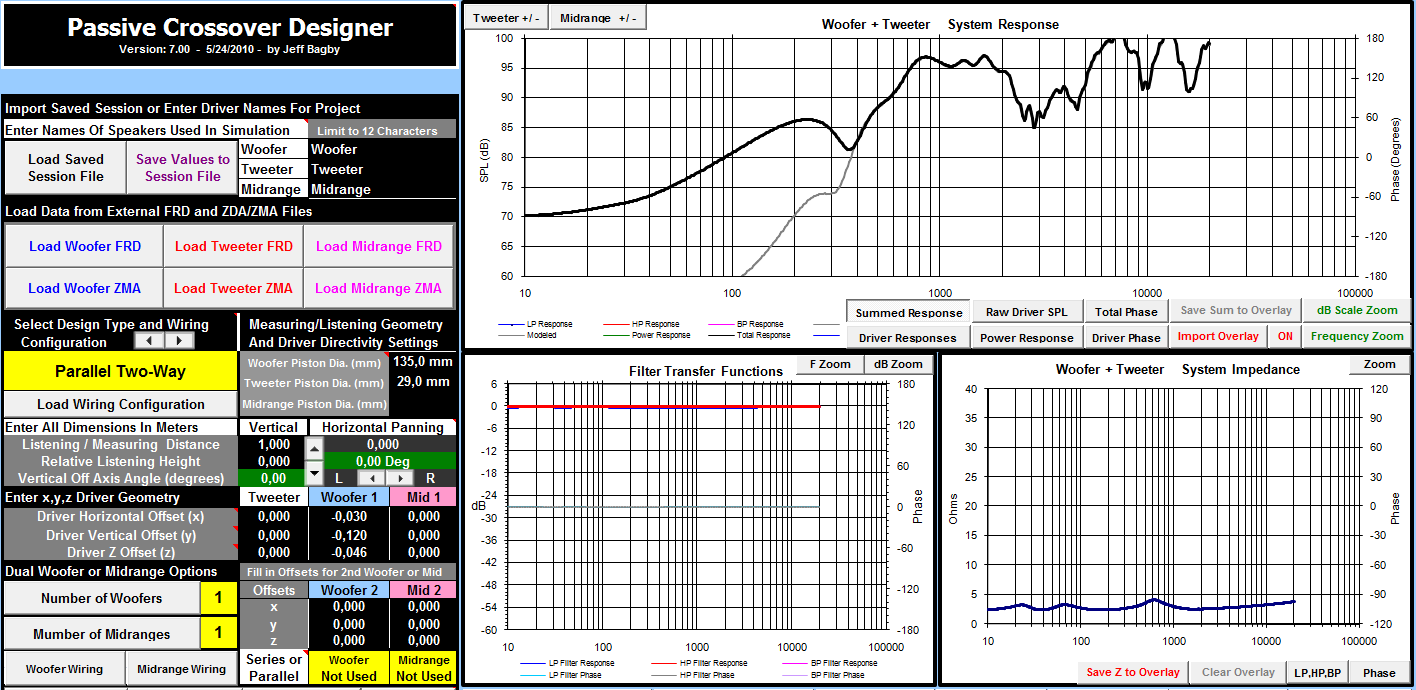

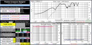

I am posting HOLM measurement files for bass, tweeter and bass+tweeter combined frequency response in the .zip file. Just open it in HOLMimpulse if you want to work with it. Then there are .txt files that are scaled. Only thing you should do is change extension into .frd and PCD and other programs can use it for xover modelling. It is gated at about 280Hz - give or take a Hz.
Again, tweeter measuremens are looking bad because they are not mounted as they should be. When i flush them into the front baffle it will measure much better.
.zma files i will post later. I have some guests arriving and i can't find .zma files on my computer right now.
Image with offsets is uploaded too.

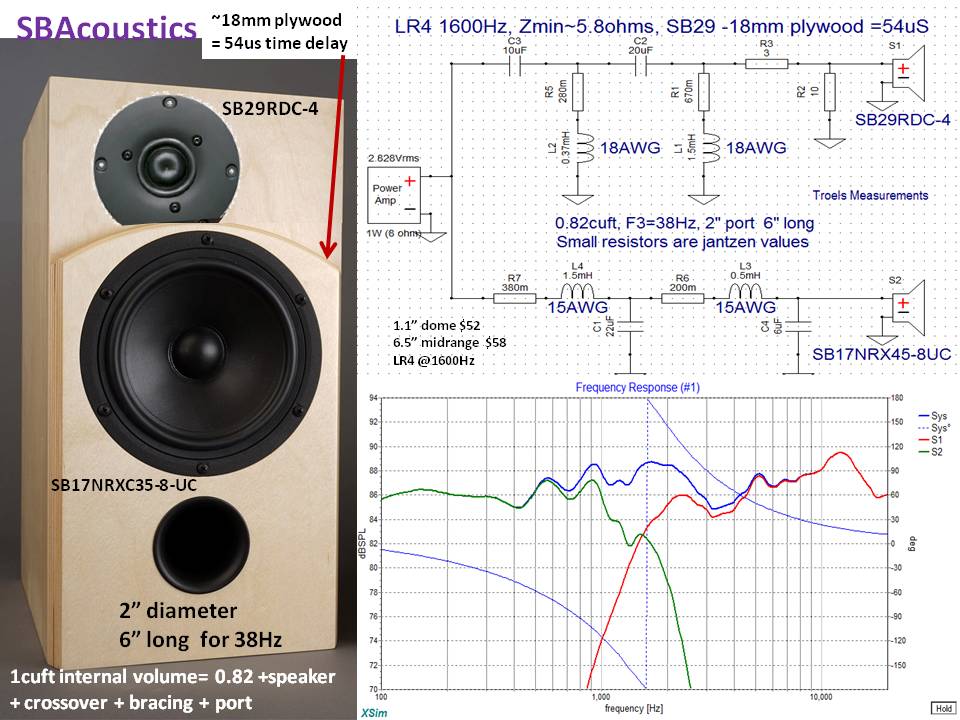

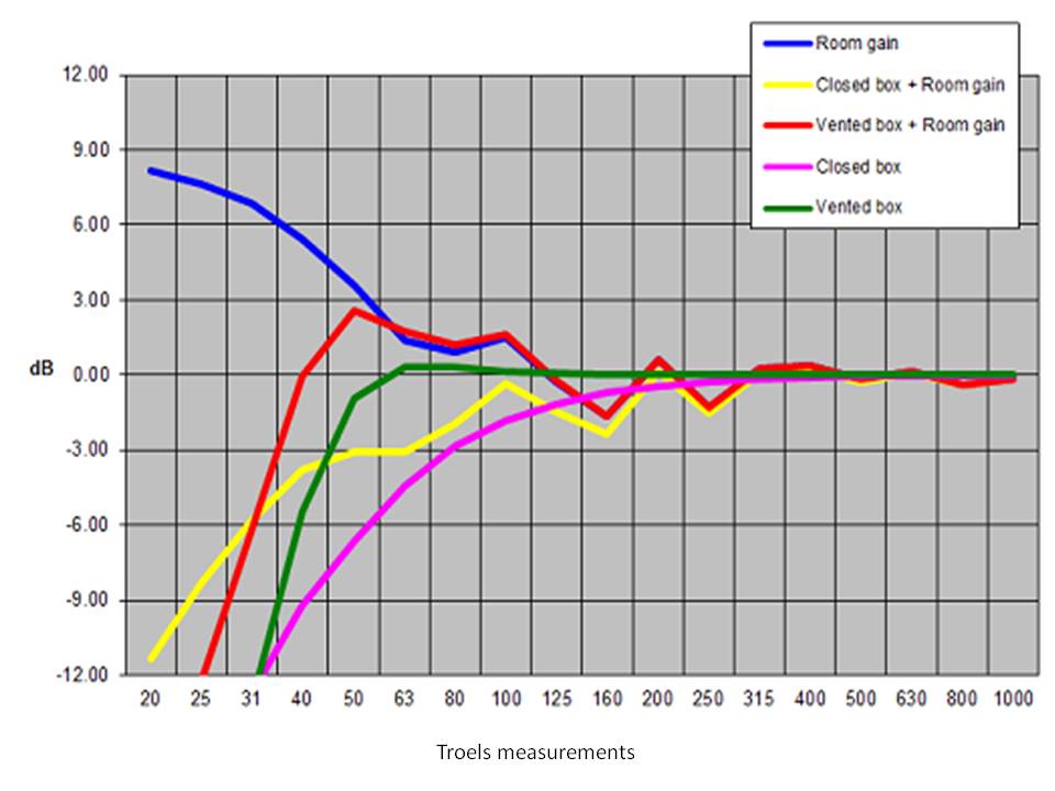

Last OT on "SB17 + SB29 drivers" 2-way.
Thank you for posting your SBAcoustics measurements. Since they are similar to Troels small box 2-way posted data, your measurement methods are very good. I used Troels in-box data to built this Xsim crossover. L4 and C1 required change from my earlier design to cover the smaller baffle SPL effects.

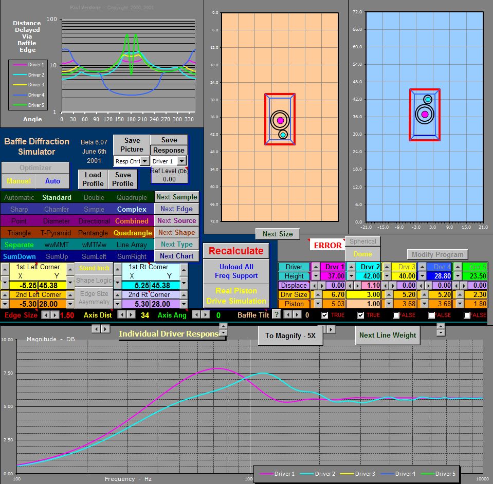

The original baffle simulation I used shows the general SPL shape changes as the drivers are moved around the baffle. Move the tweeter: offcenter; nearer to the top; over-lapping the midbass; physical time align to midbass; etc... This allows early compensation of the large-baffle SPL measurements from datasheets and BOXSIM before a cabinet is constructed. Only accurate measurements like yours will capture the small details.
The speaker's crossover design should take SOME baffle step into account, but using amplifier tone controls or equalizer function is the best way to manage room gain. No tone controls in your amplifier gain chain? There are passive $10-$20 kits on eBay as well as Baxandall type diy-schematics.
