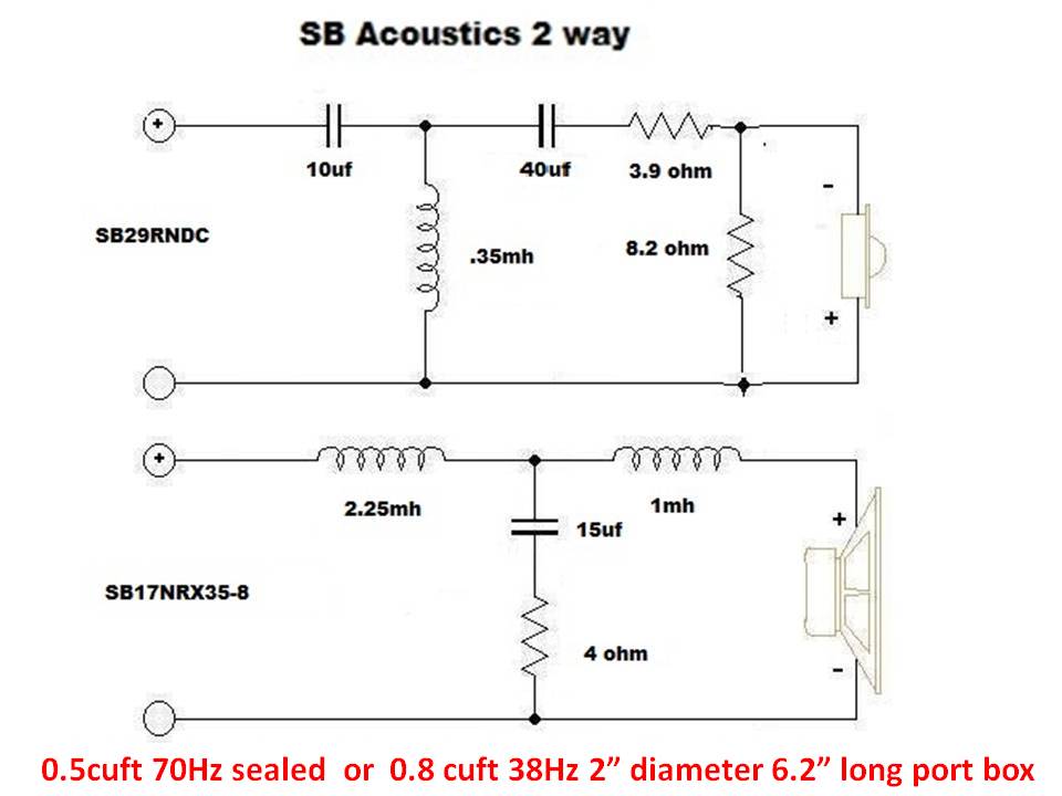

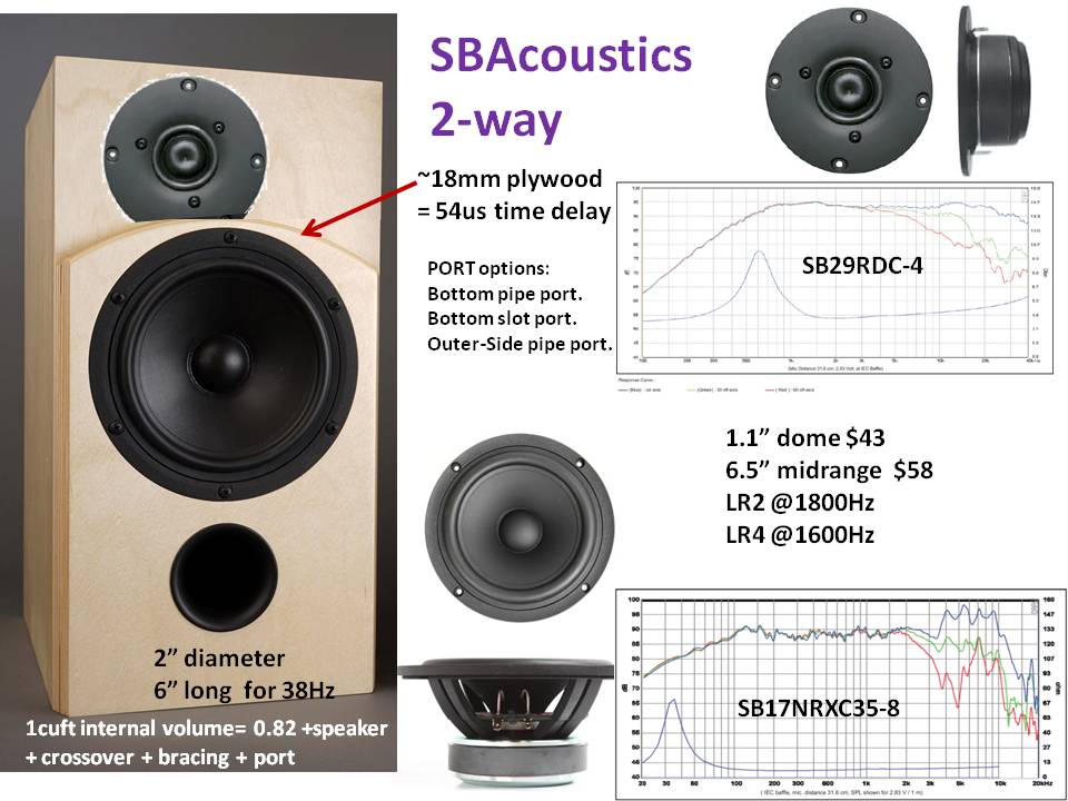

Jeff Bagby Mandolin speakers are a noticable step up. The SB17NRXC has a very low inductance motor which smooths the high frequency crossover region. The soft dome has good HiFreq extension with a resonant-free gentle roll-off.
If you download specs on the two SBAcoustics drivers you will buy the Mandolin. There are also diyAudio threads on 3-way designs which add 8" or 10" woofers to these drivers to leave some dreams ahead. Parts Express often has sales on good pre-built cabinets...just route the baffle.
$350 - $375
The kit features drivers from SB Acoustics. Please click the pdf link below to read Jeff's design process and overall description.

If you want to use this first build for some education on crossover circuits and cabinet construction, you could purchase the speakers from Madisound for ~$220/pair +ship, and start with a standard crossover topology which you could simulate with free Xsim, and gradually "tweek" to match your ears, cabinet, and room. Xover parts ~$80/pair + ship. After a few Xsim runs, you will be able to select useful extra R-L-C parts to add to your order for experiments.
There are MLTL cabinet designs for the SB17NRXC-8, as well as 3-ways from adding either the 8" SB23NRX45-8 or 10" SB29NRX75-6. A well designed 3-way will always sound better than a 2-way MLTL, because the midrange can now use a superior transient sealed box without large Xmax low freqs.
SB29RDC, Ring Tweeter ~$52 Madisound
SB17NRXC-8-UC, 6.5" Mid Bass - $58 Madisound
Highest quality/$ that I could find.
