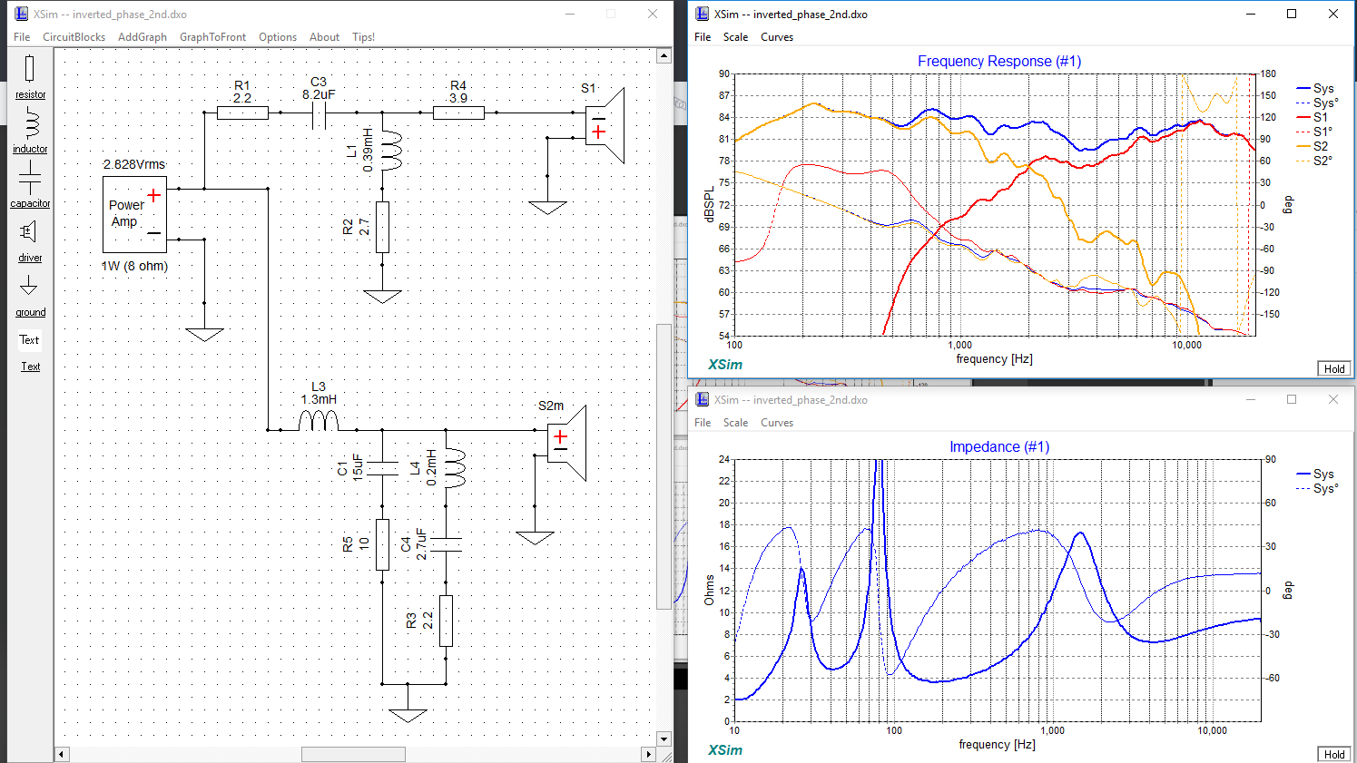

With a true 1st order Butterworth, assuming the drivers contribute zero acoustic roll-off and no phase shifts on their own, wouldn't the tweeter and the midrange be 90 degrees out of phase at the crossover point? If so what is the point of time alignment? (Except to offset the drivers to exactly cancel out the said 90 degree phase shift, but then it would have been phase alignment not time alignment.)
I have always thought that, conceptually, only even-order (2nd, 4th) crossovers (total electrical+acoustic) can be time-aligned. Correct me if my concept is wrong.
A perfect acoustic odd order Butterworth has 90° phase offset an any frequency, not just at the XO point (where of course it is most important). And to get there you must have no additional phase shift coming from time-of-flight offsets.
Butterworth is intended to be used with a proper M-T-M D'Appolito config or a coaxial, with M-T you'd need their vertical spacing to be closer than what can be practically realized.
Even order XO (Linkwitz-Riley) has constant zero inter-driver phase offset and again you must avoid additional time-of-flight or the main beam won't be on-axis.
Often, some time-of-flight induced phase skewing can be mitigated by adjusting frequencies and sharpness of the transition "knee" with little effect on the summed flatness and lobing.
OTOH, phase contribution from the drivers themselves can be dealt with the same procedure plus intentional time-of-flight differences to get a practical XO, it's all about the right compromises you gotta choose.

I've measured the power response dip mid to woofer with LR4 crossover, I can't hear it though.
The difference is just the icing on the cake. It is subtle but worthwhile on a speaker carefully designed for directivity, to introduce a phase difference in the crossover region if required. As KSTR says, the measurements and subsequent calculations are considerable, but IMO a necessary part of a complete crossover.
Just an observation here: in almost every plot in this thread the drivers are not very well time/phase aligned. If you are going to the trouble of using an all-pass filter you should be able to do a lot better than 30degrees misalignment. Even without one, you should be able to fudge the crossover points (use asymmetric XO filter freqs), filter Qs, and filter orders to give you something that sums close to flat and also gives zero-degrees phase alignment at the XO frequency. An allpass just helps you maintain phase alignment over a wider range of frequencies. The phase alignment doesn't matter nearly as much far away from the XO point as the contribution from one driver totally dominates the response. First and second order filters are tricky to get right because they demand that the phase still be aligned further from the XO point as it takes longer for the drivers to rolloff.
The problem with designing a speaker with non-zero phase alignment (such 90deg for odd order filters) is that the frequency response varies more rapidly as you move off axis. I.e. you change from a sitting to standing position and get blasted with +3dB at the XO, or you sit too low/close and a deep null appears. If you design for perfect phase alignment you'll find that the speakers will be much more enjoyable to listen to because they won't demand a 'head in a vice' listening position - you can move around and they still maintain a flat response.
The plot in #43 is actually quite good I would say.
At least we have symmetric lobing and at no angle the response is louder than on-axis. With large vertical offset the first nulls may be located at rather narrow angles, though.
Lobing is cause by physical displacement, not phase differences.
Time alignment (=physical displacement) and phase shift are one and the same thing. Phase shift is just frequency dependant time shift and vice versa.
If you design for 0deg phase difference between the drivers in the listening axis then as you move off axis in either direction you only get a mild null. At some angle off axis you achieve 90deg phase misalignment equalling -3dB system response and moving even further off axis 180deg misalignment giving a deep null. Hopefully if you designed things right by choosing appropriately sized drivers and crossover points only impractical listening positions will achieve a serious null or lobing (multiple nulls).
Starting at non-zero phase alignment in the design axis handicaps the off axis response because the same amount of change in phase (or displacement since they are proportional) equals a much larger change in amplitude. Going from 0deg to 45deg gives -0.7dB. The same 45deg shift but from 90deg to 135deg gives -5.3dB. You will also sooner reach 180deg in such a system giving a deep null.
Going from 90deg alignment back to 0deg (moving off axis in the other direction in a system designed for 90deg alignment) gives +3dB which is subjectively more noticeable than -3dB.
