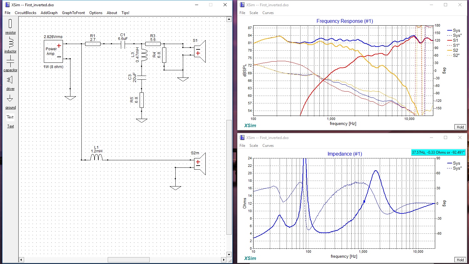

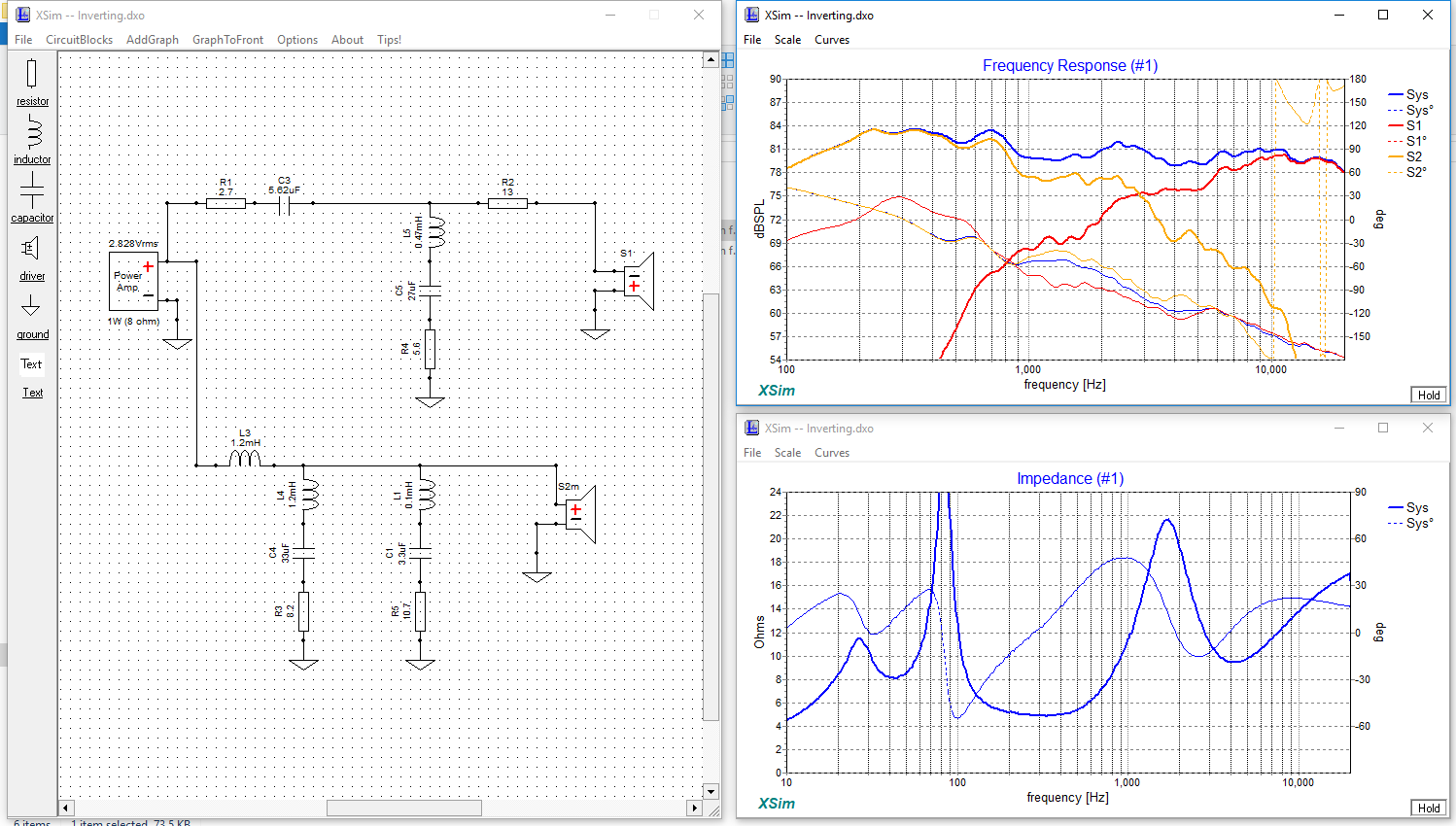

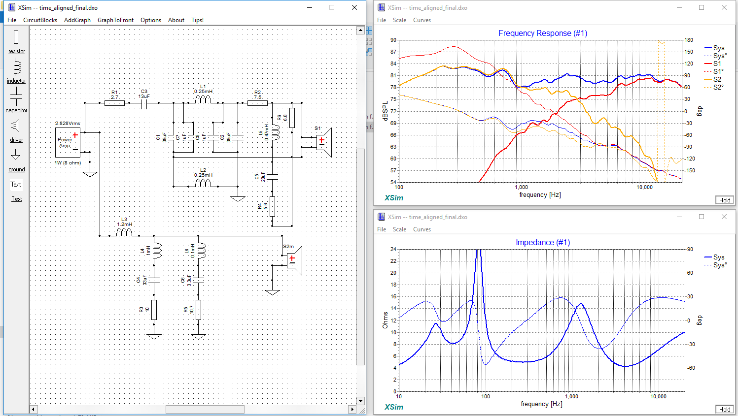

I've have made two separate first xover versions to see there is any difference. One is fist order but the tweeter is inverted. The other is tweeter and and woofer are both in-phase using a all phase delay network. Both xover are very similar and the only difference is the series capacitor on the tweeter.
The drivers are SBA Satori TW29RN-B and Scanspeak 15W/4531G.
After listening both versions here are my impressions.
For the inverted version, there is a transparency due a much simpler signal path. The sound is a bit more immediate and the vocal seems a bit closer to the listener. On the time-aligned version, there is a slight veil on the very top end. I mean the signal has to travel through the delay network with all the inductor and capacitor component so it's reasonable to expect there is some loss in the signal rise time. So in term transparency, the advantage is the simpler inverted xover version.
Now in term of soundstage reproduction, the advantage is the time-alinged version. The time aligned has a more palpable and 3D presentation. There is a track where the bass is sort of bouncing left and right and even behind the listener. On the inverted over, the bass is mostly at the front and within the speaker boundary or just slightly to the left and right of the speakers. But on the time-aligned version I could hear the bass effect from the left to the right wall and even behind me. Another example, on Pink Floyd Wish you were here album, at the beginning of the second track Welcome to the machine, there is a sound affect that sounds like pressurized door opening from the right side of the soundstage, on the time-aligned version, the sound comes from right at the right wall, but on the inverted version, the sound is about halfway from the left speaker to the wall. Overall, the time-aligned has a more three dimensional soundstage at the expense of transparency. At almost every track, on the time aligned version, the sound just extends more to the left and right of the speakers, and there is a cohesion that not heard in the inverted xover version.
My observation is consistent with John Atkinson observation (although I don't remember the link) in which he said everything being equal, the time-aligned speakers have an edge over soundstage reproduction. That is what I heard.
So I guess what is the verdict? I am not sure there is a clear winner. Each has its own strength and weakness. But what if I could purchase the best capacitors for the delay network? I think the time-aligned version has a higher ceiling potential that is you can get more out of it with expensive caps, where is the inverted version is limited by the physics.

Thats not the case in yours. The slightest amplitude variation >0.5dB is more audible than the phase. Also in analogue circuit you can create distortion. Additional influence.
An allpass can only delay lows further than it already is without. So its not actually a time correction. It can only allow with given baffle delay to have the XO frequencies of both drivers in-phase in steady state. The overall group-delay though only worsened.
So, youre comparing apples and pers here. I recommend you to focus on flat amplitude on- and off-axis, forget the phase. Maybe consider distortion vs filter-steepness.
Groupdelay (if u dont build crazy 4-5way passive 8th order frankenstein circuit) is rather a cherry on the cake, only being properly solved by FIR, nothing else.
Did you just model them, oder did you also measure the actual result of your builds? Also, I would suggest to also look at results in the time domain, not only in terms of frequency response. Comparing the time domain measurements (step response) with your subjective results might be interesting.

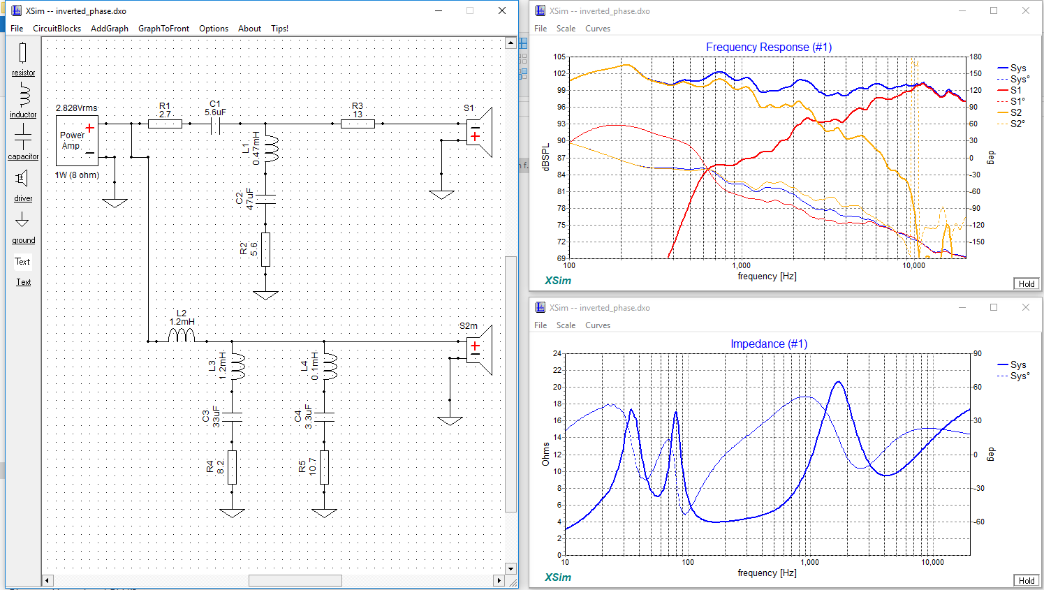

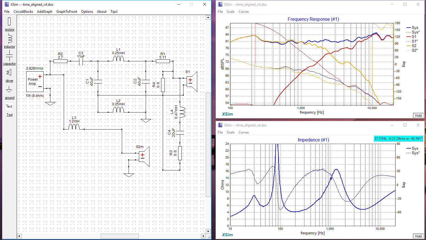

So this is like inverted phase vs. time aligned #2. The woofer this time is Seas Nextel 5in. Same tweeter. To be honest may be I can bs my way through this post but this time I can't say the "time aligned" version is better. It's like comparing Ms. Upton in the morning vs. in the evening and not like vs. some other gal. Maybe the inverted phase is morning Upton and the time aligned is evening Upton.
Maybe the "time aligned" version has a more organic soundstage but maybe it's just me.

Hi Andy2, I think your impression of the sounds of both crossovers are normal and well expected. I believe that in both crossovers I will prefer the inverted versions...
But the critical point from your experiment is the mentioned subjective quality of the "time-aligned" version. I believe it is not the "time-aligned" character that you heard.
To test this, here is what you can do:
Build a normal NON-INVERTED tweeter crossover. Then create your "time-aligned" version using the delay network and compare.

Andy, your speaker is NOT 1st order. Look closely at the roll-off slopes of both the woofer and tweeter. The woofer rolloff is 12 dB/octave, which makes it a second order. The tweeter rolloff is 1st order making it an asymmetrical crossover network. Not sure how your delay network work to make them "time aligned". In crossover design, you must consider the equivalent circuits of the drivers. They are part of your crossover and it is an unavoidable fact. Using a single crossover component in the woofer path usually results in a 2nd order rolloff.
With a 2-way system, you will need a RLC tanking network to tame the woofer break-up around 4.5 KHz. I can see that the woofer breakup bump caused a broadband drop in the upper midrange in the reverse polarity version. It can give a completely different impression of the system and has nothing to do with "time alignment".
Looking at the phase response curves of the 2 systems, the first one with the reversed driver connection actually has less less phase variation, but a much more rugged frequency response due to the woofer breakup. It may be partially due to its much higher crossover point (compared to the 2nd system).
