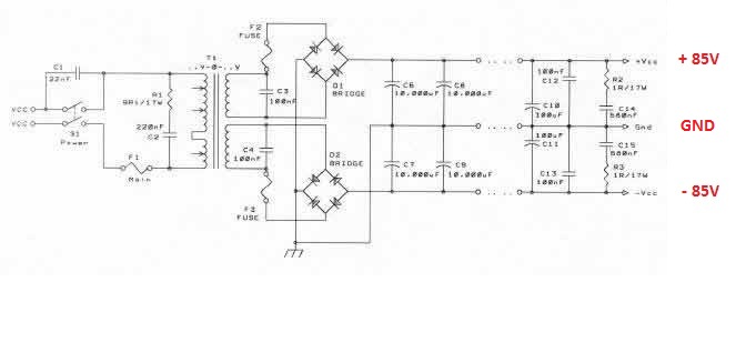

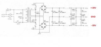

Can you confirm if the FO 1.4L amplifier modules in full balanced stereo configuration would be the same as the drawing in post #95.
Would 85v be ok?
Also -neg not connected due to it being internally connected to ground ?

It is 45 v on the drawing and 85 v is way too much .LC or any one else can you please answer my question

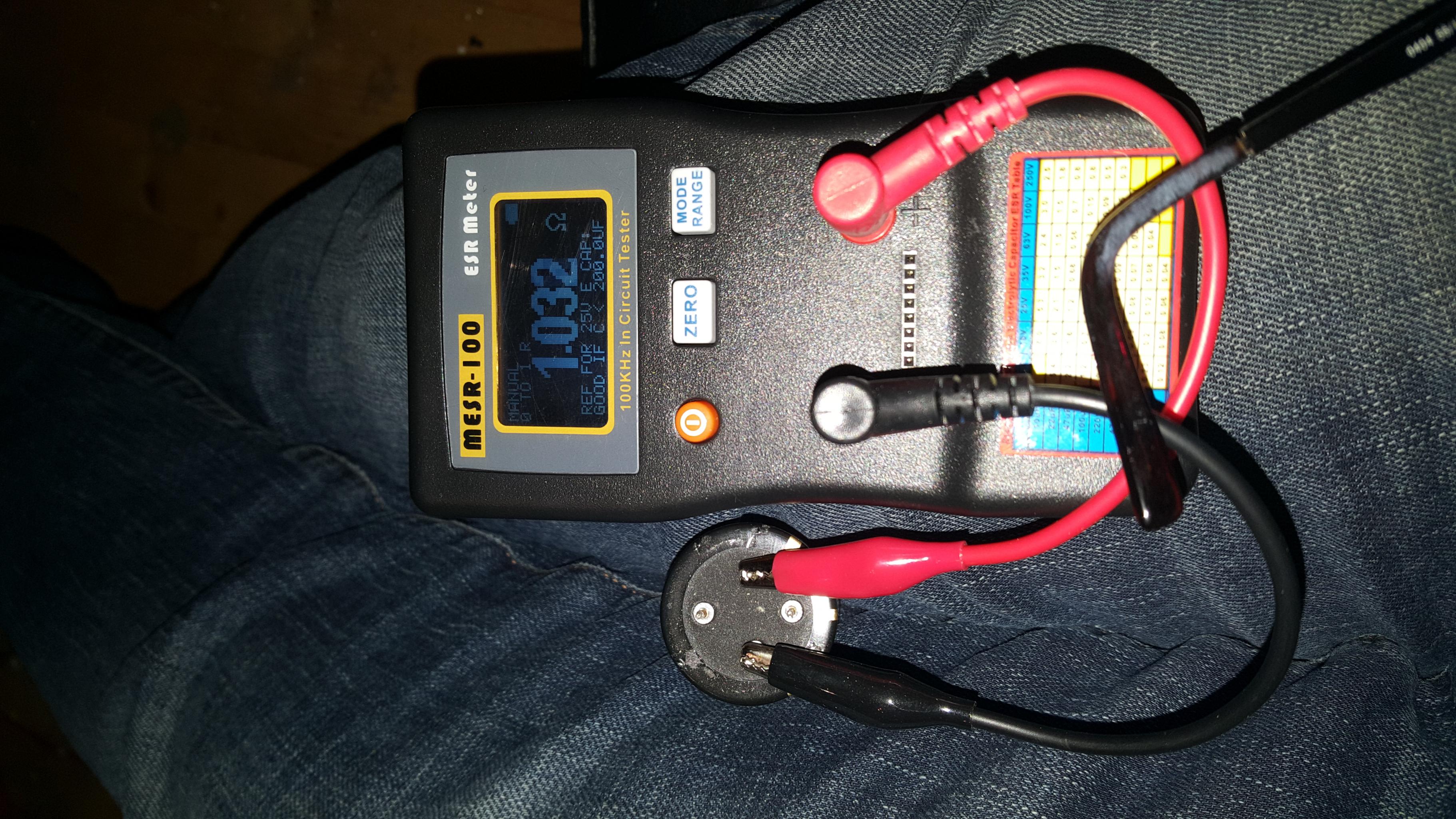

Measure ripple current and ESR at 100/120 Hz and compare to the others..

85 V from + to - or from + to GND or from GND to - or ...? Why 85 V? Do the math +/- 85 V would bring 2800 W rms/4 Ohm and that would vaporize the modules.
If you don't want to burn the modules do exactly what sch is telling you. I can not explain sch if you do not understand basics. Everything is marked and specified on the sch, why change it?

Here is a power supply for 1.4L.
Based on this thread and to be in safe zone, maximum voltage for 1.4L can be +/- 85V.

On first page is mentioned very clear:
Supply voltage for 1.4 L................................... +/-45 to +/-85 V.
Also you have (for reference only) ,previous post of mine, a complete power supply.
I would go for double mono configuration.
Shottky fast rectifiers,two x 1KW power transformers (custom made for very low noise) and 2 x 100 000 uf/100V,follow by 2 x 100uf/250V and snubbers.
At this moment you can begin measurements of the low ripple at the power supply.

+/-55 V is absolute max. voltage for bridging FO L modules. Output power is proper to voltage square function, so it rises exponentially, meaning at +/-55 V PSU there will be (voltage drop on power devices subtracted) 90 Vp on 4 Ohm load and that is a lot (1012 W rms/4 Ohm). SOAR of output devices should be strictly respected, not to mention thermal considerations with heatsinking, etc. All in all take great care at amp bridging.Lazy cat,
The sch was for “Medium” modules.
What voltage do you recommend if using “Large” modules ?
I’m surprised that you recommend same voltage for ”Medium” and “Large” modules
