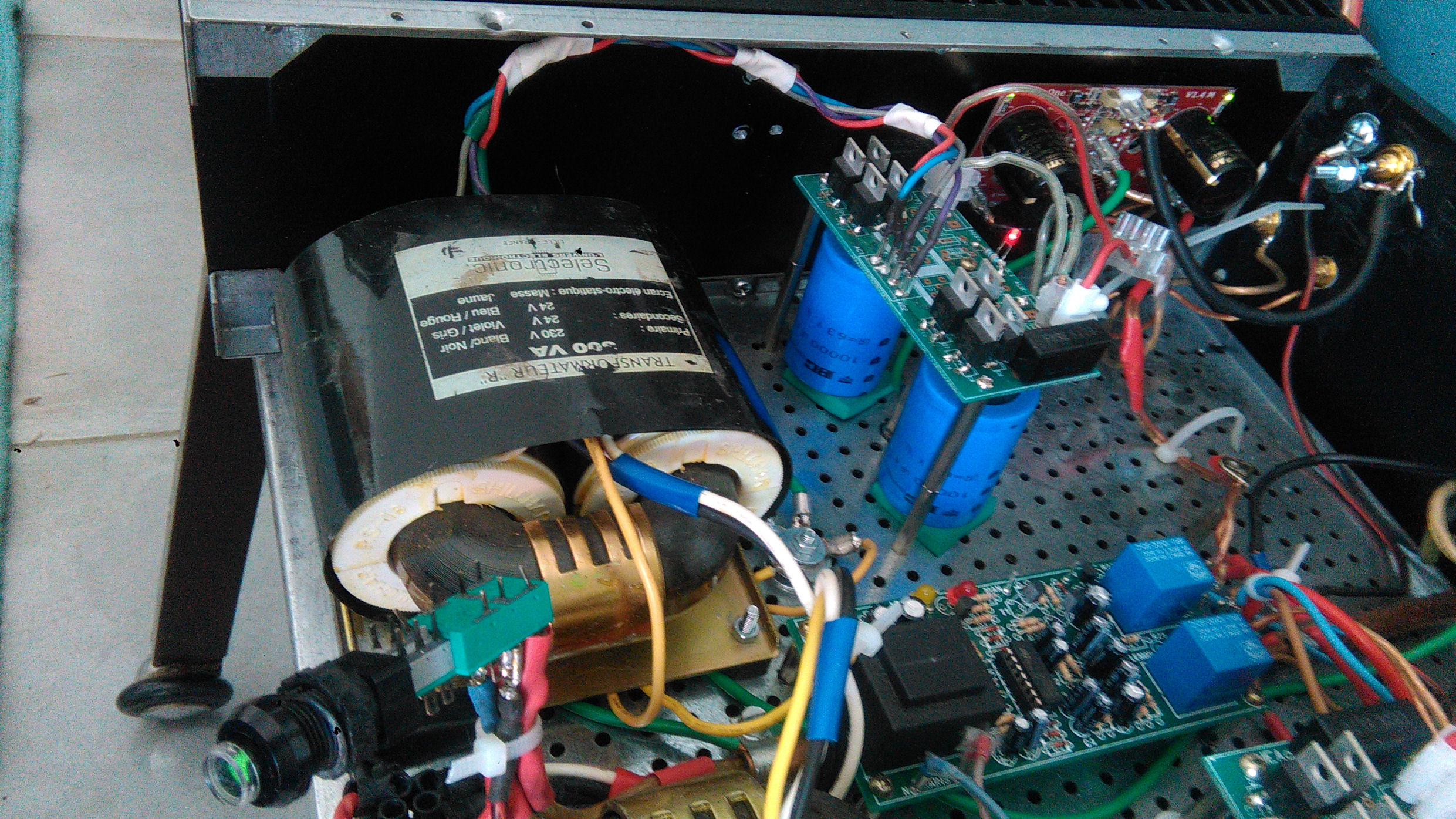

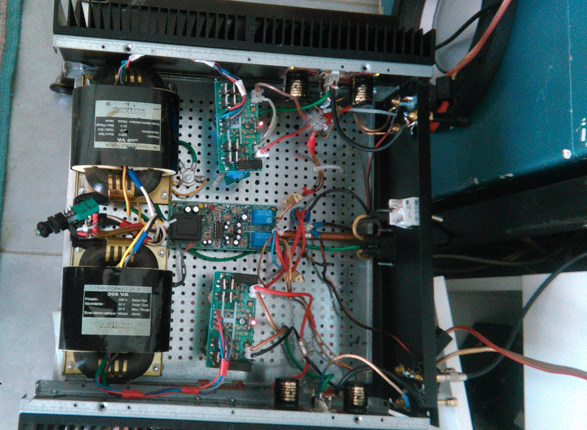

Hi !
I finally found time to finish installing my 1.4M modules in my (not so) old chassis (Hifi 2000 2U 400mm, previously used with LM3886 modules).
Dual mono PSU, with 2 300VA 2x24V transfos.
Sound wise : huge improvement in the low medium and bass range.
40°C on the radiators.
The case is still open, and a couple of pictures .........
Very thankful for these excellent modules - and their very reasonable price.
J-M

Hi JM,
good to see another FO 'in the box' !
on your pictures, it seems you use a spealer protection which is on a single board in the midle of the case, right ?
correct me if I m wrong but I think this board is connected on both GND of each side ... therefor removing the main benfit of dual supply which is to separates ground till the original RCA socket say in the DAC...
doing so reduce damping, signal/noise, create some hum (even if you dont hear it it will modulate the signal and create IMD) and finally impact cross talk.
I recomend 2 separated speaker protection, in order to avoid the internal gnd connection.
cheers / enjoy the FO sound !
