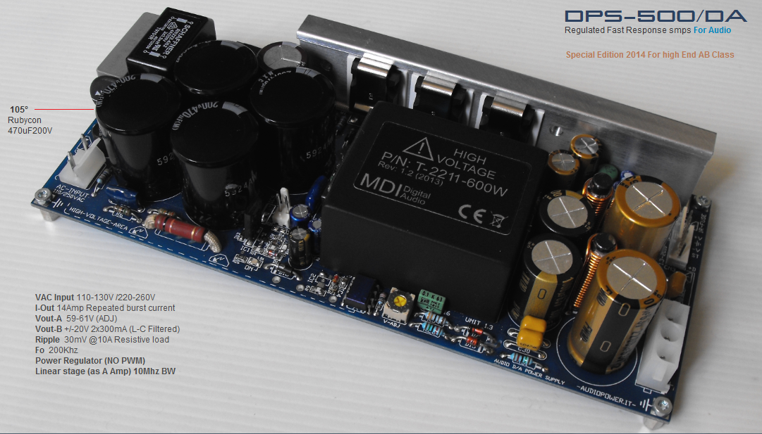

Hello Andrey , I am sending two of these in the photos.
Sorry if I insist with the DA version. is perfect for your amp. Considering that you have to use 2 (one for each amp), the power is oversized in the right way, this is something that I have tested long and well.
if you start with 61V (59-61 ADJ), you can see a drop of just 300mV-500mV on 4R.
2xDPS-500S is very expensive, considering two units also, the choice is not justified by the current demand of your First One.
I hope you show the FFT of your First One also by DPS-500/DA
Regards

Wov, it looks nice
I am only not sure about Nichicon KGs and Muse at secondary capacitor circuit. These capacitors are charged at high speed with almost right angle voltage steps. That means these capacitors should be low ESR (I doubt this about KGs) and high realiability due constant stress...that mean I (personally) would rather see here Nichicon KX (smps audio), Mundorfs or Panasonic EE...FC...FR on this position. What do you think about this?
Also...how is softstart figurated here? NTK in series?

You are right in part, if we refer to a traditional smps unreg / reg.Wov, it looks nice
The problem must be seen with the frequency of the load ( not the frequency of the switch ) . In this particular case, the ripple amplitude under load is very small thanks to the two feedback (one per side ) and the speed of response of the error amplifier . In fact , when I replaced it with 2200uF muses, I had to change the values in the feedback loop ( sensing is connected directly to the output connector ) .
In simple words , if the energy is constant on the capacitor , ESR = 0. DPS -500 in this variation is very small, for this reason I do not need low ESR , as I do not need large capacity .
Yes , inrush current is accettable with simple epcos THR , this is due to the low capacity utilization of the main filter ( only 470uF total) .. yes .. it seems impossible
whereas others have 1000/2000uF . con very poor PF in this case also.
We can also see only the voltage and current if we want, but this smps , has other important features .
EMI / RFI AC Line induction/conduction & ambient.
Regulation from Ac Line
Regulation Vs. load
Power Factory near to 1

OK, so that's why they are different, I was wondering ... will compare both of them and report soon.Actually they are not identical, one is equipped with heatsink, the other one with heatslug and the secondary side capacitors are 1000uF 80V on one board and 560uF 100V low ESR on the other board, so the optimum configuration can be tested.
