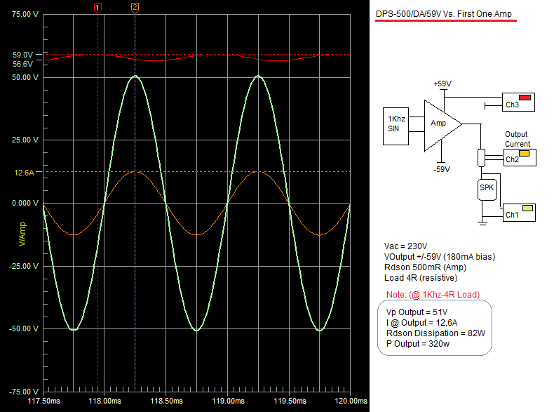

Good Morning Amateurs,
Just for curiosity, since I posted the same measure with the DPS-500 / S.
Now equally at 4R but with DPS-500/DA. (new release of DPS-600 as Owen thread measures).
Yes, I know that I insist with the DPS-500/DA, but I have good reason (aside from you can save 100 € approximately) same PCB, same components, except the power-units, compared with the "S" version.
Depends on usage at home, can be a good choice.
The strong point remains the transient response, and the purity of the output voltage, with the lowest (not usual) low EMI / RFI, not possible with traditional smps using a PWM as regulation.
Wow!!..today I have time for DPS-500 thread :)

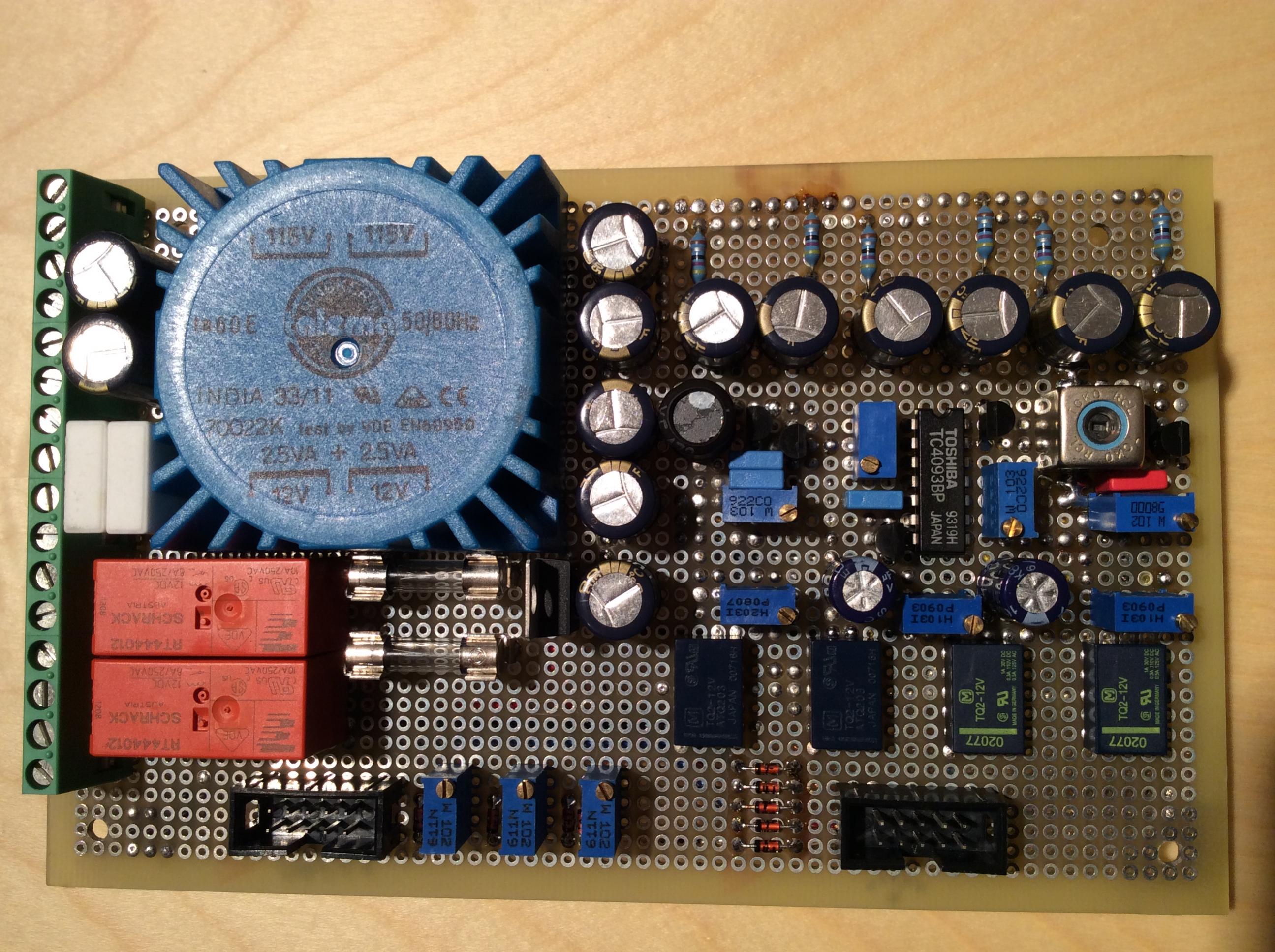

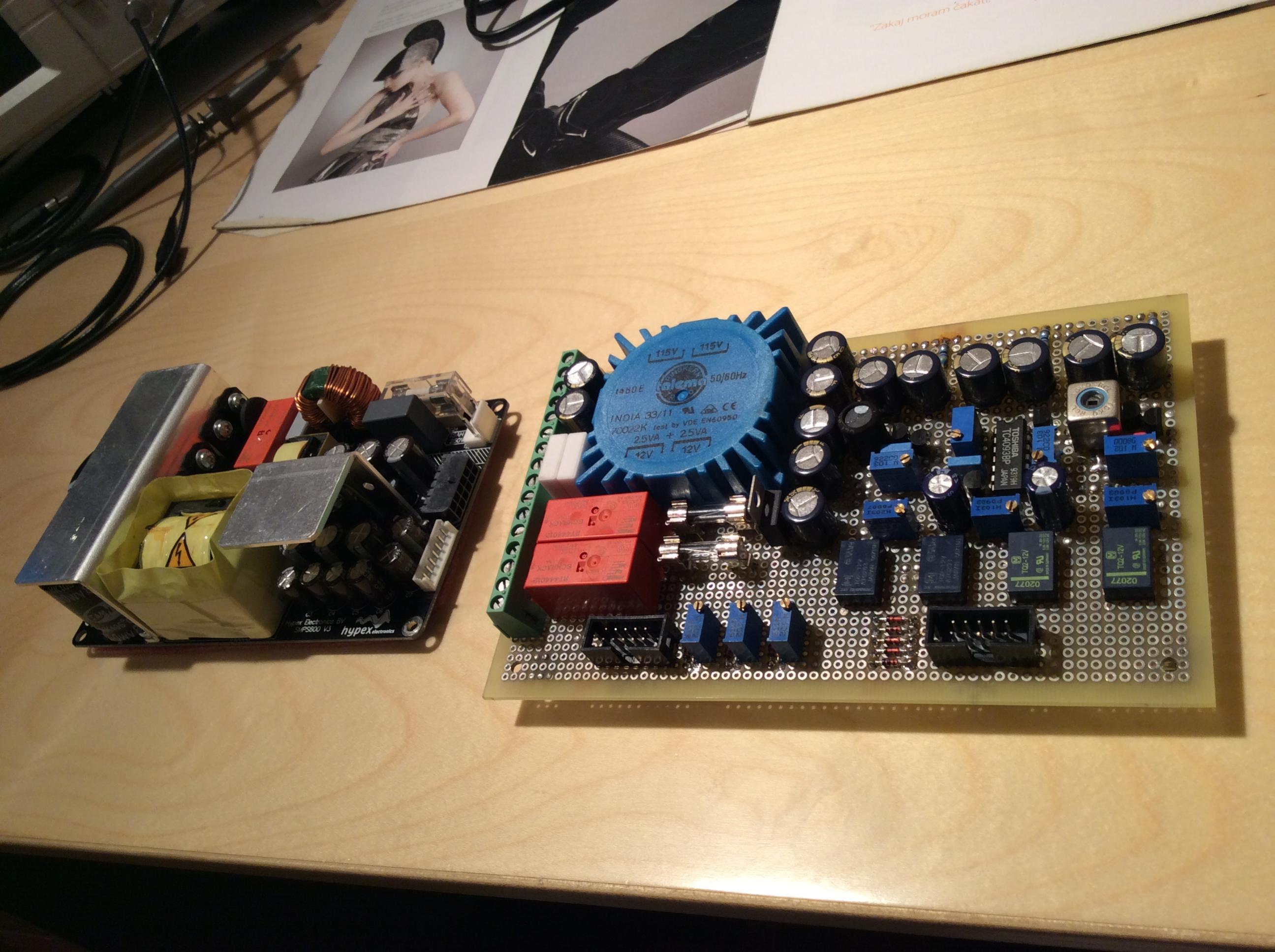

I was about to comment several times that your workstation looks very different from mine...much cleaner :D
Best wishes for your project.
M.
Doing it slowly since it's proto PCB, nevertheless its functionality is still perfect. Measuring station module will measure all necessary values, generate three function signals, safely start up the procedure, includes all current and over/under voltage protections, discharge First One after calibration and testing, etc.
i wonder why SMPS600 is there :D
Inside measuring station I need +/-63 V to supply DUT (device under test) which is happen to be First One module. :D
