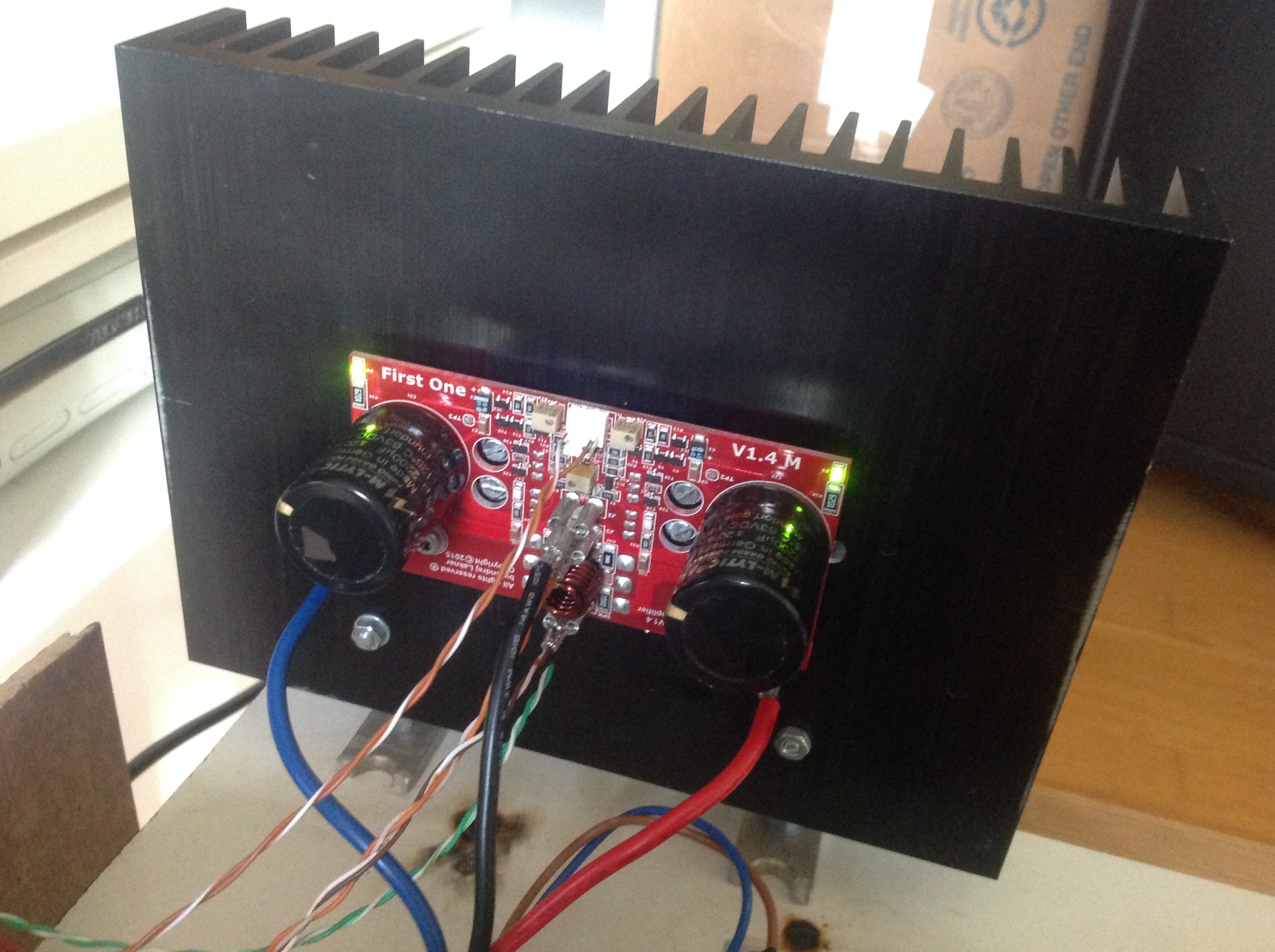

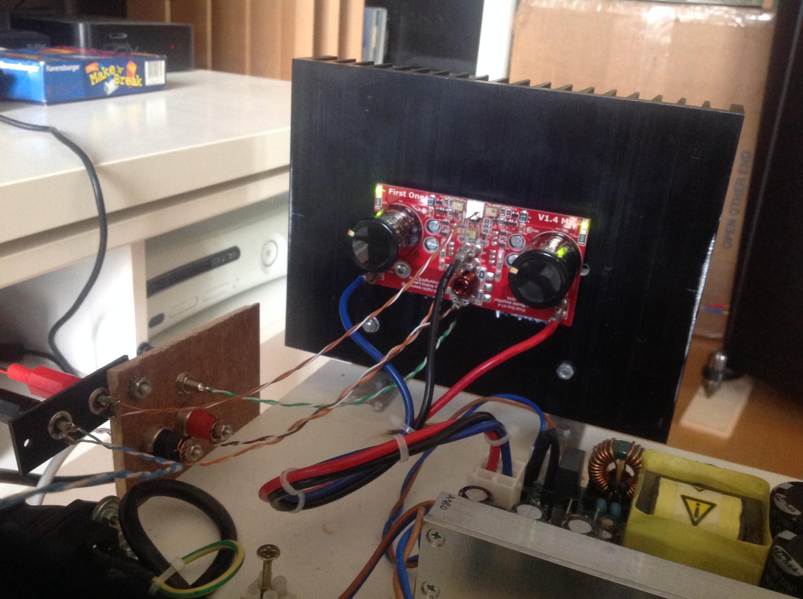

LC popped by yesterday with the finalized version of the First one 1.4. Mine version works on 43 Volt version of the hypex power supply. It serves as a testbed for the VSSA replacement, the First One S.
While waiting for the propper enclosure (Black mamba with VU meters) I have it setup the same as the last years 1.2. On the board with the heatsinks.
What can I say about the sound. So far complete neutrality. It keeps composure of the recording no matter what. The way it drives my Thiel speakers in the bass department is ... just have to listen and verify for yourself.

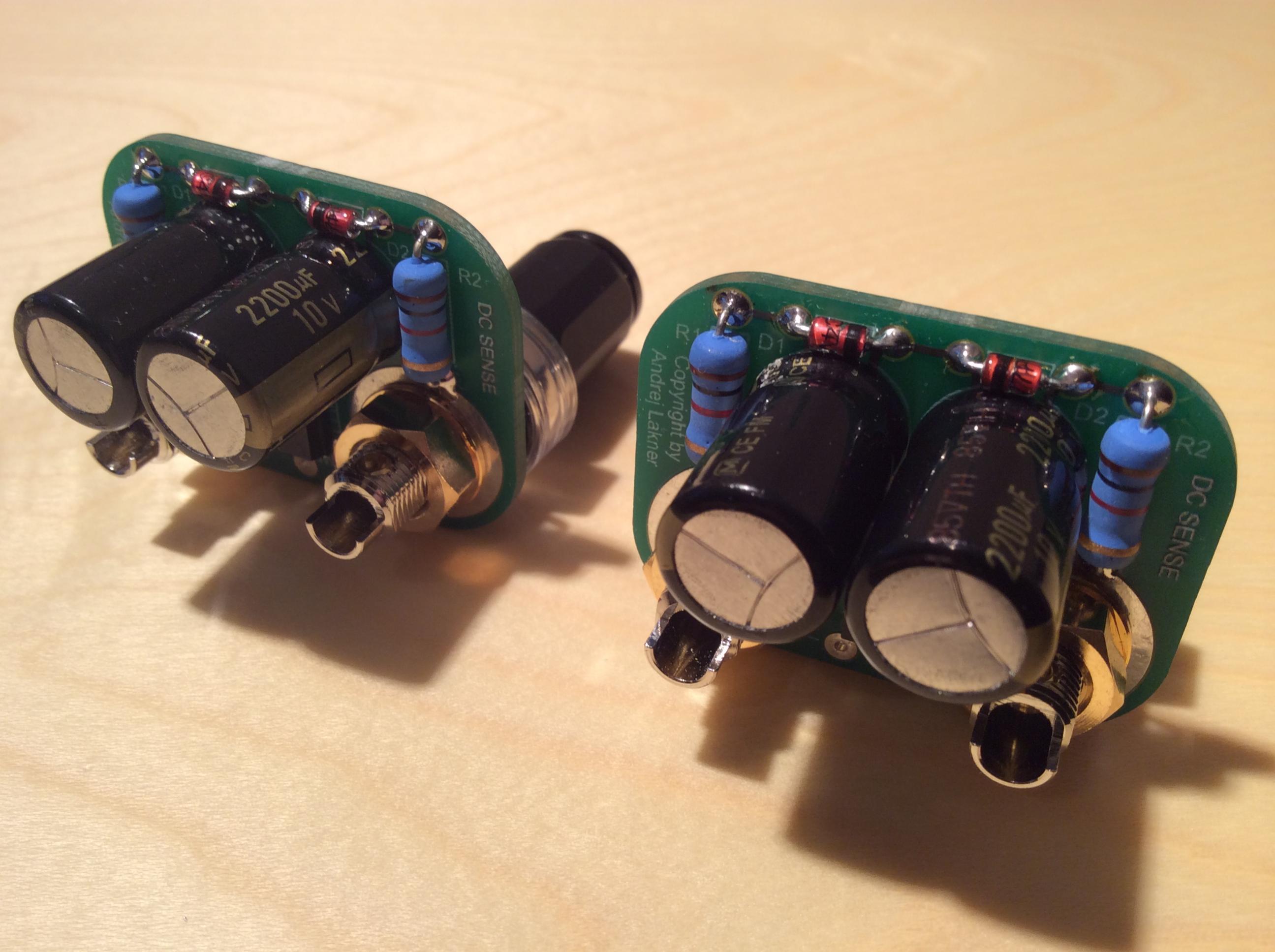

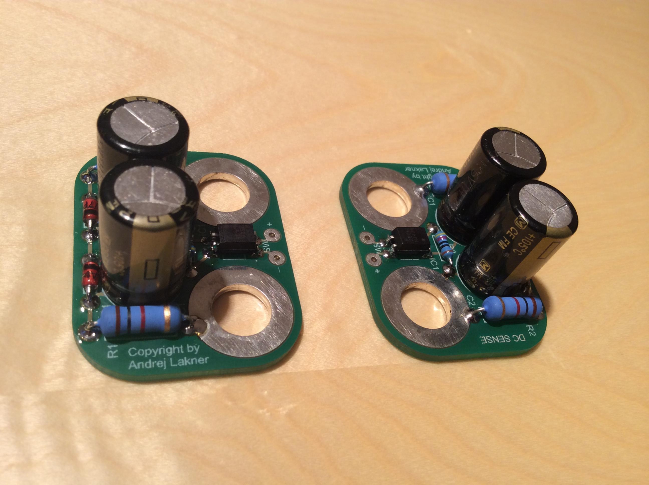

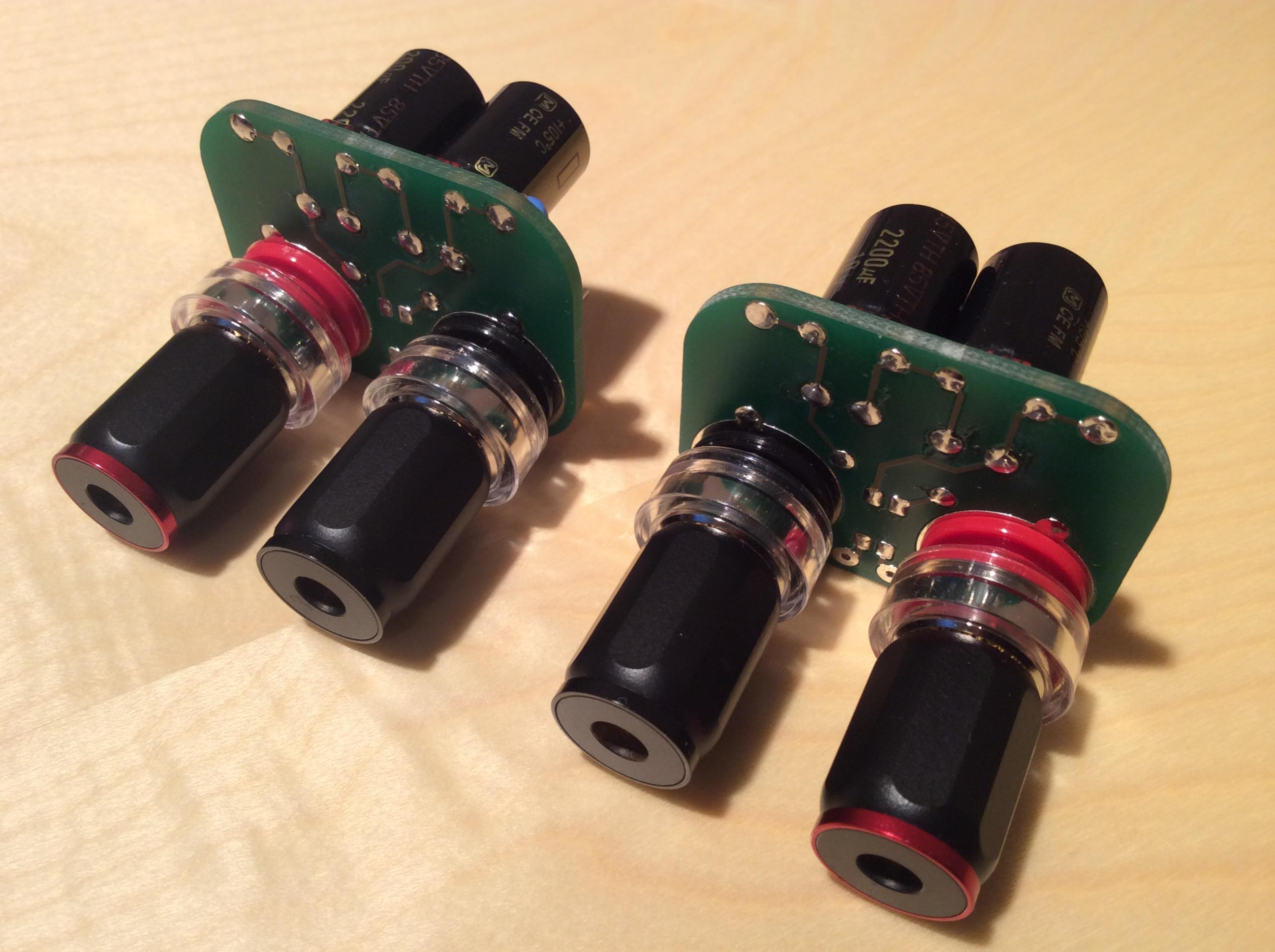

DC sense is a passive DC detector PCB located at speaker's terminals, connected to SMPS1200. In a case of DC failure it shutsdown SMPS preventing speakers from disastrous moments.
