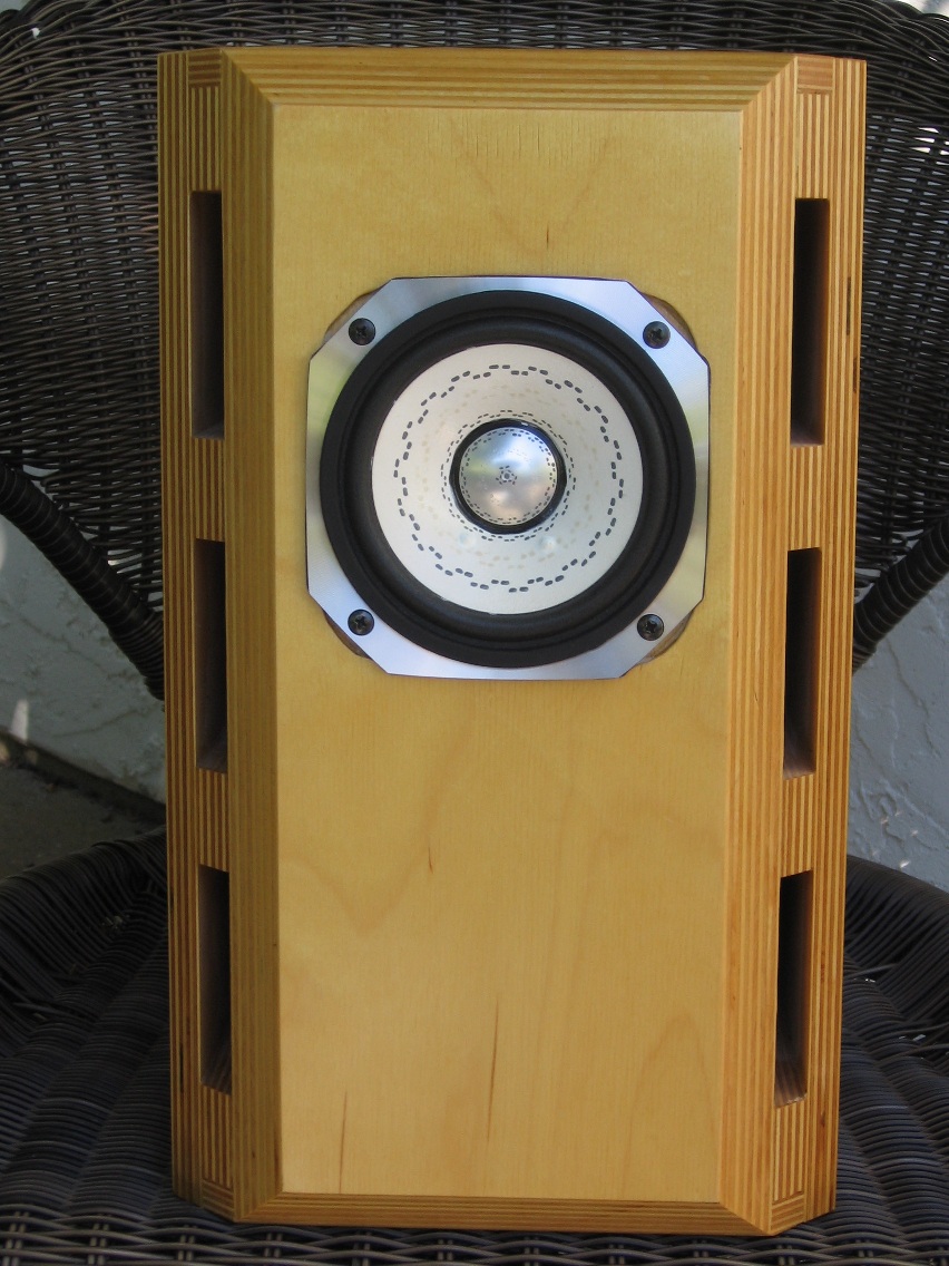

Jeff (vinylkid) can attest to this driver's performance in a slightly retuned version of this one:
I am sure that vinylkid58 (is that right Jeff?) can add specifically to this regarding the FX120 drivers in the "Fonken" enclosures
They're awesome.
No retuning, a completely independent design based on the p10 miniOnken principals.
While not entirely successful for the FE127, the larger Vb, vent area & volume is better suited to the FX120. Looking at your latest trapezoid designs, I may have to copy you again.

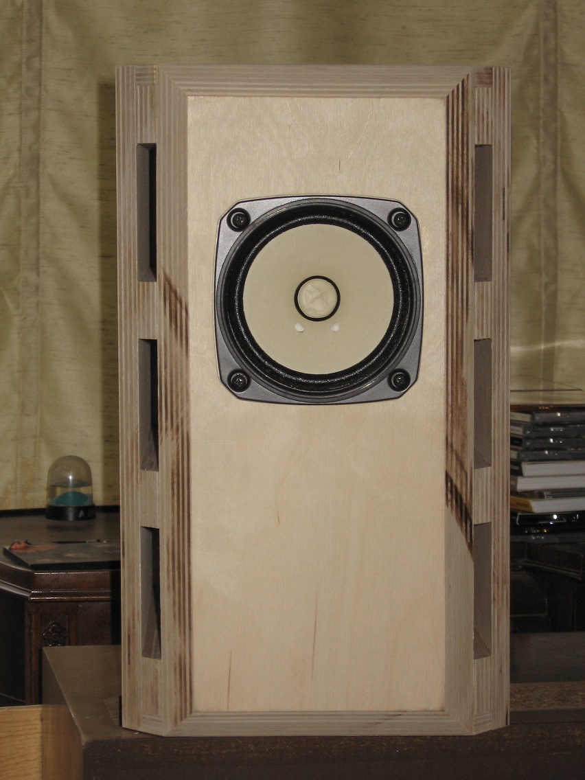

hey shifty/vinyl/Geoff, maybe you wanna share the sketches for your version?
It's a little on the large size to post (830k pdf). How about an original pic complete with burn marks.

at least a photo with the subject FX120 - or maybe your ex-GF Alex stole those?

That’s a pretty good job actually, just stopped too soon. Glue up some extra long sanding blocks and sand the heck out of it.

If you PM me your email address, I'll send you the drawings.
Here's a more recent pic.

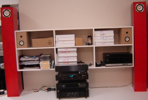

A fellow stopped into the studio today, he heard the red towers, he was like whatttttt…. I think he wants to see about a full range pair, but the $125 price tag would be too high.
The bass is nice; you may have noticed that I pushed the right side into the corner - tight. I did reconnect the BSC.
Also, the mock up pairs are gone ~ wheelie bin.
*For those who followed this DIY project the lower chambers are not being used, I’ll get back to that someday.

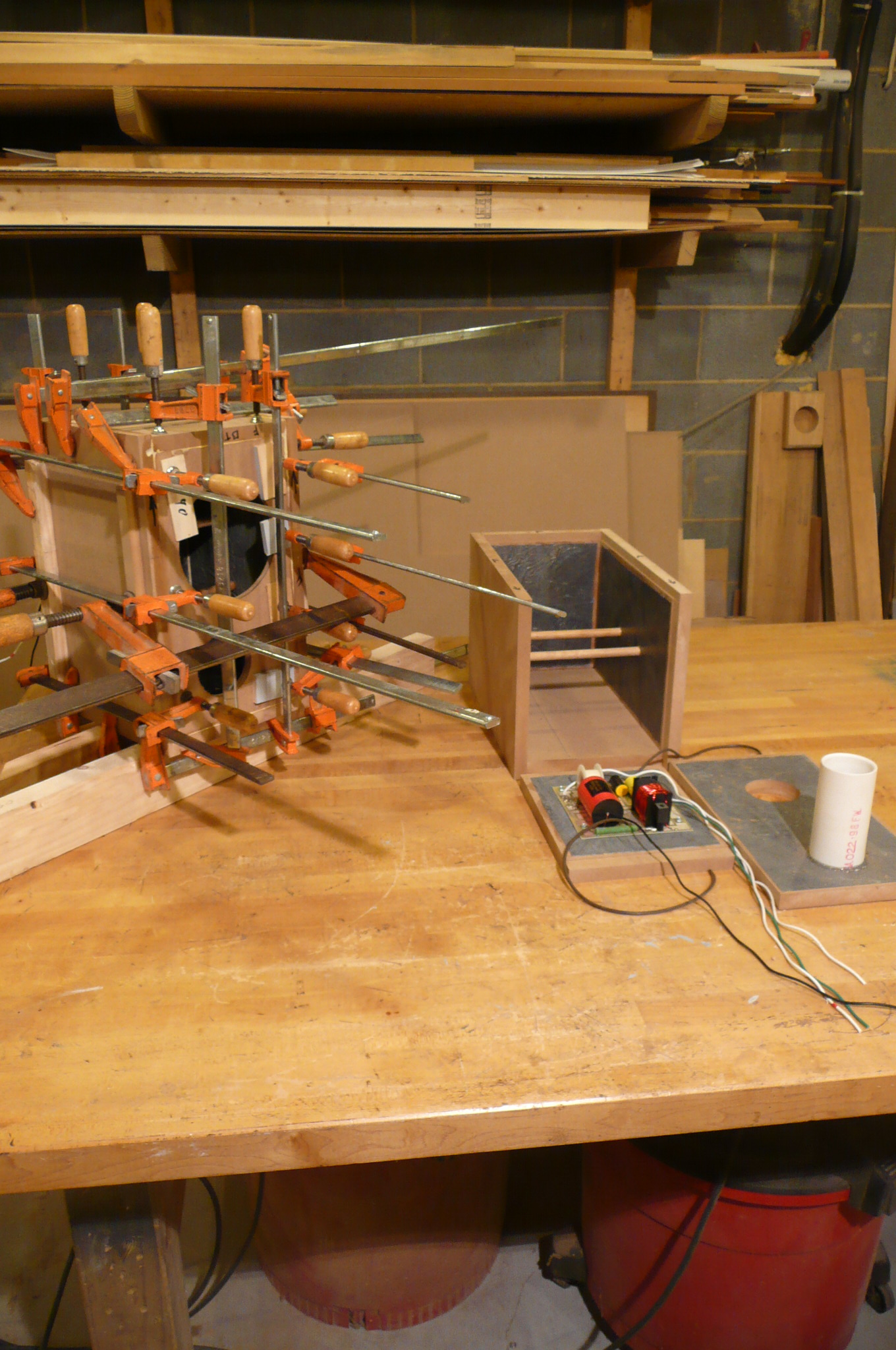

Nanook,
Here is a good example of the shallow rabbit cut; MDF cabinets, but they are lead lined. The shallow cut is nice for assembly; the dowels were also a good idea (not mine). No nails, etc.
The plans and speakers are the Zaph SR71 kit (no box).
