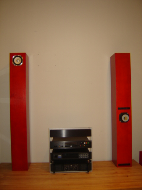

May I ask what is a factory recommended DBR? Double bass reflex? I did finish up the double tall boxes, but when I started to test them, the top half/top box was sounding really nice (may not use bottom section).
For this set I used Fostex plans; medex wood and lead lined the top chamber; they do have very nice bass, again just the tops sections. I did flip the “L” port for the small chamber, which gave me a little extra room for dampening.
I can always cut away the bottom sections, if I don’t end up using them, or they can be extra tall stands.

ODougbo - yes by DBR, I was referring to the Double (chamber) Bass Reflex. The Fostex sketch that accompanied your FX120 is not a unique occurrence of such a design. To be honest, I haven't heard them, but after participating or listening to several (at least 4?) builds of various of their "recommended" designs, I've pretty much closed my mind on that subject - there are far too many much better sounding enclosure designs for their drivers.
Yup, the FX120 is a great driver, but at approx the same size and 1/3 the cost, the bang for the buck from the FF125W is even more amazing.
If you venture into another smallish FR driver project, might I suggest you try the opposite approach of materials / damping? - i.e. light and stiff plywood (or solids if you're that confident), well braced, but absent the mass loading for "resonance control" . Since you happen to have 4 pieces of a very good driver that can work well in smaller less complicated boxes than your existing, if you really want to be adventuresome, try building identical pairs with both techniques - it might be an eye / ear - opener.

All very fascinating ~ an all new experience for me. I got off to a really bad start; the amplifier was set all wrong, the DIP switches were very hard to see, and the bass filters were set “on”.
The DBR really has nice bass extension; I did make a couple of modifications. If I was going to do it again, some bracing in the larger cabinet might be good.
I’m looking forward to a new build with the FX120 (I have a couple more) what box would you suggest?
I did see the T-line project on a DIY page, the author said the bass was not impressive, so that got me worried that this might be a big box, that didn’t work.
*The tall micro towers: I can always hook up the second lower pair to an on-off switch; it would only change the ohms from 8ohm to 4ohm.

The double bass reflex cabinet goes way lower than 50hz, maybe the author was referring to flat response. I would say, the bass is quite warm/nice; no testing equipment here, but I could borrow a pink noise, spectrum analyzer from a buddy and see what kind of results I can acquire.* I do hear bass down to 25hz – 30hz; sweeping with a generator.
The Fostex double bass reflex build is pretty easy, e.g. 6” rips of wood and the side panels.* Here’s the recipe I came up with for the top chamber: (1) line it with lead (2) cut a snug piece of 1” foam; cut a 2” hole in that (3) add standard wool, the foam keeps the wool from blocking the vent.* Again, I used Medex, a grade up from MDF.
I made to 2 small modifications; I flipped over the top “L” for the top chamber and moved the large chamber’s front port to the back.
Just to be clear, I referring to the top sections only – when all 4 are playing, they have an 8” - 10” woofer sound (but it is somewhat muddy). *I’m going to add a simple switch, a bass boost, 2 speakers or all 4. *
