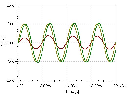

Except again, Graham illustrated FCD using using the purely linear model.
The Klippel system can generate a distortion chart with a color-coded curve showing exactly what portion of the total distortion is due to back-EMF of the loudspeaker driver. Fun tool that Kippel is, if somewhat pricey.

All I wanted to say is that is that I don’t know weather or not the pheromone of FCD gets more obvious or less obvious using a non linear (Better model than the linear) and if the linear model in fact makes the whole thing seam worse/better than it actually is.
Does anyone know this – did anyone do sensitivity calculations comparing the two scenarios? Linear vs. Nonlinear loading of the amp?
Steve – what’s the graph legend on the graph? – thanks
