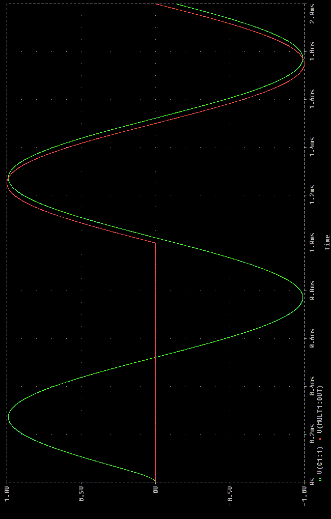

I added a simulation graph below, showing what happens when one passes a simulated sinusoid through an RC lowpass (green trace). I left away the original sinusoid for clarity. One can clearly see that there is something going on at beginning of the green trace. But that is simply due to the fact that the source signal is basically the same as the red trace shows: the product of a sinusoid and a step function. No one could reasonably assume that such a signal would be left untouched by a filter of ANY sort. But no one can assume such a signal to exist in reality either.
If one runs an FFT of the green trace from 0 to 1 ms then there is definitely a deviation from the spectrum of a pure sine to be seen (not in terms of harmonics but as a spectral envelope, due to the one-time character of the event). When transforming a subsequent full cycle, no distortion is present anymore (beware of the phase-shift).
So this definitely seems to be an artifact not present in the real world.

But it is not a sinusoid at all. There is a sudden turn-on from the zero voltage (dv/dt = 0) to sinusoidal shape at the point of highest dv/dt (red line). Such a signal has wide frequency spectrum, just because of this turn-on. Nothing new that the beginning of the curve is smoothed by RC, depends only on this time constant. A question is whether a musical instrument can do something like this. The time shift between the two sinusoids is exactly equal to the time constant of the RC filter.
Let's nail once and for all the idea that this truncated single cycle of sine wave has anything to do with musical signals. I think there is a major misunderstanding going on between mathematicians and non-mathematicians here - see if this helps:
1. Imagine a physical object - a guitar string, a microphone diaphragm, a loudspeaker cone, your eardrum - trying to trace the this waveform. Up to time t=0, it is stationary; after time t=0 it is tracing the sine wave.
2. As soon as it starts tracing the sine wave, it begins moving with a particular velocity (dependent on the amplitude and frequency of the sine wave). Visually, imagine drawing a straight line touching the sine wave at t=0 and measuring its slope - this is its initial velocity.
3. In an instant, this object has changed from being stationary to moving with a given velocity. What is its acceleration - i.e. how quickly did its velocity change? It changed from nothing to something in no time at all: its acceleration must be infinite.
4. For the object to move, it must have a force acting on it equal to its mass times the acceleration. To produce infinite acceleration requires, therefore, infinite force.
Obviously, in the real world, you cannot generate an infinite force. The force which sets a guitar string moving has to come from the (finite) tension in the string; the force which moves a drum head is derived from the (finite) momentum of the drumstick. In other words:
No real physical signal ever looks exactly like Graham's single-cycle sine wave
What's more, the sort of limitations imposed by a finite force acting on an object of finite mass are exactly the same kind of limitations imposed by an amplifier of finite bandwidth; there is no justification for thinking the ear treats them differently.
Cheers
IH
That's what I am desperately trying to explain all the time, but maybe I wasn't clear enough. It is the same sort of signal as the red trace shows, only difference being the point in time when it starts.
While musical instruments can generate spectral content that is reaching quite high in frequency, such a signal definitely doesn't exist in reality.
