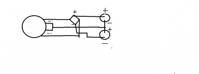

For wiring the filter capacitors (2x 8200uF Nichicon Gold Tune) I presumed I would connect the centre tap of the toroid to the -ve pin on both capacitors, connect the +ve from the diode bridge to one of the capacitors +ve pin & the -ve from the diode bridge to the other capacitors +ve pin. Not sure if this diagram will make any more sense of my explanation!
+ve --------------- +ve
capacitor
centre ------------ -ve
capacitor
-ve ---------------- +ve
However from looking at a schematic for a filter board on an auction site, it seems this would be the wrong way of doing it?
http://www.aliexpress.com/product-f...-board-for-amp-Free-shipping-wholesalers.html
Can anybody confirm how I'm meant to wire the capacitors? I don't particularly want to destroy them at ~£8 a go...

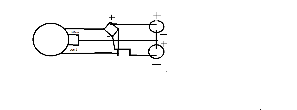

capacitor
capacitor
No, do not connect transformer center tap to negative terminal on both caps. Except for being unique in showing two parallel diodes per segment (per "D01" or "D02", etc) of the rectifier, the schematic you linked is correct for capacitor orientation.
The transformer center tap /amp-ground is higher voltage than the negative power rail return from the diode bridge.

Thanks for the clarification on the capacitors. I'll give it a go in the morning.
