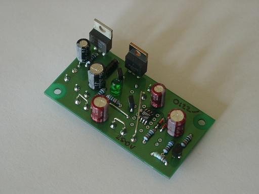

On Shig I got highest resolution (my ultimate goal) with 5 separate regs:
1. LM7812 on the motor drive chip (it had voltage tolerance of 13VDC I believe). I disabled the onboard 5V reg on the motor drive chip, and cut the supply traces to the ASP/DSP/uController, and added a larger heatsink.
2. and 3. I used two ALWSR 5V super-regs with MOSFET-based Vbe pre-reg (described in pink fish media diy forum) for (a) the ASP and DSP and (b) the u-controller. (The stock ALWSR is excellent, but being a linear reg, it does not reach high enough into MHz area, and modding it with a gyrator is recommended.)
4. A separate 5V jfet-based TeddyReg (again, see pink fish media diy) located close to the DSP chip for powering the internal DAC (yes, I used the analog out option).
5. A separate supply module called the "flea" (pink fish media diy) for a Tent clock.
What I wanted in cases 2,3,4, 5 was a wide-band RF filter with high line rejection to attenuate noise present on the supply lines from other digital components and rectification... Unfortunately I have alot of nasty digital audio equipment working with high clock frequencies and line rejection is a big issue for squeezing more performance out of a CD player for me. For others this approach might not bring as much performance enhancement... nor even be to their taste. The resulting sound is somewhat analytic and precise, but not bright or etched. Bass is very powerful, and fundamental tones are much more present than with stock set-up. One word of caution to those pursuing a multiple reg approach however: the timing of the start up of different regs must be properly adjusted to avoid latch up because of an absent clock signal or such. Symptom will be no TOC or a servo spinning out of control upon start up.

....I just ordered such a regulator....
.....so I am gonna give it a try:cool:

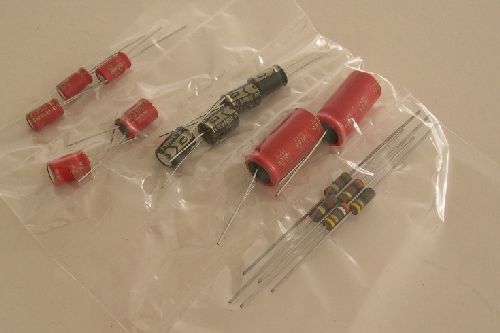

http://www.at-view.co.uk/alwsr.htm
Hello Stan I do not know if this is okay to mention but please moderator remove it if it is uncalled for...;)
Andrew L. Weekes is the guys name..hence the company.....until James mentioned him I honestly never heard of him...
I am willing to try everything out because my present JVC/Sanyo set-up is still not in the league of the modded Wadia....
I must admit the blackgates are not mounted on de motorboard yet even as the mechanical construction...but they must be close to a miracle...
I will also try the 392/92 resistor combination....but as Peter advised I take my time after each change...
On the other hand there are a few tracks in which it most definitely already outperforms my Wadia...:bigeyes:
So for me it is actually a thrilling process....
