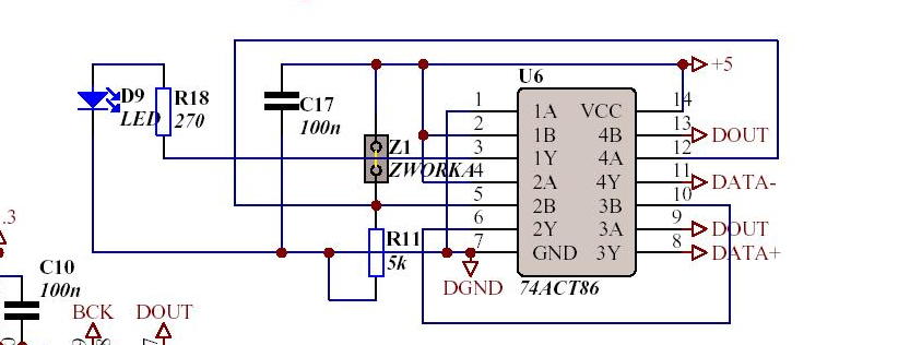

DaveM said:
Is there a way to get balanced output from your NOS Dac? I have been thinking of building one of those, but my system is balanced all the way through, so I am hoping to keep it that way.
Yes, it is possible and I've built one like that. But I don't have the boards for such version as I never found it appealing enough. Basically, you need to add circuit that reverses polarity of data with another DAC section:
The circuit I was using was based on that schematic:
