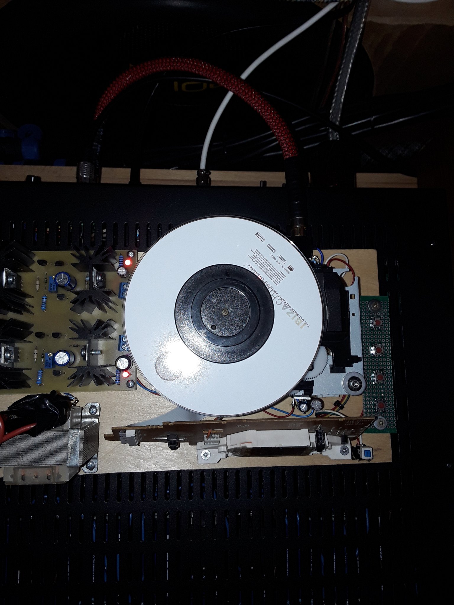

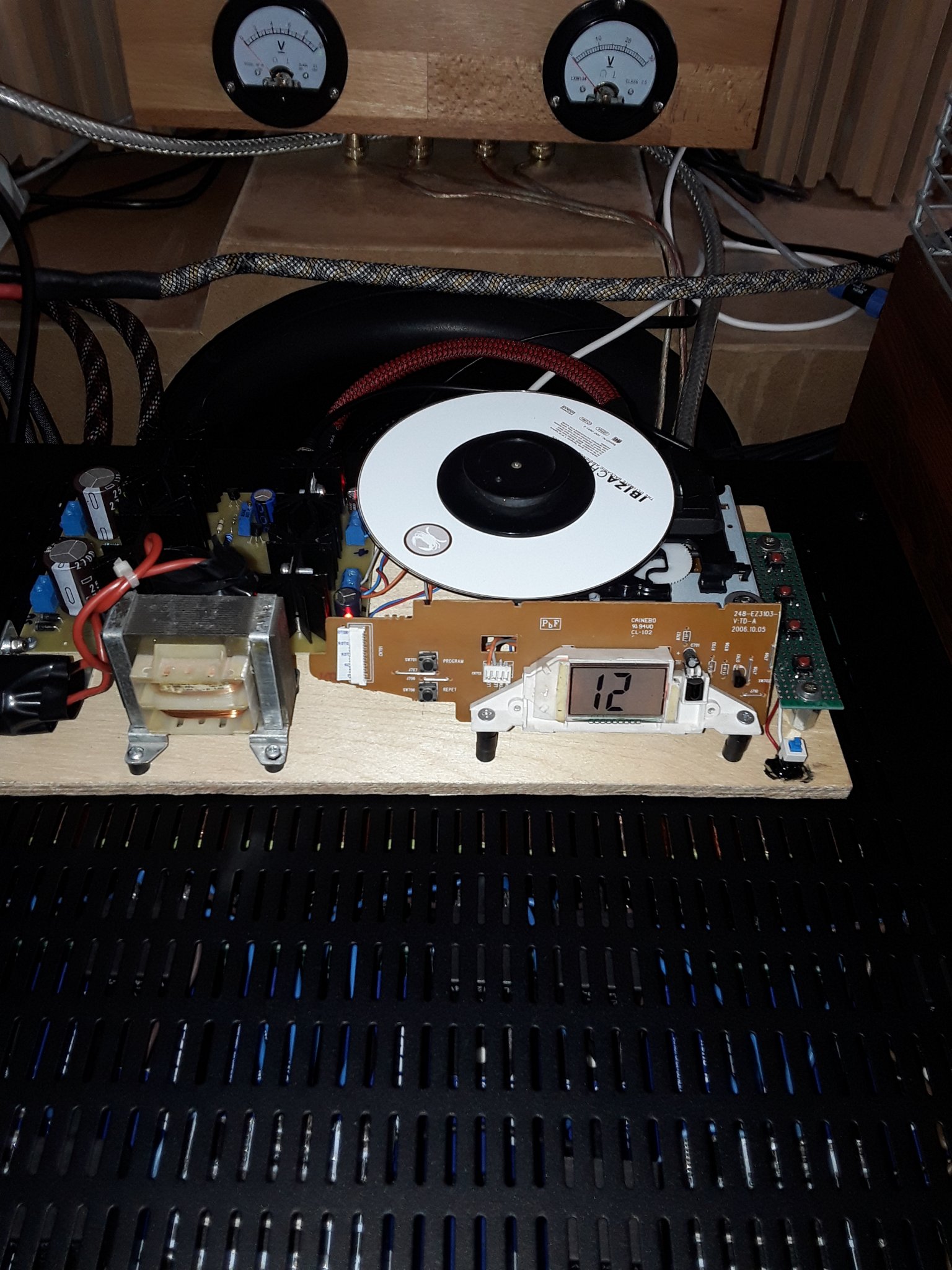

Finaly i have ez31 litle tweeked. Another capacitors. Spdif 300 100ohm with capacitor 47nf smd cog before resistors. 16.9,mhz oscilator from old cd player. Plays weel. 8v from salas. thinking about separate power supply 8v and 5v.Please tell me when i connect very good 5v separate power supply, i need to give 8v that good to? Or 8v is just for mechanism, engines?
8V supply is just for the motors but it absolutely matters - disregard it at your own peril.
In fact, all mechanical parts matter, including how is the mechanism mounted; for example 2 bolts were conclusively proven to sound better than 4, and non-magnetic pucks were found to sound better than the stock one. I even went as far as going puck-less, with great results. CD transport is an analog-digital device, not a purely digital one so analog and mechanical phenomena still do apply.

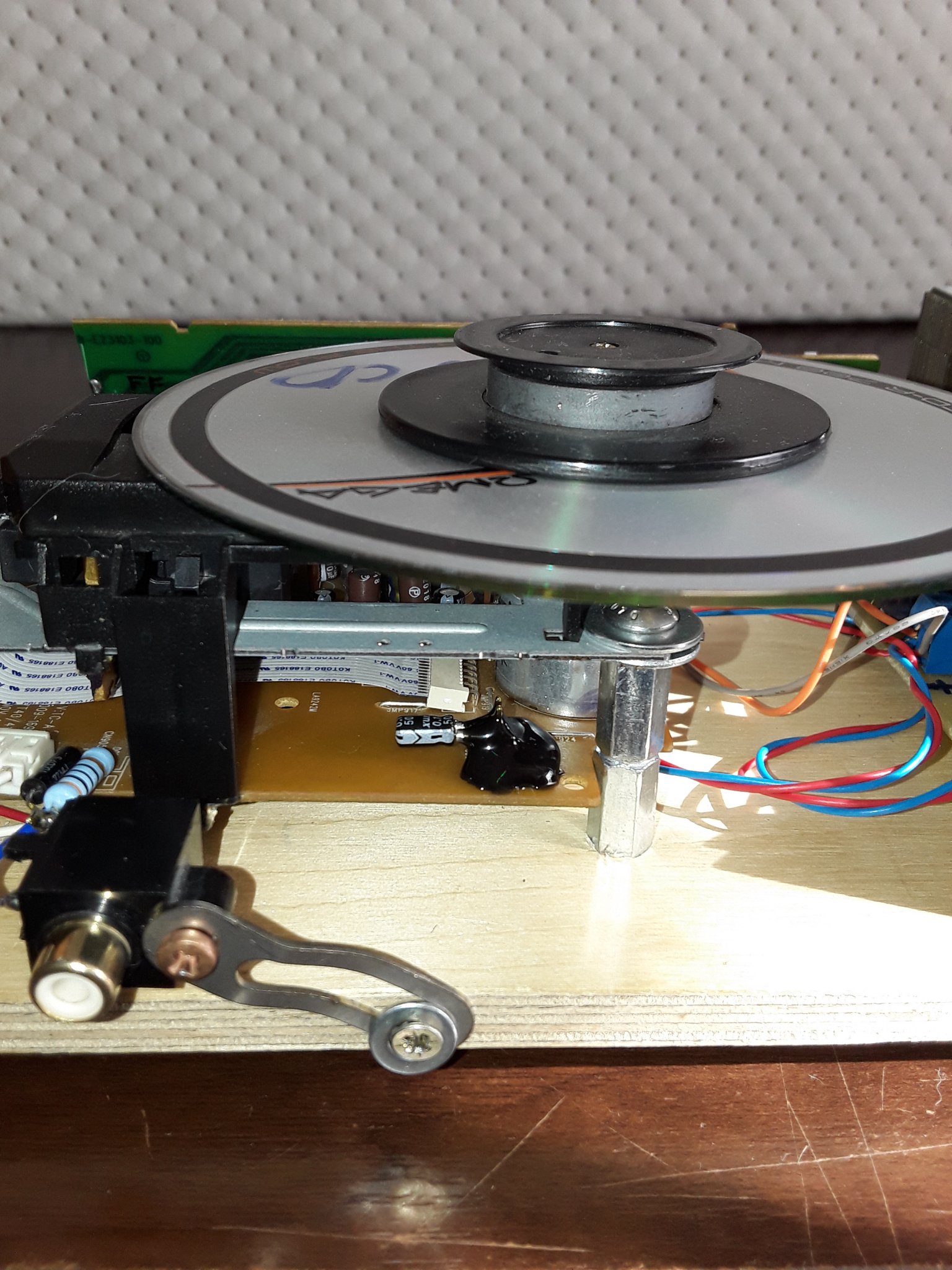

Works well and plays good.I have change capacitors , disolder smd capacitors and tht . Give normal oscilator 16mhz with two 15pf smd npo capacitors to gnd. For now lm317 is powering up 8v, and. Salas are powering new 5v lt1085 stabilizer. Have done black shiga laser mood. But thinig what else. In some time i will change oscilator to oven controled clock with self powering supply. For spdif out i have use smd 100nf np0 capacitor and 300/100 resistors. it is connect to dac that have spdif tranaformer. Thinking about 100nf cap,did i need him .
There is a bunch of component upgrades that you may want to consider, outlined in the website I linked in the post above. I would start with removing some unnecessary components that only degrade the sound.
Other than that, the most influential component is probably C906, but it is also the most expensive to upgrade - the original is surprisingly good and you will need a high-end capacitor such as Duelund to improve upon it; otherwise you may actually "kill the magic" of this fantastic transport.
You may also want to upgrade you power supply electrolytics and C916 to something like Nichicon FG or KZ.
One other note, I can see a very short red cable that I assume is your SPDIF connection. I would suggest switching to a longer cable, around 1.5m/6ft because at this length the signal reflections will be dalayed enough that they will no loner affect the original sample.

I hope you still have the original C906 because that phillips is almost certainly much worse. Do a thorough listening test in direct comparison (install a socket for quick swapping), and pay attention to dynamics especially, and how much the music involves and moves you emotionally - you will see why the original C906 has been called "magical". Repeat the test with anything else you intend to put in C906 position that isn't Duelund or V-Cap because with C906 it is extremely easy to go the wrong way without realising it.I have disolder smd resistors and ,choke,and some elektrolits. Some are change for silmic 2. C906 is philips blue zn 10nf. Sound good, dont know how much god. yes inhave short cable, but with good baterial occ silver and copper with 3 screens.
My comment regarding your cable had nothing to do with its quality - it was true regardless of the cable type because wave reflections always occur when there is an impedance discontinuity. So you can keep using the same cable type if you like its sound signature - using longer will simply make it sound even better. An easy way to see this is to buy/borrow two indentical SPDIF cables, one 0.5m and one 1.5m and do a listening test - you will notice the difference.
