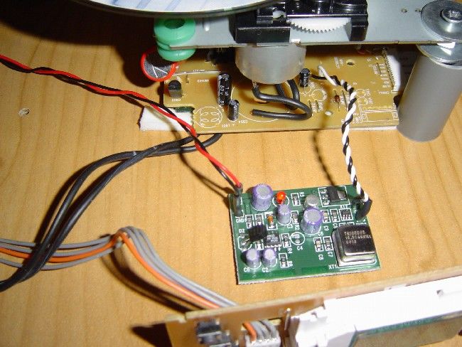

I decided tonight to plug in try out the transport in its untouched state. I made up some patch cables at work today and hooked everything up using the boombox as the PS and the audio out pins to my headphone amp. I mounted to transport on a piece of 1.5" thick poplar that I had laying around and just let the display lay beside it. Everything worked as it should have. I pulled out a couple of cd's that I have listened to religiously for years and heard things that I never knew were there. I thought it must just be my mind playing tricks on me so I hooked up to the computer where I have the same music ripped as flacs. The stuff coming out of the computer sounded utterly lifeless. I could not believe it. And this from the stock board with no changes. I really can't wait now to get all the parts and have this thing setup properly.

I added the trichord clock 4 needs burning in,but at the moment prefer the stock clock for its more natural warmth of tone. Strings have a smoothness and fullness with the original clock, but sound a little more detailed and harsher with the Trichord. The Trichord provides a little more air but not necessarily more presence and realism ......... need to burn the clock 4 in before making more judgements.
however the biggest improvement and it was the same regardless of which clock i used, was adding my own diy bybees. Brought solidity and tangible presence to voices, almost as if i was closer to the microphone now and more able to hear the details in Frankies voice. Not a huge jump but certainly a more significant upgrade.
PS as i had blown up so many transports i got fed up of upgrading the caps and so these comments are made on a stock version with no cap upgrades.
Photos to come at the weekend.

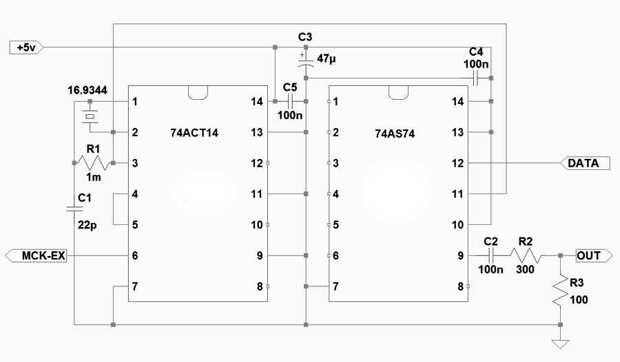

Forgive me if it's a stupid question, but is it very difficult to build one's own discrete clock? It just occurred to me that maybe someone came up with a DIY clock design that beats commercial stuff the way Shigaclone and Gainclone do...?
I was wondering the same thing. The picture above does not look like it would be a complicated thing to make.
