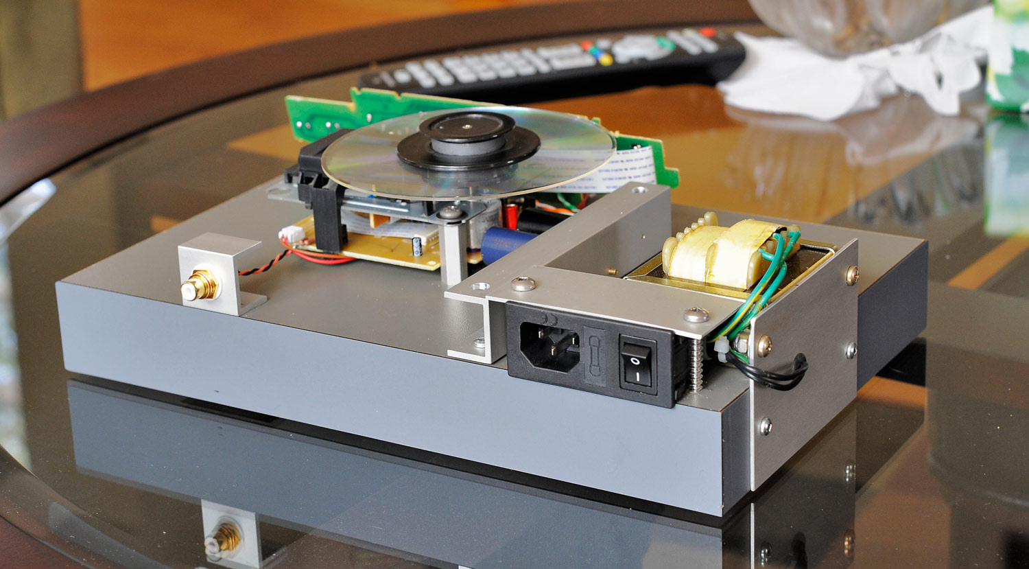

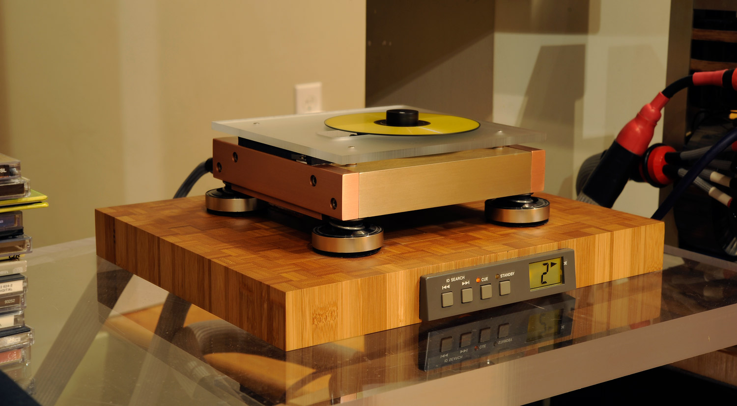

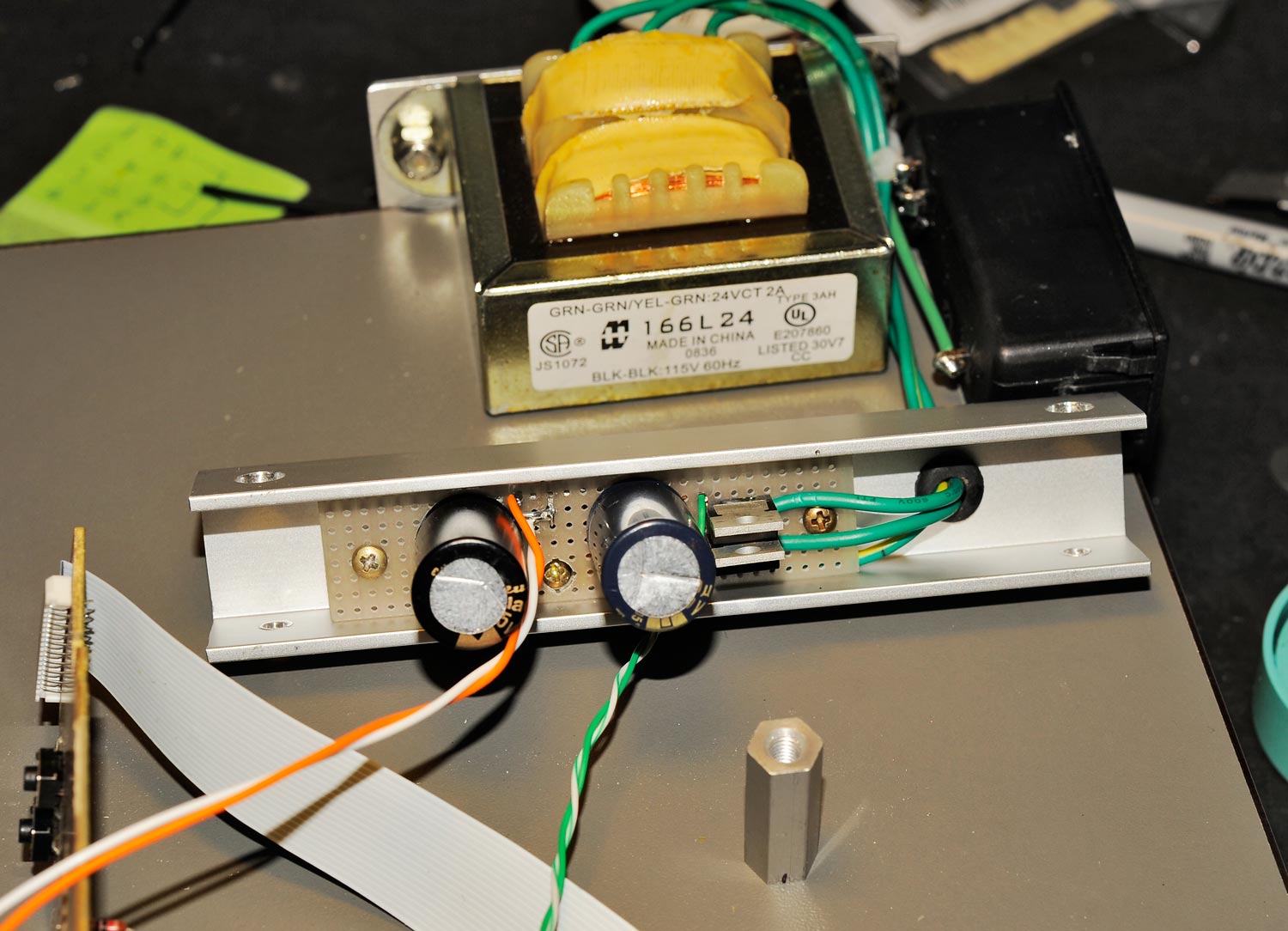

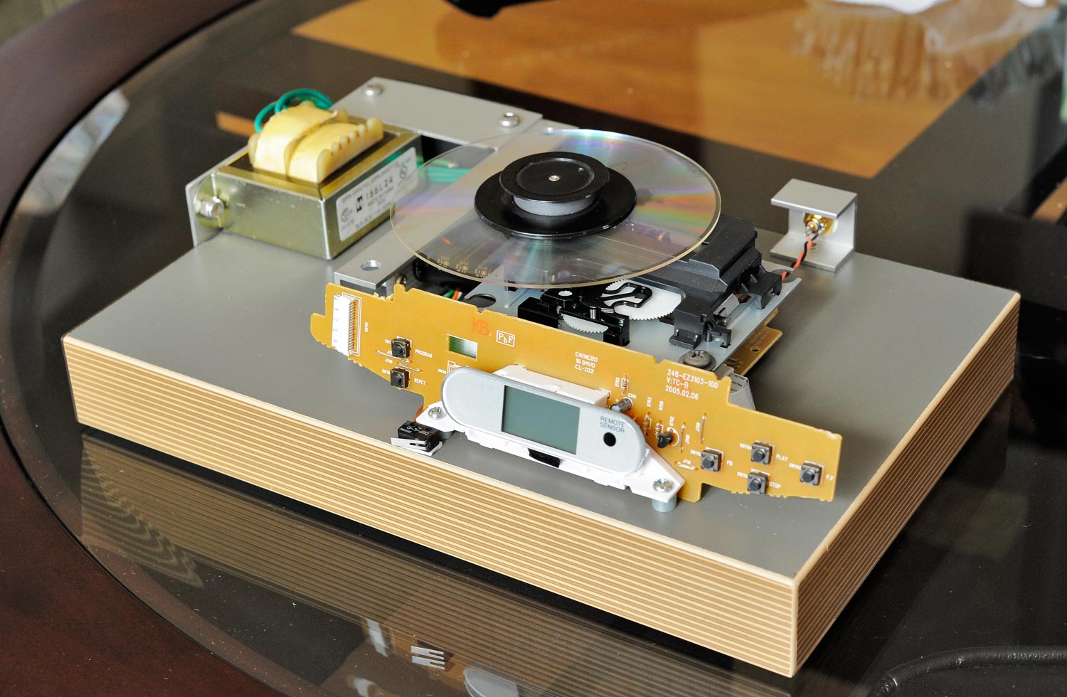

It must be a season of a Shigaclone, I've also built two of them recently, here's a simplified version.

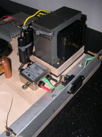

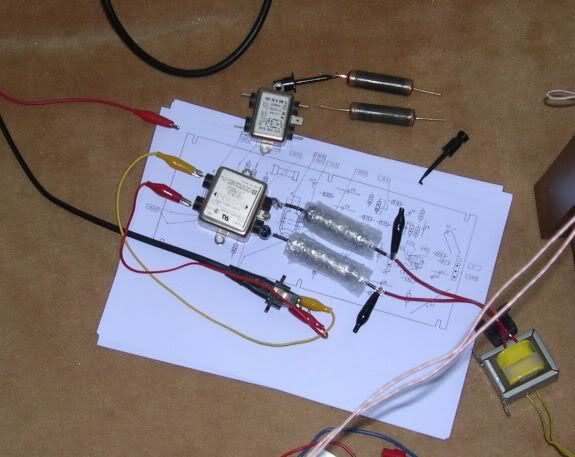

As promised we tested yesterday the use of bybees and the use of mains filtering for the transport.
To do it in some sort of order we first compared a standard transport against my "advanced" contraption.
Needless to say that it bettered everything which made life easier for my friend since he now only has to order the same parts.
All further tests we did on the standard boombox.
First the bybees we picked for fun the golden ones...the change was HUGE...we replaced them for normal ones and thank God the change was for our ears the same so we performed the test with the cheaper bybees (still nearly 200 dollars !!!!).
We listened to church music...the bybees gave us a cathedrale and beautiful voices and the choir never got "raw". With classical guitar and flute the bybees simply gave more presence. So decision made !!!!
Second the mains...we used a small one and a bigger line-filter.
The bigger one proofed better giving a bit more dynamics and more timbre.
We tried several configurations...with or without bybees....
Best solution was the bigger mains with the bybees.
I'm guessing it uses Bobken's discrete regulators that Peter posted a while back, separate for 5V and 8V. We could see some Os-Cons, a V-Cap and a green Wima film cap on the pictures. Also apparent on the photos, Digital Out is taken straight off the chip.
Peter uses separate two CT trafos in his DAC - perhaps he tried this with Shiga?... But that's just speculation :D
