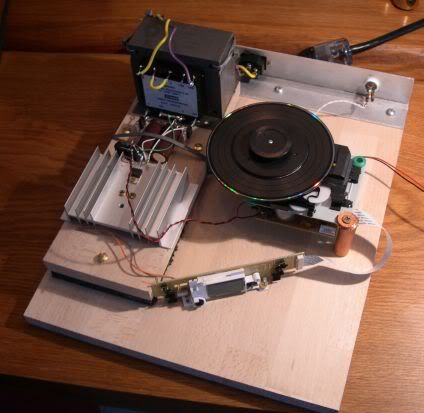

Today time to clean up the extra unneeded prints.......switched to its new power supply....
.....and hey it works...always an exciting moment when the plug goes in to the wallsocket..:att'n:....:D

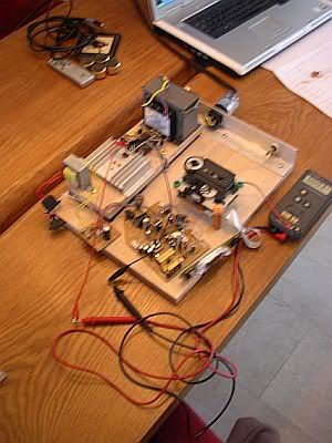

So these are the attenuators:
So, the shiga as standard puts out a high level SPDIF signal - well in excess of the normal consumer level. Now, the SPDIF is not DC, but because its fast, your DMM will read it as DC. I reckon this makes taking a DC measurement a reasonable way of measuring the amplitude of the SPDIF signal. I know it might not be completely accurate, but its better than guesswork.
So, I took some measurements on the shiga I just built. Before the output resistors, I get 2.1V and after the resistors, I get 0.49V - very close to the consumer spec of 0.5V. On my other Shiga, which has the reclocked output, the level is very similar.
So then I added in an attenuator and this knocked the signal down even more, to about 0.15V. This sounded a little better but I got a little white noise at the start of every track. The level is too low for the DAC to hold lock. So I decided to disconnect the resistor network (300/91 pair) and just use the attenuators to drop the level.
Some testing of different attenuation levels ensued and I ended up with a level of around 0.25V....... but heres the thing... the sound quality jumped quite a bit.
I also did some testing on my other shiga with the reclock circuit. This starts off with the same level after the reclocking - 2.2V but it takes 2 attenuators in series (25dB) to get the signal down to ~0.25V. The non-reclocked one only took 1 attenuator (either 10 or a 15dB, I'll check again later). I'm thinking that the reclocking buffers the signal, so it takes more attenuation?
So my recommendation is that you try this out. Disconnect the 300/100 from each other, you can leave them in place if you want, but take the spdif from before the resistors and use these attenuators to take down the signal to <.5V. The attenuators cost about $15 each, and I'd say get 6dB, 10dB and 15dB ones so you have a number of values to check out. FWIW, I've tried these on a number of sources and they have always brought about an improvement. No, I am not connected with minicircuits!! If I was I'd be rich I tells ya! and be having "my man" to do my work for me!
Dr. H has some ordered, so maybe wait until he has tried them out. Minicircuits are in the UK and USA, and seemed to be fine to deal with, although I did have to sign an end-user agreement to say I wasn;t going to build WMDs with the attenuators.
