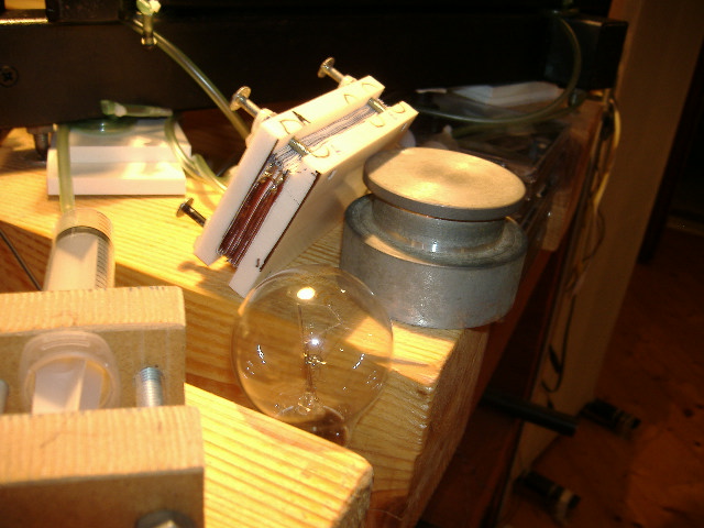

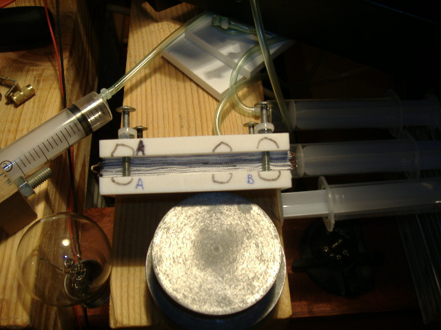

Thanks for your sharing. The homemade cap is truly interesting to me. Do you have a picture show the inside of the two white blocks? I would like to know how the copper and the cotton are structured.
Sorry for late answer but I was busy.I don't have time to open the cap and so I will try to explain how to make it.Take two nonmetalic blocks which can be screwed tightly.Cut 22 pcs. of 12AWG copper foil.11 pcs. are used to form each electrode in our cap.I have made a foils 9cm long.Then cut a cotton isolator sheets to same length of copper and little bit larger and put one layer of cotton on the cap block,than put a sheet of copper on the cotton and leave it few mm over the block edge(see the photo) to can solder side A of cap electrode.On the copper than go a sheet of cotton and must cover all except the few mm over length where you solder.
The same is with electrode B ,Copper-Cotton and than side A again ,Copper-Cotton and so until you spend all the sheets.Before you begin with the sheet placing make holes for the blocks ,put all four screws in one block rotate it so the screws are standing with the heads on the bottom and you have sheets rail when you place them.When you finish just clamp with another
block ,screw them and solder 11 each of electrodes and you have perfect neutral sounding cap.Try to make it during dry weather because you do it of a cotton.You can isolate it against humidity if you want but on the transport I never had troubles with it.If you use it on some tube grid like input cap better isolate it for non humidity to not allow some current leakage.
I hope it was all explained well and if not ask.

nemo1968,
The cap looks wonderful! Thanks for your explanation. It is clear and detailed so that I am able to make my own caps. Instead of cottons, how about papers, plastic wraps, or something are used for isolation?
By the way, what is the purpose of the syringes on the pictures? For audio projects, they look so unique and interesting.
I chosen the cotton because of its dielectric constant factor which is 1.4.The teflon is around 2 and the air is 1.0 if I am not wrong.The intention was minimal loss of signal and as the air capacitor of such value is difficult task the choice was cotton.Natural sound as itself.It is also great as damper in cap even if you don't screw it very tight but in that case you loose some nF.I think that choosing the plastic would be waste of time soundwise but the paper might be nice as the rise seeds are pretty like cotton in dielectric constant table so you can try the Rizla rolls rice paper from tobacco shop.I have tried it in the cable construction and I was satisfied but the cotton sounds better in the cable because of great damping of the leads, I suppose.
Syringes are for air suspension under the turntable as I can not apply traditional springs as the air cushion arm is sensitive about springs level change.In that way I can put my table in the level by pressing the syringe more or less(something like old Citroen cars or the bus).Syringe is attached on the closed tube and the tube is placed under the table.You pump it and that is it.Very powerful ,three syringes can carry around 30kg of that turntable above ground with 15ml of the air injected in 4mm aquarium hose.The table is stable and isolated from feedback.

Thanks for compliments and sorry for late answer.
I didn't tested various materials.I am using Cerrock.This is the link:Kerrock
I have plenty of that material and doesn't flex when is screwed so it is perfect for a purpose.It have feel like stone.It is very easy to work with it too, not like plexi.I chosen a cotton which I had around ,just uncolored most natural that I found.I used an old bed cover.Yes ,the thinest the better and more capacity you have from less copper.You can make a value which you wish by adding more layers and you can just disconnect outer layers if you need less capacity.If you need two equal capacitors you can adjust the value of both in a pico range by tightening the screws more or less.Wonderful.....Just have to impregnate them after against humidity so they rest stable.
I think less cotton weave should be better because you have more air in between but it can be also very easy to short electrodes so I chosen a tight weave cotton.
I think i'm going to have to try making a silver and silk version as well as this copper and cotton. thanks so much for sharing, I had thought it should be as easy as this, have you thought about sealing with organic resin the way Duelund does?
I would do caps from silver too but it is too expensive and hard to get.The silk must also be great.I am sealing all with petrol parafin.It is also mechanically good against vibrations.I use it to dead the clock crystals and various other things with great sonic improvement.
