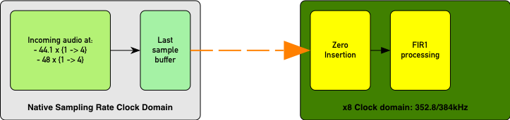

I hope this will illustrate what I think is happening with the TrueNOS (and upsampling in general) a bit more clearly...
attachment.php
You have incoming data received by the DAM, and processed at the native sampling rate. 44.1, 88.2, 176.4, 352.8 and so on. The last received piece of data will sit in a buffer until the buffer has new data loaded at the next clock cycle at the incoming clock rate.
The next stage of processing is always running at the x8 rates - 352.8 or 384kHz. Based on what's happening with the TrueNOS filter, I'm fairly certain that the buffer from the input stage is read on every clock cycle which means with a 44.1kHz input data rate the buffered data will be read 8 times before it is updated.
The zero insert coefficient is basically setting how many zeros are inserted after the initial sample is read. If it's set for "1" there is no replacement/insertion done, so the second stage will end up with 8 copies of the original sample, assuming a 44.1/48 clock rate.
So for 44.1/48 you end up with:
x1 - 1 1 1 1 1 1 1 1
x2 - 1 0 1 0 1 0 1 0
x4 - 1 0 0 0 1 0 0 0
x8 - 1 0 0 0 0 0 0 0
So by setting zero insert coefficient to 1 the second stage of the DAC reads the input buffer every clock cycle, and there is no need to convolve with an 8 x 1.000 value "filter" to reconstruct the original samples because the samples data is already there...

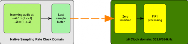

attachment.php
I think with "TrueNOS" you are just somehow lucky with uninitialized values
As I said, there isn't much error checking on filter tools, parameters have to match or consequences varies between subtle differences, to strange sound to no sound....
The zero insert coefficient is basically setting how many zeros are inserted after the initial sample is read. If it's set for "1" there is no replacement/insertion done ...
I am next to sure that there is no special handling for the coefficients 1. It will just be the usual convolution code in the special case of filter length 1.
Moreover in real no zeros are inserted and no convolution with that signal and the filter is done at the 352.8 or 384kHz level.
The theoretically pattern s_i,0,0...0,s_{i+1},0,0... is used to implement the convolution more efficient, as 8 different (changing with every clock cycle) convolutions with filters of 1/8 of the original length (with 8x oversampling). This is standard textbook stuff and is the reason why you are allowed the double maximal numbers of filter taps for 44.1 compared with 88.2 etc.
I think you might be correct...
There is something weird going on with these filters.... I'd be able to load and listen to TrueNOS and TNT's MB2b filter - which has the coefficient set to 2 - and I'd had the DAM hooked up and was doing test tone measurements during the week with the TrueNOS loaded.
I'd tried doing some impulse measurements and was having trouble getting sensible results with the TrueNOS - the impulse looked like a normal brick wall filter.
That had all been done with the dam powered up - just unplugged from the amp and direct into my audio interface.
This morning I thought I'd double check the output with the Picoscope which requires powering down and moving the DAC.
Now neither the TrueNOS nor the MB2b will lock to an incoming signal. I've tried Amanero, TOSLINK and Stello U3 -> SPDIF from my macbook pro and no luck..
I recall a few people reporting their DAM's wouldn't lock with the MB2b filter (MB2a is ok) but I never really had much problem, although looking back it I recall commenting it sounded the same as the stock filter I was comparing it against. When I listen during the week it sound very much like the NewNOS filter I had listened to before, so it possible that the under some circumstances DAM is downloading these faulty filters but the previous filter is retained when you resync. Makes you wonder...
So it looks like my last couple posts on the subject are observations based on a bug :rolleyes:
Feel free to ignore...
And I think I'll leave the zero insert coefficient well alone in future...

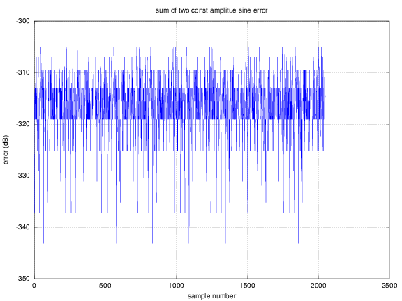

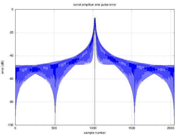

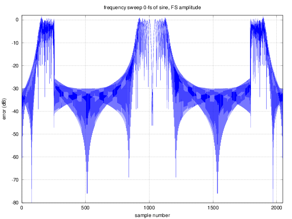

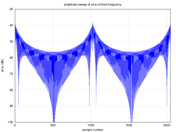

Looking at an appropriate example this becomes quite obvious: Compare a sine wave of fixed frequency, in the first case with constant amplitude, in the second case with rising amplitude. If you look at the filtered result at the location in time where case 1 and 2 have the same amplitude, they surely will differ, although you would like to see the same for a perfect filter.
Here some pictures of frequency domain filtering (of periodic signals) with a brick lowpass for fs/8.
The difference from the expected signal is plotted.
1.) The signal is the sum of two sine signals with constant amplitude. One with frequency slightly above fs/8 one with frequency slightly below fs/8.
The expected signal is thus the sine with frequency slightly below fs/8. The filter does that next to perfect (you get only the expected error due to finite precision arithmetic):
2.) The signal is a sine of constant amplitude with frequency slightly below fs/8, but the signal is only present for 1/128 of the total time sampled (in the center of the samples). The expected signal with a perfect filter would be the signal itself.
3.) The signal is a sine with frequency slightly below fs/8, the amplitude sweeping from 0 to FS and back. The expected signal with a perfect filter is the signal itself.
4.) The signal is a frequency sweep from f=0 to fs (so aliased 0-fs/2-0) of full amplitude.
The expected signal is the part where the (aliased) frequency is below fs/8. The result is terrible. I hope I made an error but for the moment see not were.
The used octave code is attached.
