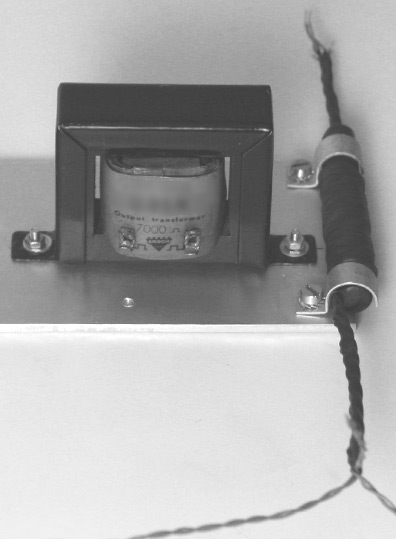

The distance between my CM choke (on the right) and the OPT is one inch. Too close? Fields are opposite though.

As far as your common mode choke, if you don't hear or measure any hum pickup, then you're golden. I had issues with my phase splitter transformer picking up the field from my common mode choke, and had to remove it. Tight quarters, and probably wasn't necessary for my application. Dedicated split bobbin xfmr, shielded twisted pair, ceramic caps was sufficient.
