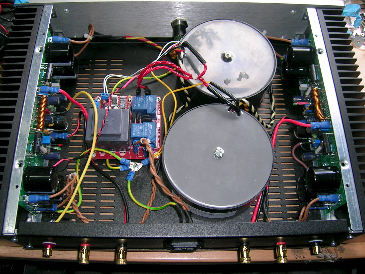

My brother s FetZilla is alive and playing nice music.In post 130 you could read I'd some troubles but I took care of it and it was my own stupid fault.The first channel bad solder of R16 near T4.The second channel soldered D3 in the wrong direction.Pics will follow shortly
Here's mine with my newly build B1 buffer pre (remote control 4 inputs)
My brothers FetZilla

Is that a softstart you have next to the transformer ? Is it necessary for the Fetzilla?
Hi Patrick,
Yes it is a soft-start.It allows you to use three kind of switches.A momentary,onoff and a trigger.It only cost 20Euro and I tought it wouldn't harm.
A soft start is used when one wants to limit the start up current flowing into the mains transformer.Hi Patrick,
Is that a softstart you have next to the transformer ? Is it necessary for the Fetzilla?.........
The soft start has absolutely nothing to do with what load is applied to the output of the transformer.
