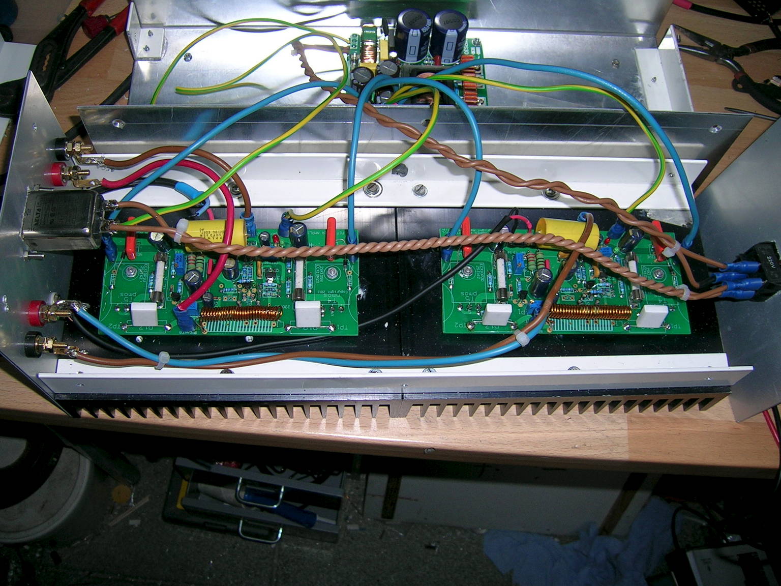

My conclusion for now mids and treble are better more open and the bass section is changed different sound.Planning to order a second SMPS to see if there are any changes between the use of one SMPS fort two channels or 2 SMPS for each channel.
Result after some testing I will again buy a SMPS for this amp;
May I ask how you hook up the SMPS with this amp? Do you somehow bypass the on-board bridges and filters? How do you hook up the ground?
Thanks, Terry
When you use the whole boards it is 23cm long.That's the minimum lenght you can take,when you gut the board both side it's about 15cm.My previous FetZilla board uses sinks of 30cm x 9cm and the heat was between 38 and 40 degrees celcius.Will also do a test with a 3mm thick alu. cover and bottom without any other sink.

Use the voltage drop to find the current.
That current should match suggestions for the in line device.
Multiply the current times the voltage drop and you have the dissipation.
Now multiply by a factor to ensure cool running. Anywhere from 2times to 20times.

Have you built a FetZilla? Maybe....... how about you set it idling, then measure all voltages across each resistor, then, square each voltage and divide by the ohms of each resistor. This gives you the dissipation at idle, and it's very close to the highest value - with the except of the output source resistors, which should each be rated to 3 watts each.
Alternatively, built the thing, use 1/2W resistors suggested, and be done with it.....

The NFetZilla does not have the noise problem that the Group Buy PCB has.
NFetZilla is the inverted version with all N and P swapped. I posted a sch a long time ago.

In the DIY world, people search the internet to find the best design they can find. The problem is that other people's assessments of the sound quality are variable, and erratic; we really can't know if other's opinions are legit or complete. Furthermore, if you don't have the complete technical suite you don't really know precisely what you are looking for in the schematic, and you can't be sure if negative comments are technical, or sonically, or based entirely subjective. Finally, there are lots of people who comment on everything they say, and publish their opinion gratuitously, and sometimes they have strong prejudices that often discourage people from building.
My suggestion is to look for strong, consistent and thorough documentation. Very few schematics on the net carry full documentation - BOMs, building instruments, pcb designs, gerbers, and subjective comments from builders. All of this is done for the FetZilla - I know because I wrote most of it. This is try of the VSSA, the Honey Badger, and most of the DIYaudio projects as well. I spent many years in technical writing, and my instructions on the FetZilla thread are detailed and carefully assembled. Because of careful proofing, all my documentation is now debugged.
Nothing is ever perfect. There are holes in everything, and if the designer is not liked, or regarded as an idiot, there will be trenchant criticism. People are always criticised if they produce anything; it is the human condition. Fortunately there are five minds in the FetZilla design project; Lineout, Greg, Mike, Paul and me. No one individual can be singled out as the designer; it is a 'committee' design. Many people say it is a high end amplifier, and certainly it's very simple, and integrated on a single pcb. Perhaps it is a camel? You could do well building the FetZilla, it will not disappoint.
I didn't notice any 'noise' during my testing. It's certainly better than 100dB below at idle. If you decide to amend it to the NFetZilla, be sure that the documentation is thorough and you know exactly what you are doing during the assembly.
All the five people in the design process of the FetZilla gave their time gratis. It is completely free of design cost, like most of Nelson Pass' designs. This is a very stable, solid product and I commend it to you. It is very musical. But you have to listen to it for at least a couple of weeks to come to a considered opinion.
