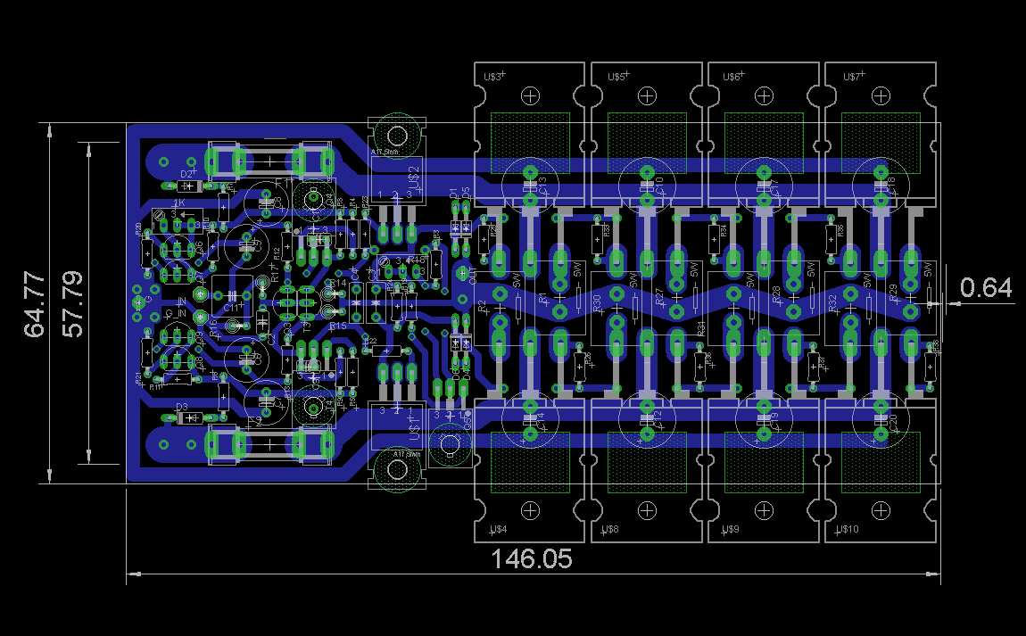

FET-hex explendit amplifier

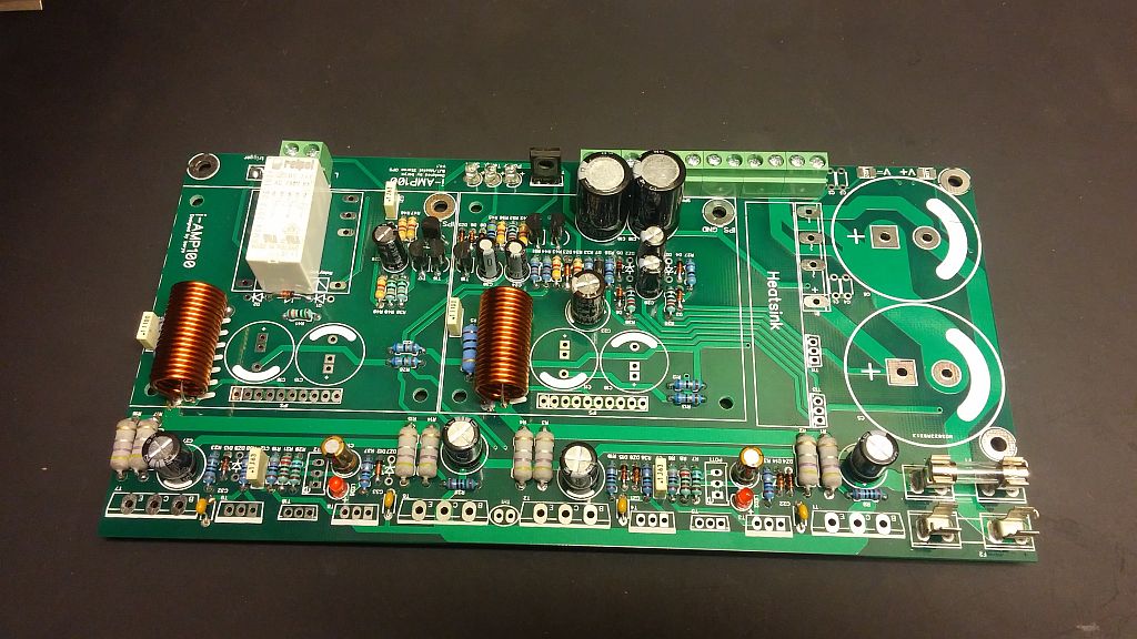

Very nice and reasonable PCB! PWR Ground with high current tracks does not go near (or around) small-current signall paths, as usual seen in other Layouts.
Have you tested it?
If it is working could you share the Egle file or PDF.
p.s. It's good idea to add Gate/Base stoppers and VBE transistor for thermal compensation if used in Class AB operation.
OK, shortened the track lengths for C9/C10 and used SMD bypasses on the underside as suggested - however, size of C9/C10 had to be reduced from 16mm to 12.5mm to get the most placement benefit. That's probably OK, since there's enough choice of 470..1000uF, 50 to 63V caps in 12.5mm.
The overall dimensions are down to 2" x 2" (~50mm x 50 mm), which seems to be close to optimal for the layout, allowing interchangeable use of TO3P and TO247 outputs..

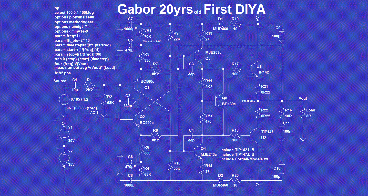

Yes,my stage is biased in class B,so not current on output transistors.
I tried to use two diodes.I don't hear any changes in sound.
With 3 diodes I've got 6 mA (through NPN) and 2.5 mA (PNP) transistors.
With 2 diodes I've got 2 mA (NPN) and 0.05 mA (PNP)
So it's like Class AB, no crossover (step) distortion on output even with small (0.01V) input signal.

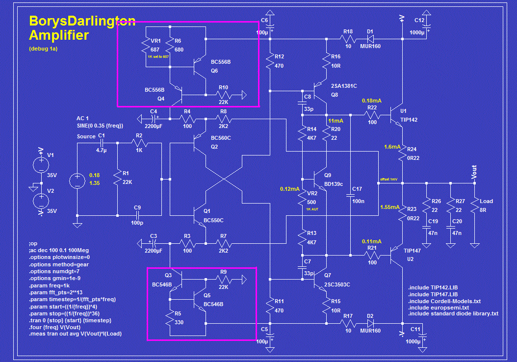

I have changed Darlington transistors to Mosfets (IRFP) and have got crossover distortion even with 3 diodes and no current at output transistors at all. This is Class B operation :)
Ok I have a silencer to change on my car this afternoon and I do the simulation on the other.
Please do not forget to sim my circuit if you have time
Thank you:)
I post the circuit here for now, in case someone has interest there is a thread on the amp.
To me sound fantastic but need some tweak to make it 100% stable..:eek: THESE circuit already include some mode to be more thermal stable, that NOT TESTED YET!
Greetings

Why You are using so high impedance NFB network resistors ? 15k/330R.
I do not have a time to sim it but it is so simple amplifier that you can just plug it in and measure the currents. The stability should be fine, it is bulletproof design.

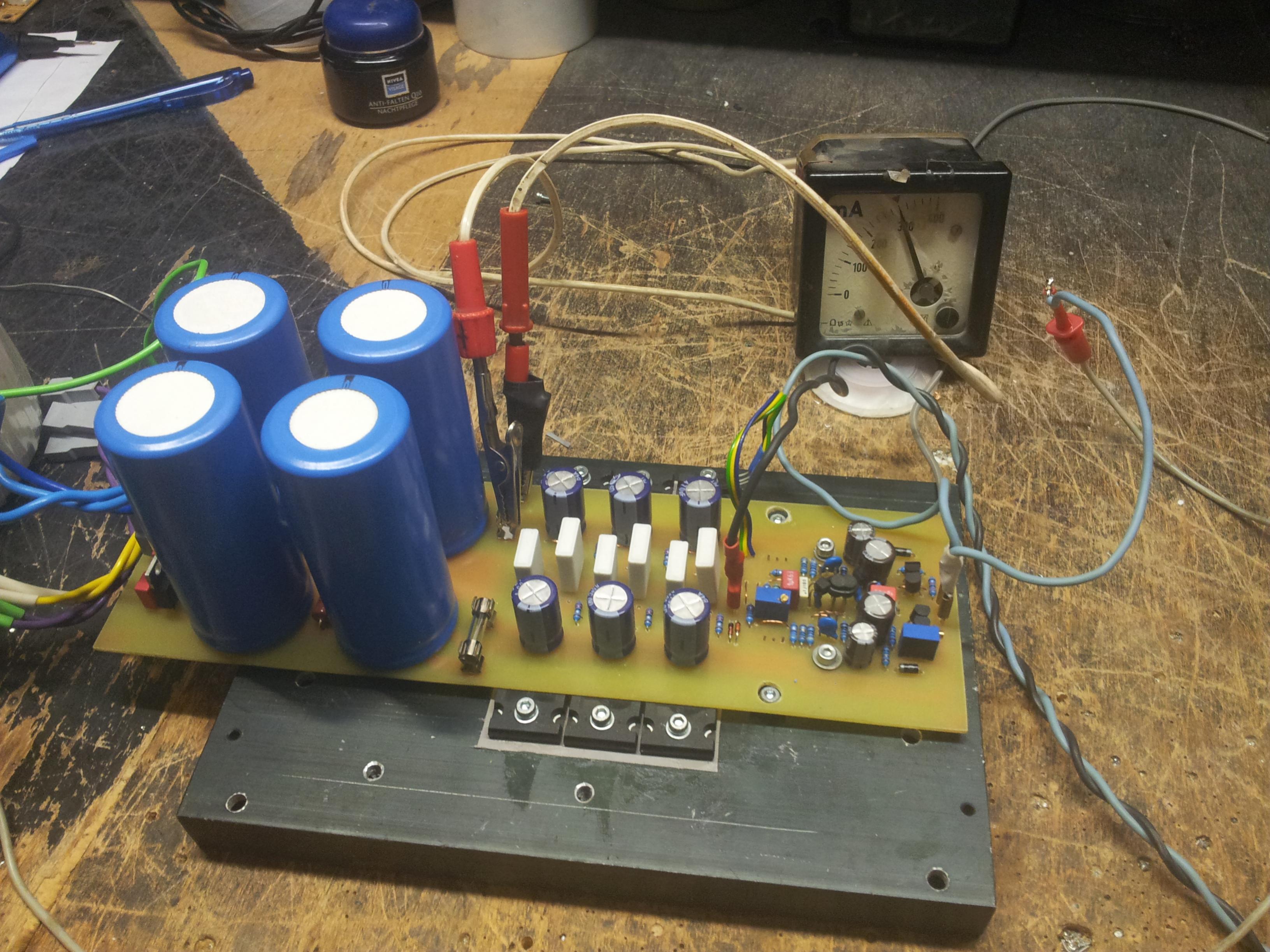

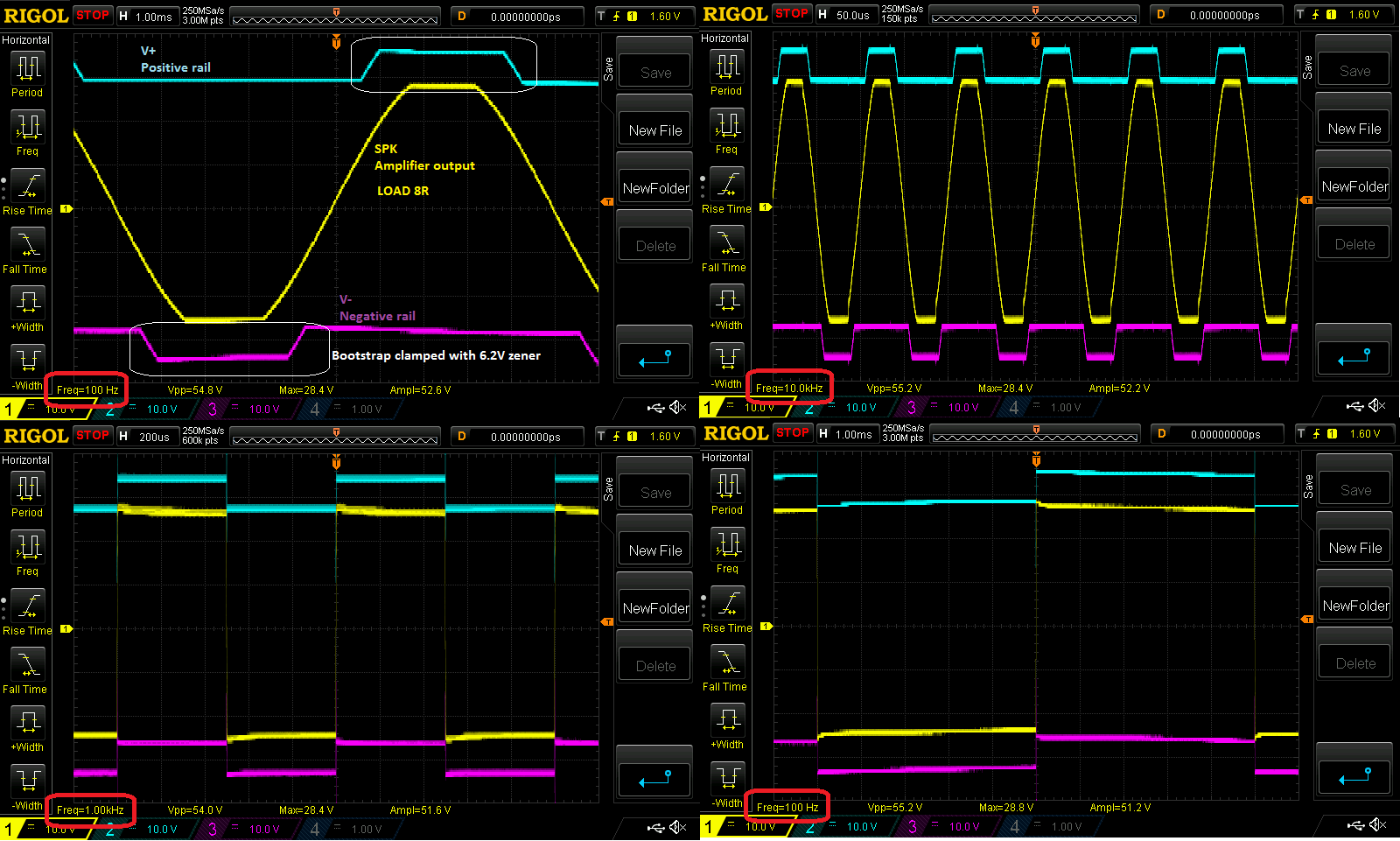

I am working on the high efficent hexfet ops with double bootstrap (for subwofer amplifier), first tests are passed OK. I will have to prepare another board and get a few more of mosfets at the OPS. The output swings nearly from rail to rail (screanshots with single pair of mosfets only). The temperature stability is rock solid!
More reports end of the week.

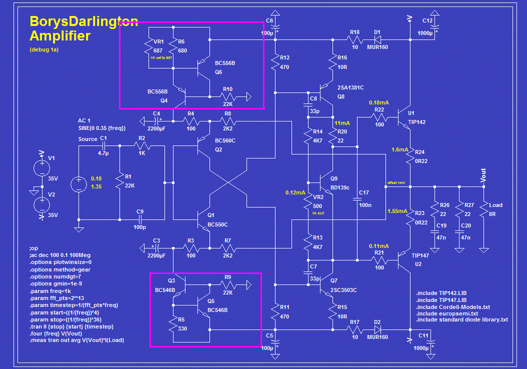

Hi Boris
Here is a modified version which simulate very good to.
I'm not sure if the VBE correct I mean if is good enough to take care of any of previous thermal drifts.
Please take a look.
Of course I appreciate your comment and help!!!:)
Greetings

post573
R20 is the Hawksford/Hagerman/Self added resistor to compensate the Vbe multiplier for variations in multiplier current.
As such the tappings to feed the next stage are connected to the emitter and collector of Q9.
The sch shows the upper tapping connected to the wrong side of R20.
C17 & R22 should connect to the bottom end of R20.

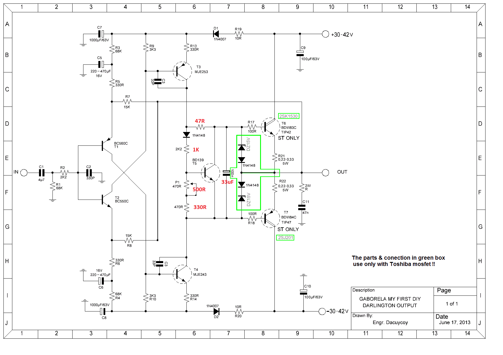

Hi Borys
We need your help with the Hawksford/Hagerman/Self added resistor R20..
How you can see Andrew wrote that is incorrect.
Would you please take a look...........
The first circuit how you implemented originally, the second how I understood Andrew's advise.
Thank you :)

The Andrew is correct. The R20 resistor role is to improve bias thermal stability.
As far I remember I was not using that resistor in this amp (maybe I have short memory).
In my EF3 OPS this resistor was indeed improving the thermal behavior but it was also causing OPS oscillations (in that case it was not a good idea).
Remember that You can also adjust the thermal compensation by changing the R14 and R13 values (they go in parallel with bd139), or plan B is use mje340 instead of bd139 it has lower tempco.
BTW the R14 and R13 network was for the IRF Vbe, here the value of R13 will have to be lowered to get the OP transistors biassed up.

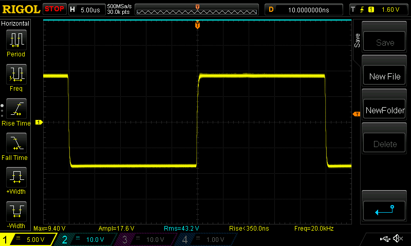

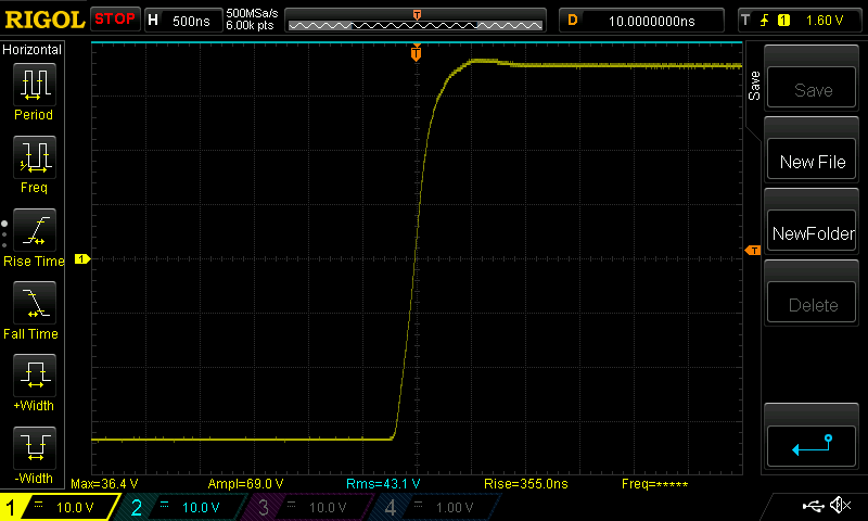

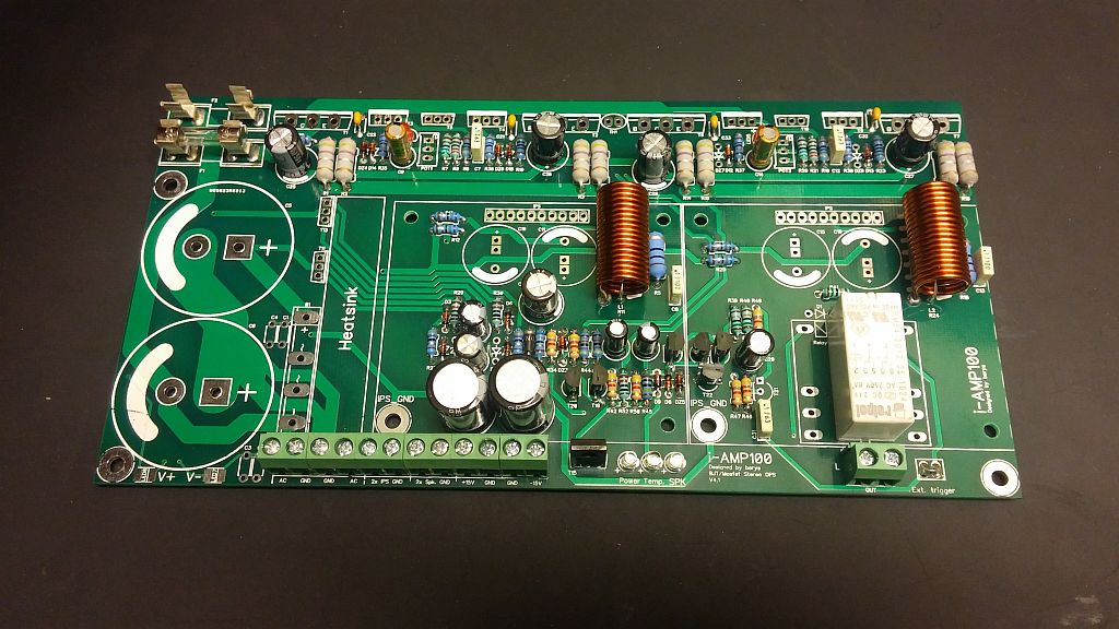

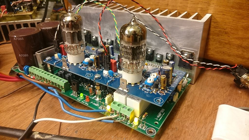

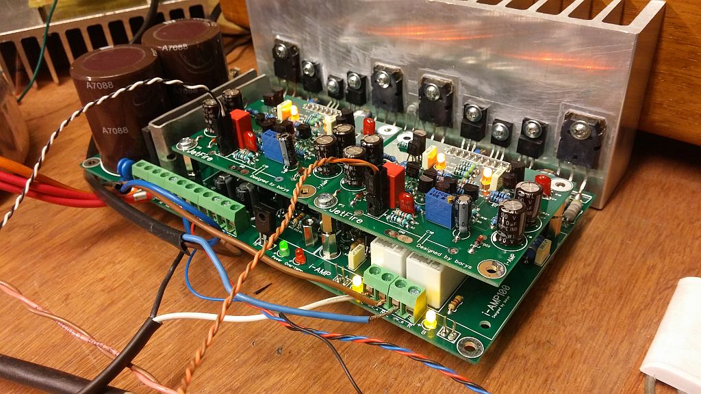

Now the new version is comming --> iAMP100. The stereo OPS unit for single pair transitors, just transformer is required.
The board will ''take'' on board BJT and the Mosfet transitors, board has:
-main PSU
-preamp PSU +/-15V with short circuit protection
-speaker DC protect
-over temperature protect
-speakers 10s delay ON
-speakers fast OFF -->after trafo is switched OFF
-you can use single relay or two separete relays
-BJT or FET-hex output transistors
IPS boards are 60mm x 70mm which is enough to fit in most of the simple amplifiers (including sony ta777es if you will have a parts :D ).

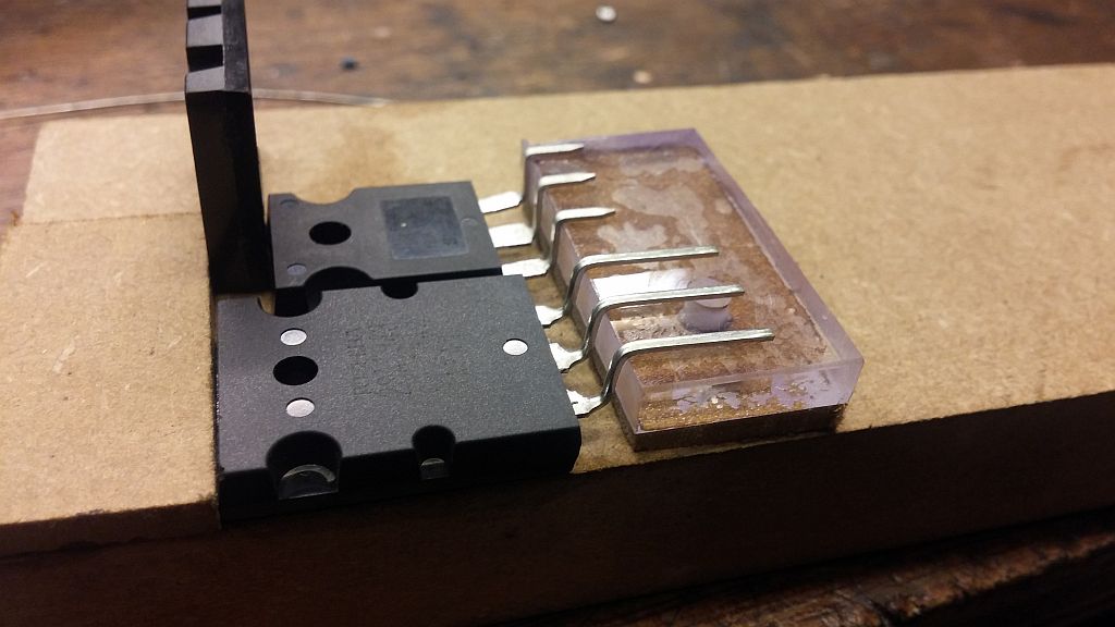

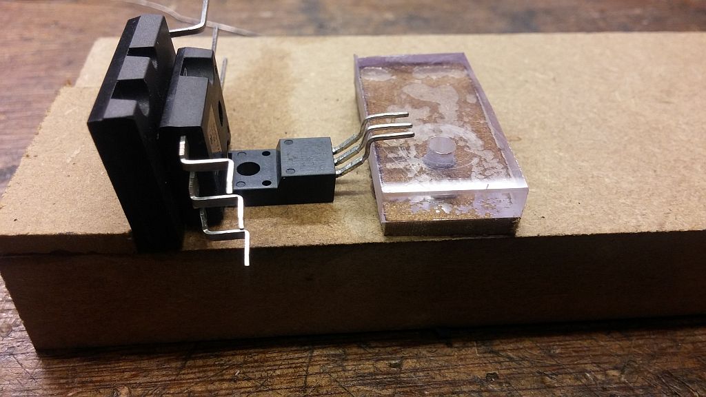

The special tool will help to bend the transitor legs :D (spacers distance is 30mm)
