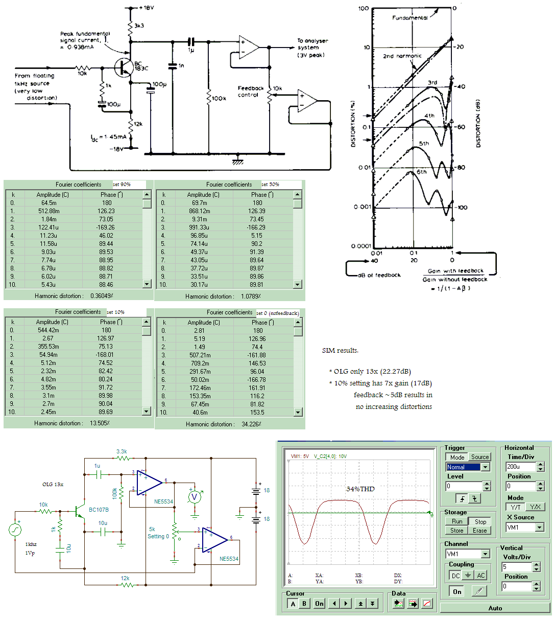

Feedback affects Soundstage, Imaging, Transients ?
This sim from Baxandall based test. Here is no increasing distortion caused by lack of feedback, that probably shows baxandal's setup are wrong in opamps or may be his generator doing wrong. 1nF at collector also doesn't make any significant changes.
Any clue?

Baxandall's paper "Audio power amplifier design" which seems currently not to be available on Jan's site :
http://www.google.fr/url?sa=t&sourc...sg=AFQjCNHmQv6qAwdMmjV0GztYsHv2c4toQQ&cad=rja

Try to use sometimes old, well kown (and mostly neglected) Baxandall diferential test with normal complex music signal to verify such claims about "audibility" of those tiny effects and real ear ability. I did.
