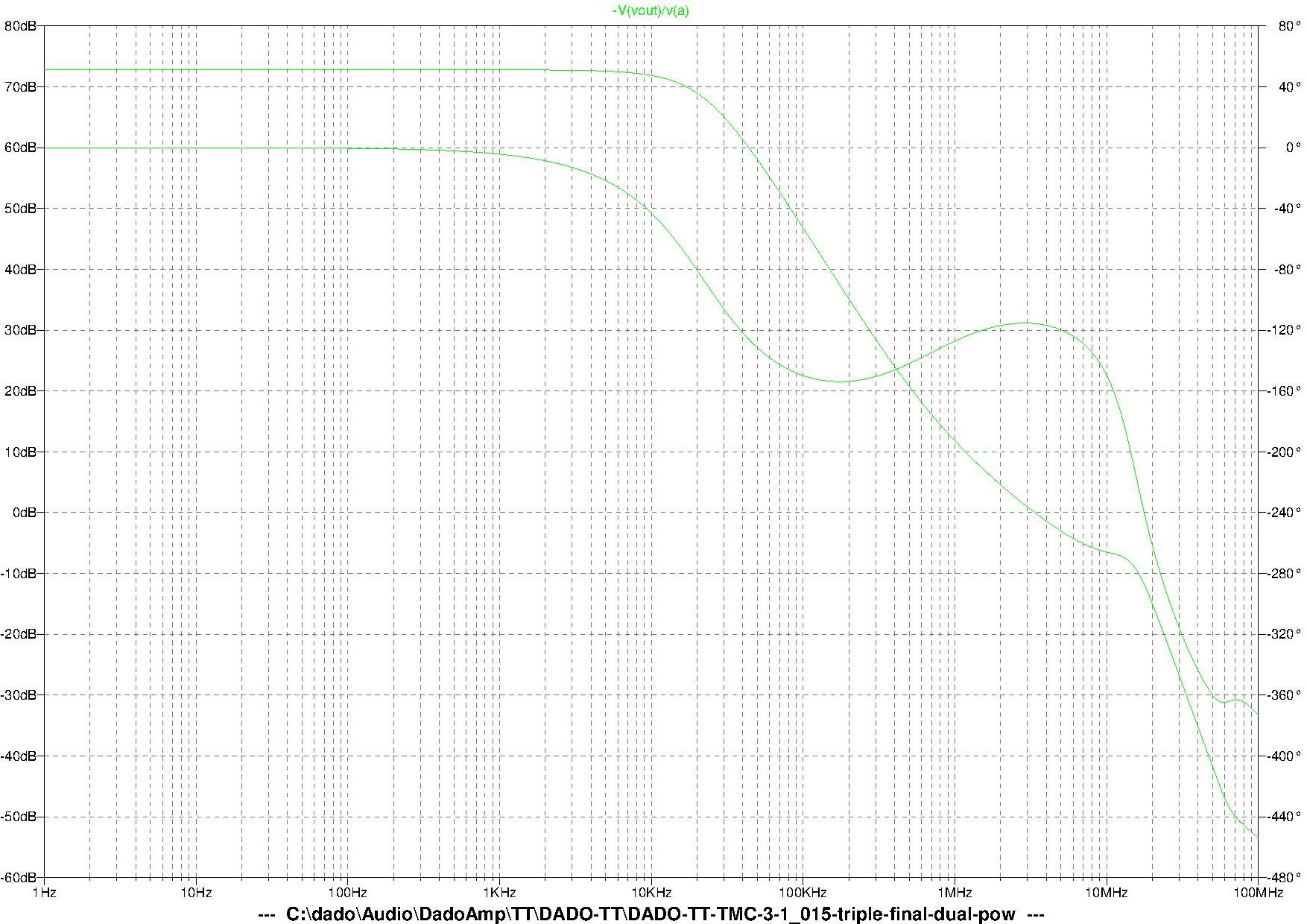

What is your opinion about this Open Loop Gain diagram, it could use 40dB of NFB up to 20kHz?
dado
dado
It wouldn't have a lot of phase-marging !!!
Regards
Charles
