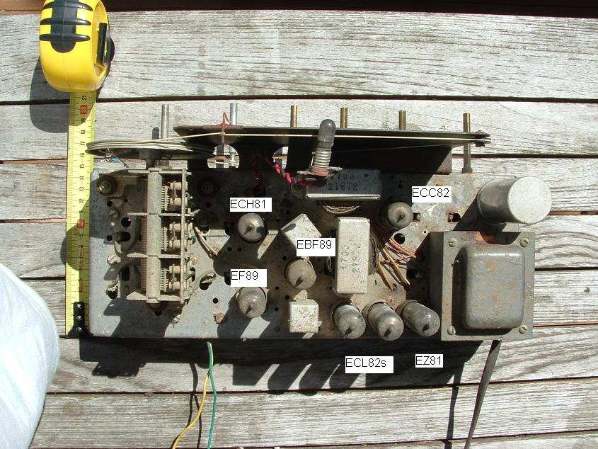

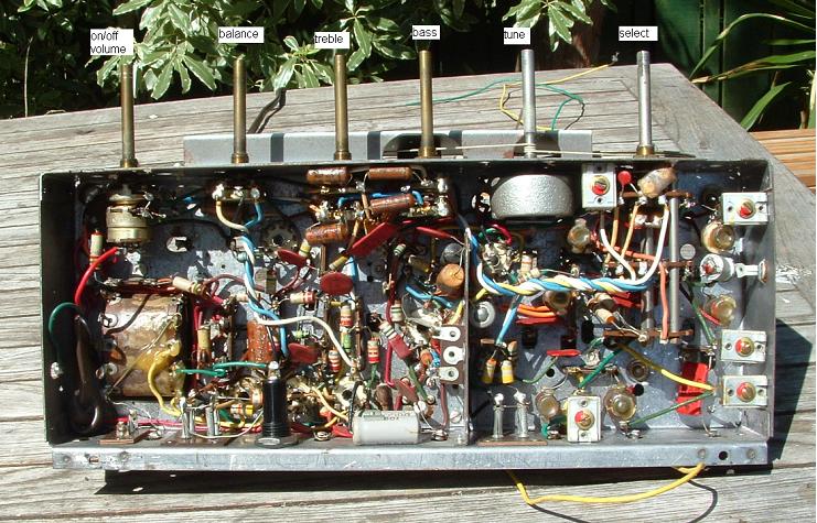

Got an old console today. Now my normal approach has been to gut the things completely, pull the usable tubes, remove tx's and throw away the rest.
But this week at work I've felt the need for a little desktop amp that glows. So this ECL82 SE item looks like an ideal candidate for rebirth.
Currently it has MW and SW in the tuner section. That will all go - I have a good Technics tuner that will plug in to provide that side.
Inputs will be needed for the computer and maybe (later on) an i-pod dock.
The chassis will stay as it is (although I may clean it!!). Obviously it needs a full re-capping, and I'll probably LED bias the triode sections and LM3x7 bias the pentodes. The cute-sy opt's are 4ohm output, so lots of speaker options to consider too...
I'm thinking a nice oiled timber box with a mesh grill front and rear - a cross between a Tivoli radio and a Marshall amp.
Anything I've missed considering?

Those heavy tuner flywheels (sans the big pulley) add a really classy 'feel' to a stepped attenuator. I used one as front panel bearing/shaft, so I could mount the attenuator at the inside/back near the input circuit, with an extension shaft rigged between the 2. Worked beautifully with a big volume knob.

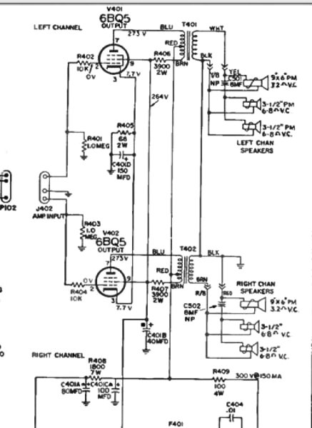

On some consoles the B+ went into a tap partway in from the end. The longer end went to the plate and the shorter to the screen. The idea was for the residual hum in the PS to be cancelled in the OPT. Don't know if you could swap connections for UL or not.
e.g.
attachment.php
I suppose you could check by disconnecting and measuring DCR from each tap to the others.

On some consoles the B+ went into a tap partway in from the end.... I suppose you could check by disconnecting and measuring DCR from each tap to the others.
Thanks Mike - I haven't seen one like that down here but I will check it out - cheers!
