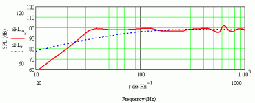

All right. I let myself in for it didn't I when I suggested in that casual way that you should design a horn -it wasn't really fair. You want a horn for that first Monacor? SPH-390TC wasn't it? OK, I'll do you a scoop-bin. Should work with a few drivers, that's one thing scoops do well.
Back shortly.
Back shortly.
OK, here's the basic idea.
One J-bin / BVR scoop-bin horn for you using the Monacor SPH-390TC. The cabinet is 19in wide x 24in deep (internal). The chamber is 20in tall, and at the bottom, 17.25in deep (I'm assuming 3/4in build material here). The throat at the top is 2in to the rear and top panel, and 6in deep at the bottom of the chamber. The strike-plate starts 8in down from the chamber, and ends 6in back from the horn mouth, which is 22in tall. See attached very rough layout. If you hate Imperial measurements, just use a convertor or even Google to change to metric (shudder).
Did you say you wanted bass? Flat to 35Hz, in-room F10 25Hz, before room-gain is factored in. Excursion 0.5mm (total) down to final cut-off, so isn't really an issue as the Monacor has 7mm each way to play with, and it's nearly 100db 1m 1w sensitive already, so it will go mind-blowingly loud, without distortion.

It's really flat, especially compered to a FE206E in a horn, why? it's because the monacor has an higher qts?
I was thinking that because I didn't expect to be so flat, crossover would be difficult. After I calculate the response of this woofer in free air if it is almost flat will be easy to cross.

Just natural talent on my part really... (Cough. If you believe that you'd believe anything. )
It's mostly that the drivers are easy to work with -big cone, big motor, decent suspension, and that scoops / BVRs like this tend to be flatter than a long-path design if they're designed right.
