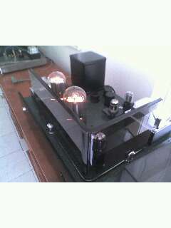

the_manta said:Currently it's the EL38. I made many experiments with this tube and now I'm building two monoblocks.
Here two pics, The Frame for the chassis isn't ready yet.
I love uncommon tubes and love especially uncommon circuits for them !
Tubes like the above mentioned EL38 or the EC8020 and many others are my passion (I'm not keen on talking about that all, because then the prices will explode and everybody wants them. Happend all to often ! Example is the EL509/EL519/PL509/PL519. A few years ago you could get them cheap at Ebay, a few bucks for a couple. And now ? Just look !. All because a few guys published their High-End Amps with this tube. And of course it is labeled with that stupid DIamond, even it wasn't manufactured by Tele...)
Also I love strange circuit Ideas, like a full bridge, a single ended circlotron or the so called "Accordion Amp".

I tested the EL38 in maaany ways in my wild-looking test circuit here:
The EL38 is connected as Pentode. I like fast neutral sound with the hard and powerful bass. And actually I wanted a pentode Driver, a EF40, but had many problems due to the high internal resistance of the EF40 and the feedback. I tested maaany ! Bootstrapped EF95 with a EF80 cathode follower...sounden terrible. EC88, sound wasn't bad, but I built a transmitter at 4Mhz.... EC88 was hard to get silent and the amplification factor was too low. Finally I ended up with the 5751, systems in parallel. Sound is nice, not the sloppy Bass of a SET Triode with no Feedback.
Since you speak german, it's easy for you to read the story here:
http://f23.parsimony.net/forum45451/messages/185216.htm
SO far my Experiences are good with the EL38 on the Hammond 1627SE trannis. Huuuge deep bass, very neutral midrange (not these beautiful lovely mids which get boring after a while). The highs are a veeery little bit weaky, but thats typical for the big rugged Hammond output transformer I have no problem with that.

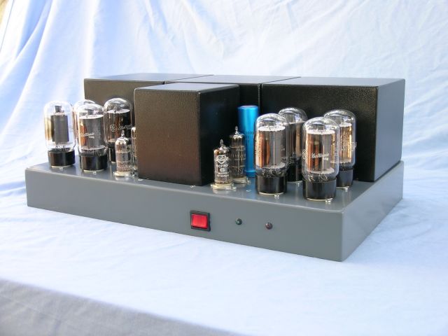

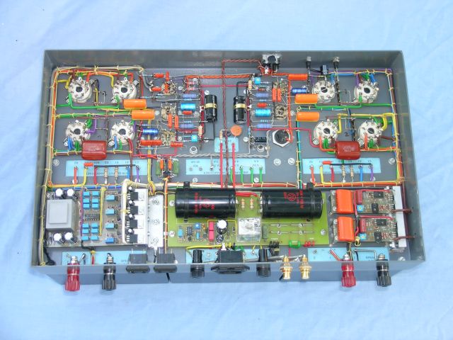

Since it is Christmas time and other pictures have appeared (some pretty neat jobs there!) I will try with mine:
