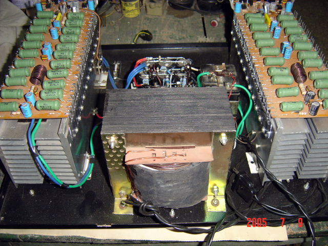

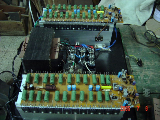

I have completed both channels of my amp now and am posting some construction pictures , at present there are only 6 x 10,000 mfd caps , I will be adding another 6 after I get them , you can see size of heatsinks , there are also two four inch cooling fans running at full speed which I have fitted in the back cover hence they are not in the pictures ,

Now after seeing the pictures I hope you will be satisfied with the cooling arrangement , also there is no insulator between the output transistors and the heatsinks , the heatsinks are the rails and the same have been insulated from the chasis .
Worst case tempratures in Indian conditions are not above 35 digrees , at least not in my city , I think you have in mind the tempratures quoted by Ampman who lives on the SUN , I think???? .
The Leach Amp design is very stable even below 1 ohm , I have one working at 1 ohm since over a year and no problems , this is why I love the design , if you like I will post a pic of the same too .

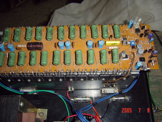

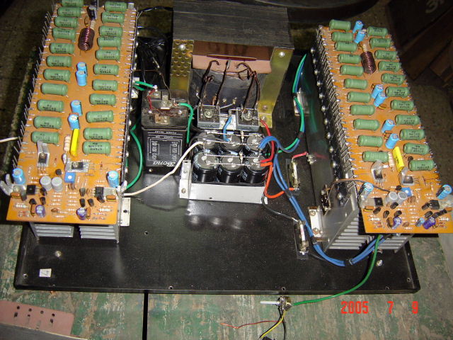

Rajeev,
1) Looks not too bad.
2) If the Sinks will have a fan, then they look adequatly sized.
3) The power supply seems a tad anemic (unless you have a second trafo/ cap bank in the empty space yet to be installed)
4) If it were me, I'd use about 80,000uF for this amplifier per rail or 160,000uF in total if you want to hit the power levels you wish for. (Less will work too but at reduced power into music).
5) In the US we have 120v but higher current rated mains. In India, I reckon with all the rapid growth going on, keeping a steady 220v might be challenging, let alone keeping 220v with the amplifier running at full power... this is just a thought, you probably know better.
6) If you ask me, you will probably not hear the difference between 1200 watts and 1400 watts so I'd go with a reliable amp than a hi-powered version perhaps prone to break-down.
7) Probably too late now? But All your transistors are mounted at the top of the heatsink. Don't shoot me down for this, but I think heat travels up better than travelling down a heatsink, just consider this when testing the amp. The last thing you want to happen to your amp is it thermally shutting down during a performance.

Hi K-Amps,
Sorry for the late reply , my internet connection had expired but it is ok now
Yes I will be adding another bank of caps ( I have to get them from Delhi
or Mumbai they are not availible locally ) You recomended 80,000uf per
rail , will a 35A bridge rect handle the initial charging current of such high
value cap banks ? .
Yes the voltages do vary with load , specially when we do outdoor events
where we have to get a temperory connection .
With cooling fans it does not matter if the devices are mounted up or
down , and fortunately the temp of the heatsinks is not going too high ,
there is NO provision for high temp shutdown in my amp , it will be only
required if the fans fail , this is the reason I have used extra large
heatsinks so that the amp will silll work but hotter , and normally we see
every time if the fans are on , further it is a DIY amp , I have done more
than my competancy but thanks for the concern you are showing .

...........I think heat travels up better than travelling down a heatsink............
Hi K-amps ,
You should have elaborated more on this.
Heat goes up or down through metal at the same rate. However in a heat sink the air flow is upward and That affects the heat transfer. But if you look at it closely , since heat transfer is greater when the temperature difference is larger , the bottom section should have better heat transfer ( be cooler ). As the heated air travels up its cooling will reduce as it is now hotter than at the bottom and the top of the heatsink should be hotter than the bottom section.
If a fan is used this effect should be less , the difference in temperature being less with increasing air flow.
So transistors mounted lower than mid way seems to be OK.
Sounds OK ?
Rajiv,
If your heat sinks are placed like in the second picture with the pcb on top , your heat sinks will be less efficient. Even without the pcb on top the fins in a horizontal position will cool much less than if they were vertical and followed the natural flow of air.
Remember you did consider the possibility of fan failure and the need to operate the amp under that condition also. In any case two fans is a must to ensure 'some' air flow even if one fails. Both fans failing at one time is a remote possibility . A set of fans cooling both banks of heat sinks with redundant power to the fans might be a safe thing to do.
