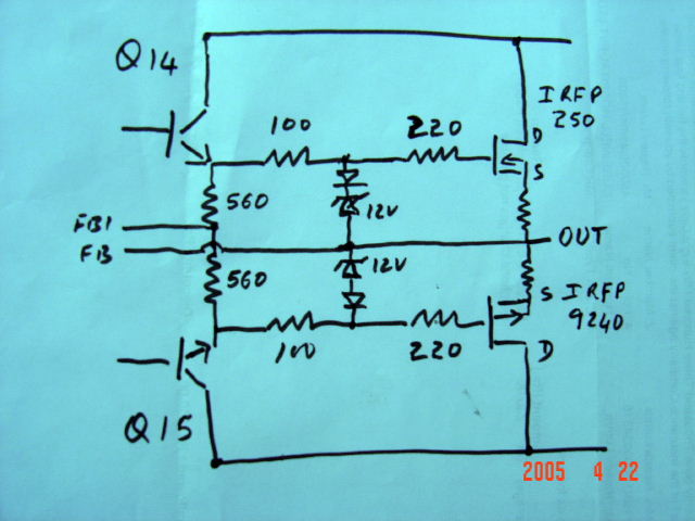

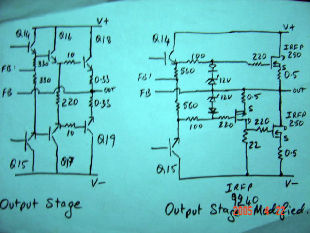

Don't fret. The toroids were made for me with absolutely identical windings with 5% regulation and it worked a treat. No ill effects as sufficient and equal impedances.
Rajeev,
You will need to increase those 330 resistors from 220 with 2xVbe to Vgs of maybe 4V i.e. more than 3 times 220.
Also 2.5A is at zero crossing on you rail voltage unless you're well into pulse region.
The output stage is wasteful as Vgs at >6V on will lose output. If you used a CFP with gain you would only have Vds at 2V or less. But you need complements. Sometimes cheap is not so good.

Rajeev,
seems to me a good idea to switch to Mosfets, given your requirements.
Especially if the IRFP250 price is that low in India.
What i do not understand is how you will use them for a push-pull design ?
Complementary matching of vertical Mosfets is quite bad, to me it looks that these high power Mosfet types are generally good for single-ended use only.
You intend to use IRFP250's on both sides ?

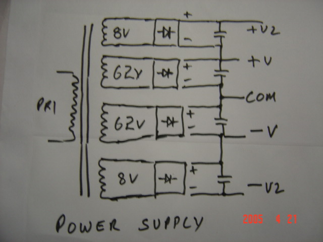

I am trying to use the IRFP250 because of their availibility and good specks along with low price , I just took parts from different designs and added them , if they work there , I do not see why they should not work here , I will make a model with two output devices and see .
here is the power supply
hello paaji
Hi Rajeev,
I am afriad that the output swing will clip asymmetrically.
The positive side will clip near rail but the negative side will remain 3-4 volts lesser than rail, Although you have used seperate supplies for VAS and output stage, but the lower P-channel mosfet will enter the band-gap mode thus restrict the negative rail swing upto the rails.

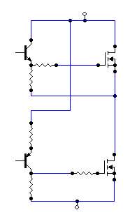

Ampman ,
The output stage is from the Zeta , if you see carefully , the output stage
is symetrical , at low levels the output in the -ve side is from IRFP9240
only and as the power increases the IRFP250 take the load ,
to simply explain I made this diagram , see in attachment
