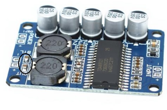

Its the first time I will mod a class D amplifier. I am thinking of replacing the input and output ceramic capacitors with foil ones. But with smd applied its difficult to recognize what exactly these ceramic capacitors are. I think the output capacitors are the ones I marked in the picture. Can you please help me what these capacitors are on the board and which values I should use?
Besides I am thinking of synchronizing the clock of the chips, but with the datasheet of the chip this is pretty clear.

I don't know that board, but if the inductors are 22uH then its likely the caps follow the datasheet for that inductor. Perhaps your board deviates from that - hopefully someone with that board can answer definitively. What does the datasheet say for a 22uH? What impedance are your speakers? Class D output filters can be optimised for a known impedance.

The SMD capacitors you have marked are the output filter capacitors. With 22uH you use 680nF. You may use 15uH and 1uF instead (optimized for 6 Ohm).
On DIYBudgetAudio.com, in the article "TDA8932 based class D amplifier", you find an example of "mods" based on this board. The input coupling capacitors are replaced with foil capacitors, but you may need to cut a PCB track doing that.
Thanks for your replies. I found that example but the picture is not clear how the connections are made. Moreover the output smd capacitors still seem to be there, are the foil capacitors added additionally?The SMD capacitors you have marked are the output filter capacitors. With 22uH you use 680nF. You may use 15uH and 1uF instead (optimized for 6 Ohm).

The input coupling caps are to the right of the IC in the photo you posted. Definitely replace them with the best you consider reasonable for the project - they should be 1uF.
You circled the output caps (680nF?) and it's good to replace them too but it won't have as much of an obvious effect as the input caps.

I'd not recommend such a mod. Based on my own experience with TDA8932, the input circuitry is highly susceptible to RF pick-up. The smaller surface area of SMT ceramics is an advantage, changing to (physically much larger) foil caps is going to make the amp much more susceptible to RF pick-up.
Would it be better to remove the smd input coupling caps on the +ve input, replace them with smd ferrites, and then add the coupling caps off-board? Obviously, not replacing the -ve input coupling caps with ferrites as this would short the DC on the input to ground and puff the magic dragon.
