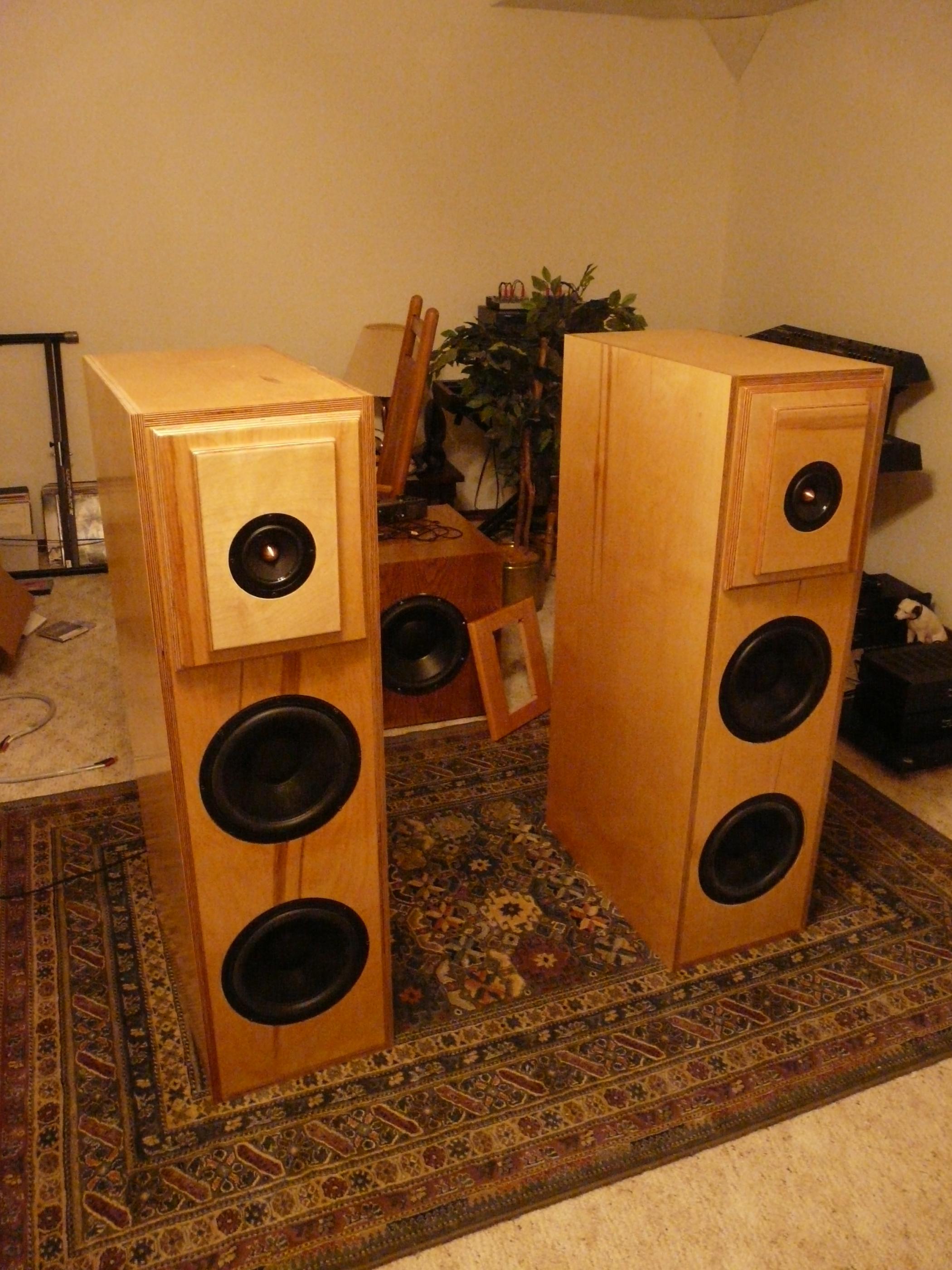

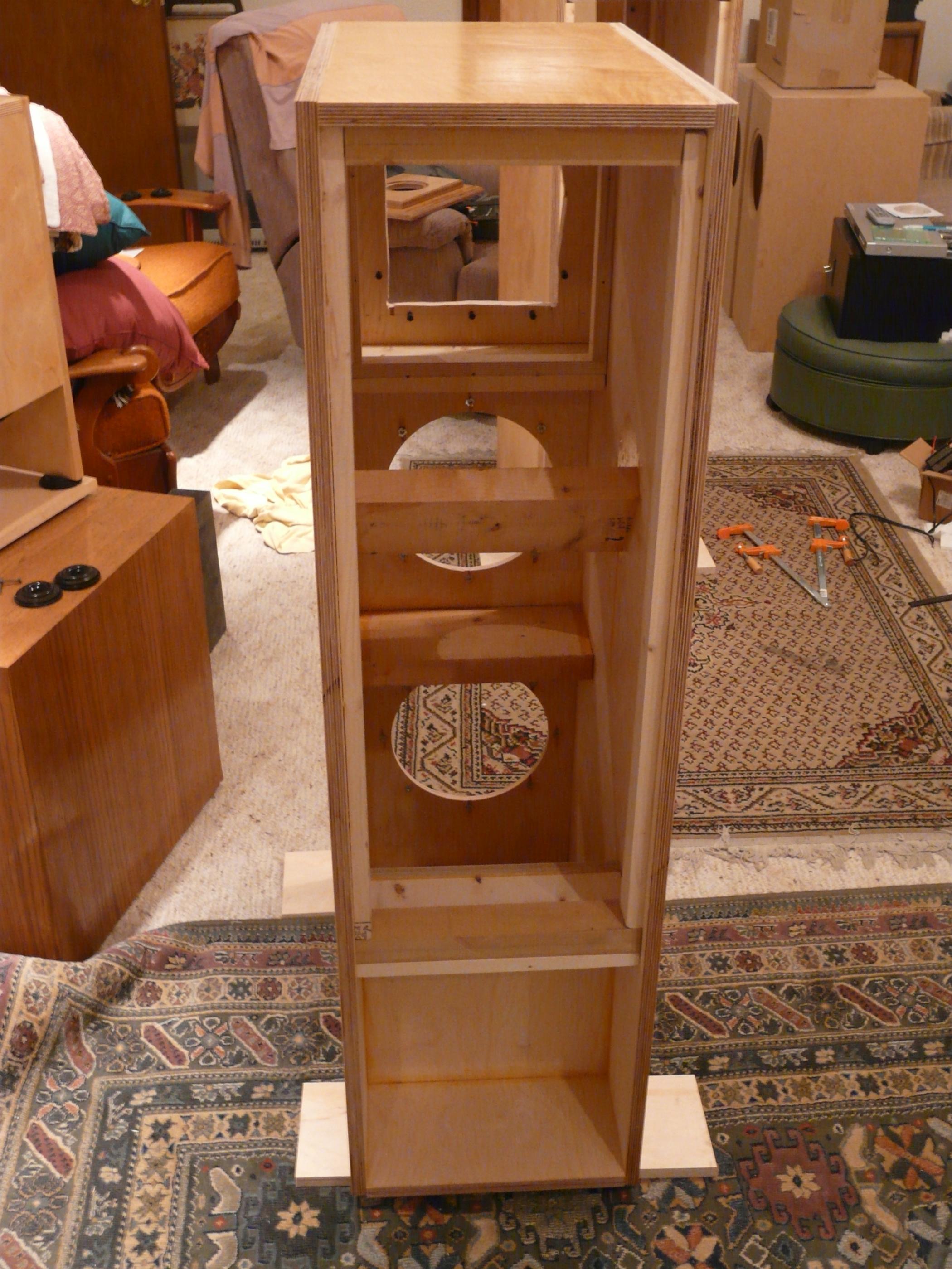

Initial testing of 830668 drivers
Initial results on a bass system using 2 10" Peerless 830668 woofers per side in a 190 liter cabinet (yeah, they're big muthas) are pretty good, definitely encouraging. The drivers have almost zero break in time and reach comfortable into the lower 20s (in-room) without consideration to room placement, yet. F3 is around 30hz, F10 seems to be a bit below 20hz - this is in-room response, YMMV. The bass system uses different crossover points for each driver: 100hz 1st order (for the lower bass driver) and 200hz 1st order (for the upper bass driver) with the intention of crossing into the FR driver at a point above 200hz. Predictably, there is a bit of a rise from 40hz to 70hz. Not objectionable, but there and pleasantly so.
No problem with dynamics. I mean REALLY no problem with dynamics for my listening preferences (classical music). Nothing is breathing hard at all.
And all this is without break in on the woofers.
The stuffing in the box will be adjusted to smooth the response, but it's really close without much work. The boxes are maybe 40% - 50% stuffed with Bonded Logic Ultra Touch R13 insulation, not really teased much. Gotta wair for break in before doing much.
I'm not currently using a Mark Audio driver for the FR, but even with a lesser fr driver the results are pretty good. I'm going to let the woofers break in for a couple of days and start real measurement and tweaking.
Considering the sensitivity of the driver I'm currently using, an Alpair 7.3 should work well with just a single cap for a crossover at about 400hz. The Alpair 10.2 should work crossed over a little lower with a 20 - 30 ohm resistor across the driver leads. YMMV. (Maybe a pair of Alpair 7.3s or 10.2s will magically appear on my doorstep for testing in this arrangement. :eek: )
Another pair of boxes have also been build for a single 830668 driver, but I'm not sure when I'll get to that.

The attached pictures are of the bass system under test. The full range drivers are currently CSS FR125SRs which will be replaced, probably with Alpair 7.3s.
Even after 40 hours of break in, the woofers are still changing. Change for the better, but still changing.
