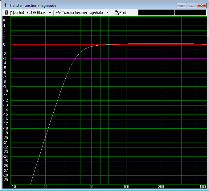

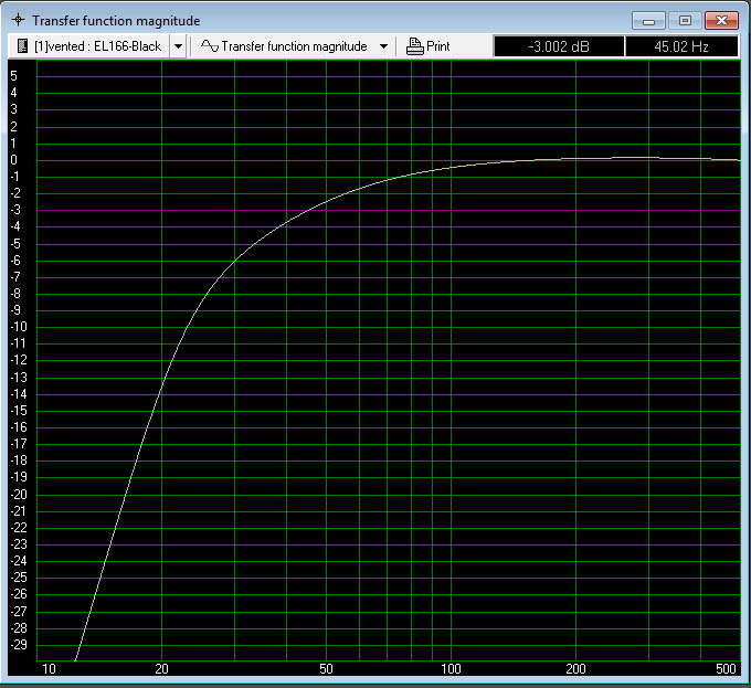

Thanks - I just tried WinISD - f3 is 45 Hz or 35 Hz for 30 ltr?
Dave and experts, a few questions on how to go about building this box:
1. Should I line all inside panels or only top, one side wall, and back wall for the woof box? Any fluff I need to put in?
2. Do you advise any particular dimension/ratio for the box (as long as I keep total volume the same)?
3. Any need to flush-mount the EL166?
-Zia

If I choose 28 ltr which is about 1 cu.ft., I can go for 12" x 12" x 12" - IIRC there's a design for SDX-7 done by Dave which is like a cube... but these are all even sides. I can keep volume same and do 14.5"x12"x10". The port length is roughly 8 inches.
