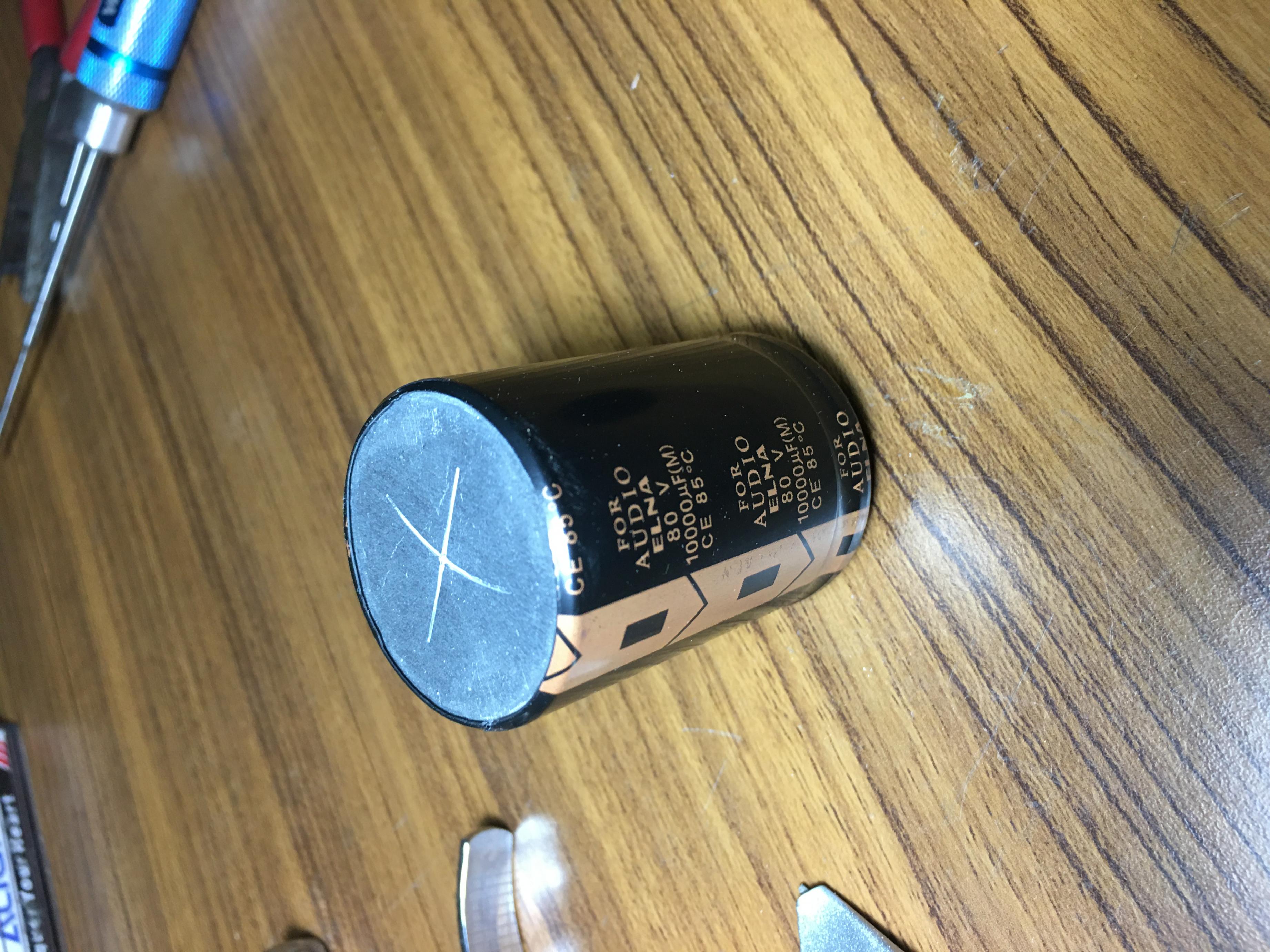

Fake ELNA LAO 10000uf/80V from E-Bay seller

Every time I look at eBay for large electrolytic parts, the prices are mostly significantly higher than known, established distributors, at least for parts that look less suspicious. Notice how those Elna “for audio” had no date codes.
So, pay more, get possibly fake, or old stock, and wait for weeks to receive something that’s maybe not quite what was “in the picture”.

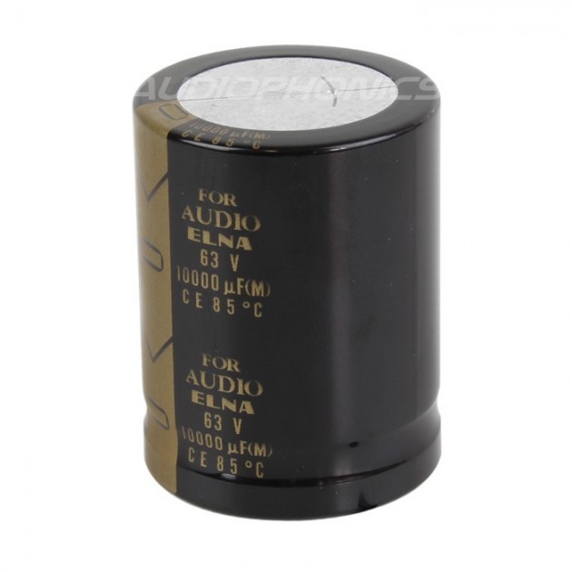

These ELNA 15000/63 were received by a relative last week from Audiophonics.
ELNA High Quality Electrolytic Capacitor 63V 15000mF - Audiophonics
Intrigued by the comments here the top black plastic cover was removed and it looks like this. Clearly not the "sword" mark.
All other parts sold there look genuine but this seems to be fishy? Any other experiences?
Elna's factory markings is a straight line with a curve line cutting across.
The + markings on your cap for genuine caps belongs to Nichicon
I have a number of different known genuine ELNA caps obtained from Digikey. All exhibit a straight line from end to end and a shorter curved portion that is offset from center. So, several things wrong with photo being posted. Line is not end to end, the curve is not offset from center, and the curved portion is too long, should be about a third of the diameter of the cap. That cap is not genuine ELNA.

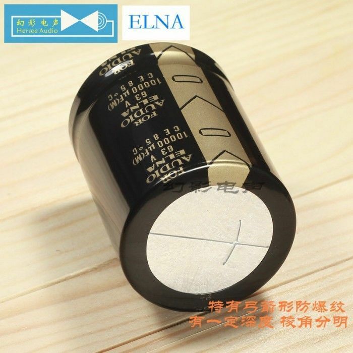

It’s been established that most of the larger capacity snap-ins for power supply filtering are not genuinely branded. It is difficult to even find them for sale, but I attach a photo of what has a high probability of being a genuine ELNA, though you may not get what is in the picture when your order arrives. In addition to the previously mentioned features of the top, note how the indentation is thin and very clean. The fakes are crudely stamped, being wider, deeper, and bulging. The larger capacity ELNAs are always made in Thailand, though it may not state that on the cap.
