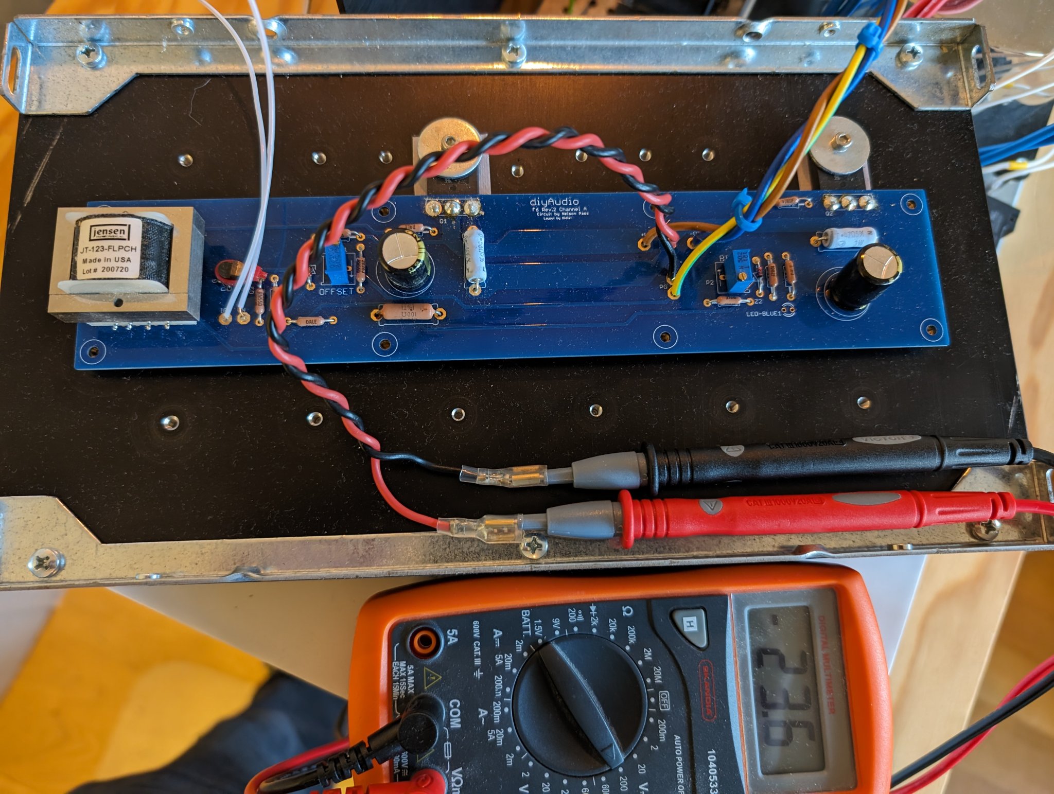

@Ben Mah thanks for your help so far, checked the measures at first startup it seems to be OK Q1 at 4,4v R2 at 500mv and Z1 around 6 with an offset of 0.9 mv, it stays stable (for 2 hours)
When i turn the offset pot to adjust the offset output, the output will be -24v. is that the offset pot what maybe need to replaced?
So it was operating properly at startup, with good current and offset. I assume the Q1 at 4.4V is Vgs.
When you turned the offset pot and offset went to -24V, how much did you turn the pot? And did you check Q1 Vgs? And R1 voltage?
A small change in the offset pot should not turn off Q1. Measurement of Q1 Vgs as you turn the offset pot may give some insight into what happened. Turn the offset pot slowly and in small increment in one direction and then the other direction and note the Q1 Vgs and R1 voltage changes.

2 nov - Now the next day after power up (nothing changed in the config):
Q1: 1.77
R1: 0.440
Offset: -23.6
Adjusted the Bias anti-clockwise to increase the R1
Q1: 2.29
R1: 0.503
Offset: -23.6
Adjusting the offset anti-clockwise or clockwise (for 5 rounds) the offset measure is still -23.6 the Q1 is at 2.29 and not moving.

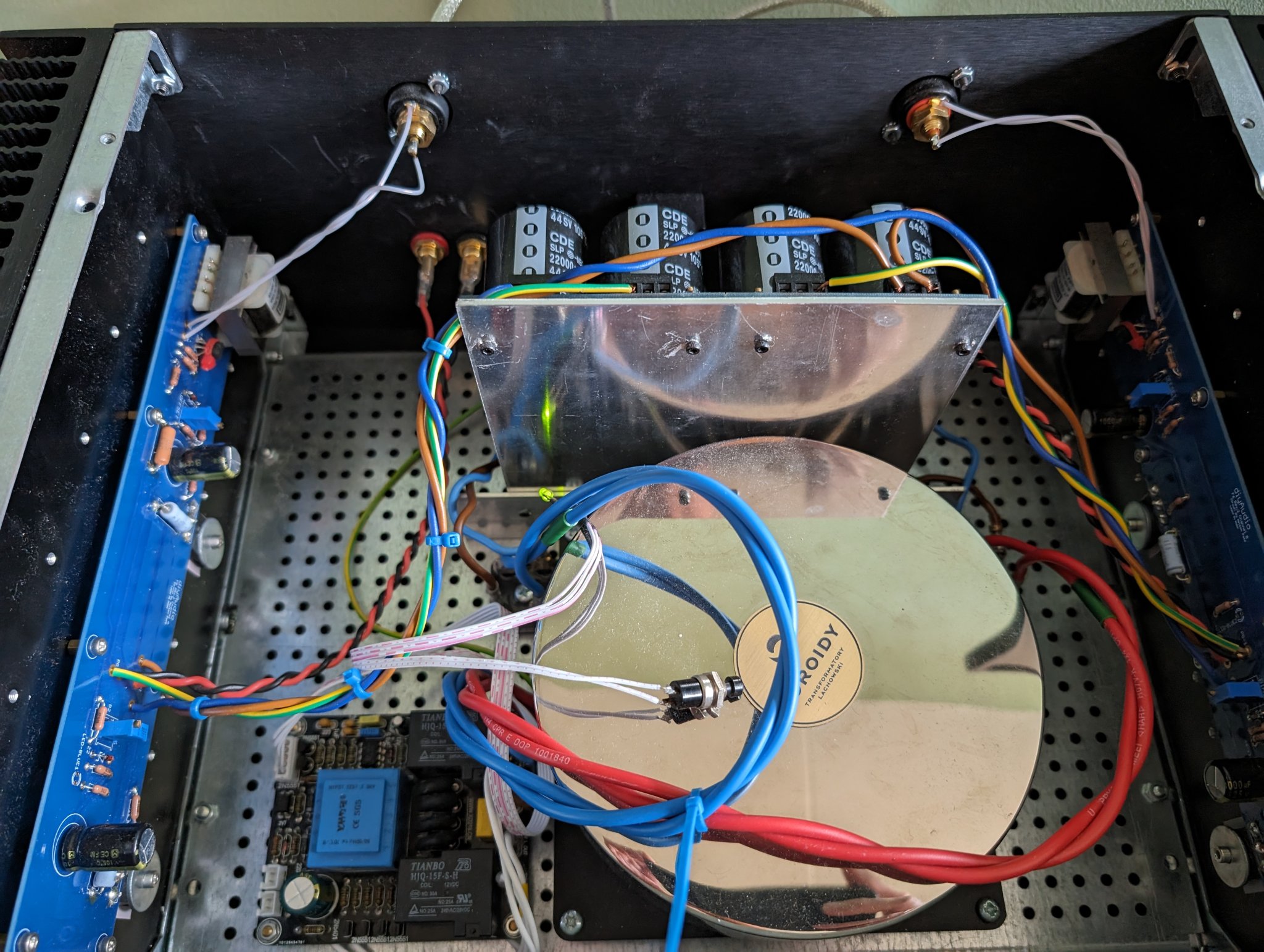

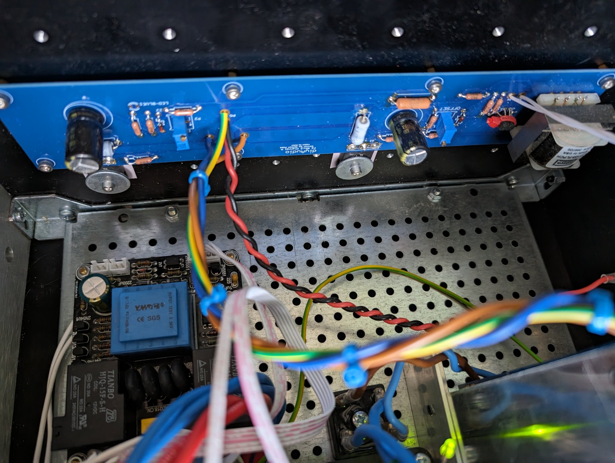

Hello Donaldspace, thanks for the tip, after my last post I removed the board from the amp and resoldered the back and soldered the front.
And I think you are right one resistor and R1 maybe has not a proper connection. Maybe after all the measures (and bad soldering).
I attached the board to the PSU again and going to run some tests.
Back again, the values are staying stable now Jeej, only the output seems to be off of 10 too 12 decibel.
The values are on both the boards 468 mv at R1, only one channel give a lower output.
Things i tried:
Attached some photos of the board and the overview.
Any ideas how to troubleshoot this?

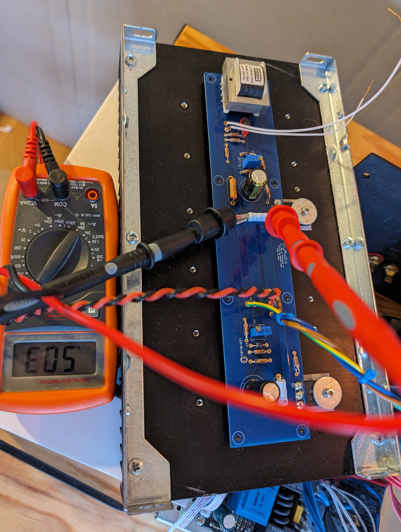

R2 is nice 0.503 when i adjust it increase or decrease. Q2 stays on 0.021v after adjusting the p2 or p1So some good news and bad news.
Looks like the low output issue is resolved.
The bad news is that you may have toasted Q2. What is the voltage across R2? Does the voltage across R2 change as you adjust P2? What is the voltage across Q2 gate and source? Does that voltage change as you adjust P2?
So R2 measured 0.503V, and adjusting P2 caused it to change? That is good because then current is flowing through Q2 and P2 is working to control the current, although previously (post #4,810) you said that the offset was 20V, which is a sign that Q2 was not conducting.
Measure the offset again, and make sure that the black probe is at Ground and the red probe is at the speaker output, and note the polarity of the measurement.
Where at Q2 did you measure 0.021V?
Also please be concise when reporting. Always include unit of measure (V, mV, A, mA, etc), and state what you what you measured and what you adjusted if adjustment was made. Example of what not to say, "R2 is nice 0.503 when i adjust it increase or decrease".
Since you are getting voltage at R2 and P2 adjustments seem to be working, then what is the voltage across R1 and and does that change if you adjust P1, and what happens to the offset. And does Q1 Vgs change if you adjust P1, and what is the value of Vgs

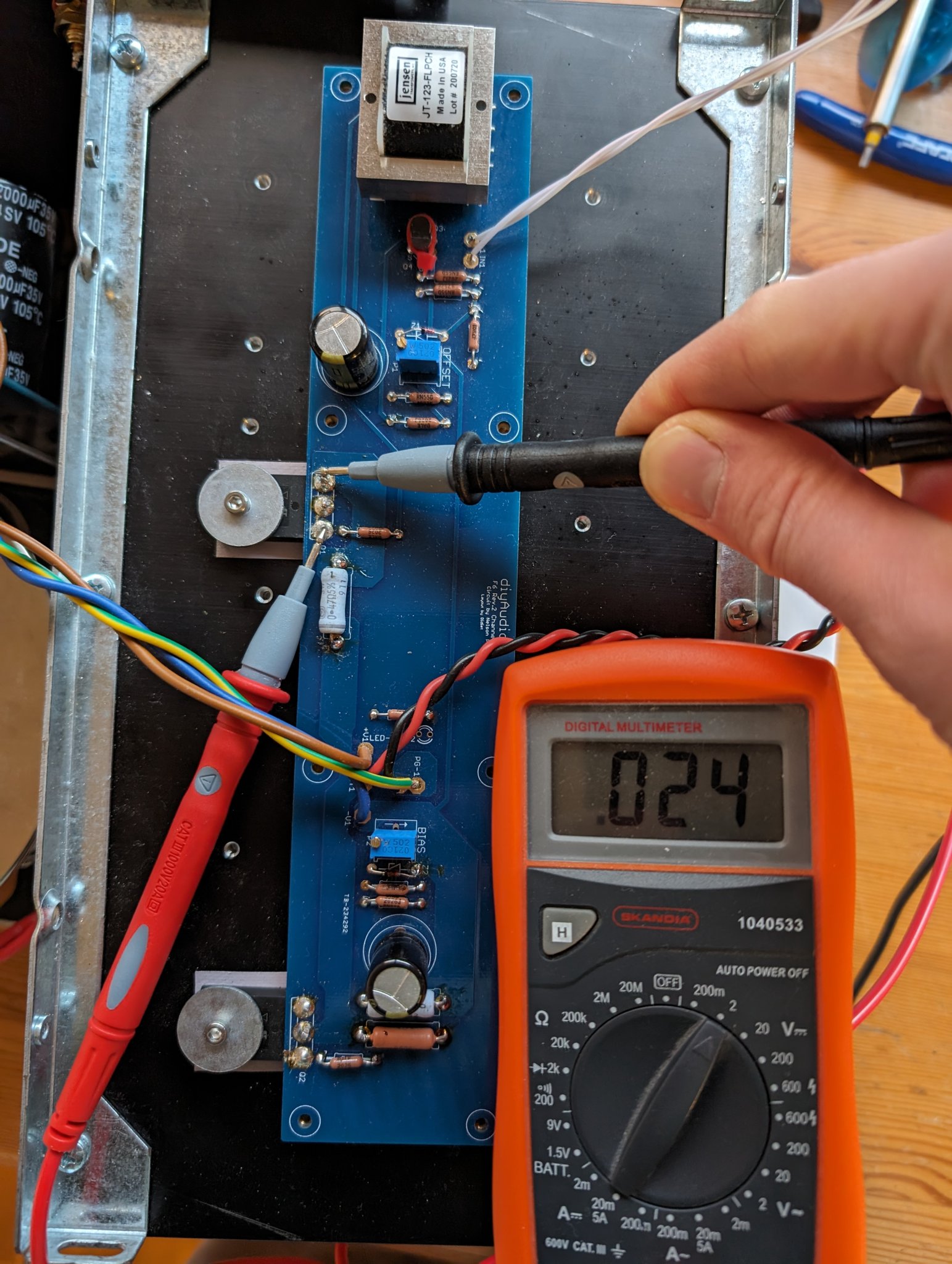

Hello Ben,
Thanks for your help so far, sorry for the lack of measurement information and i think i supplied wrong information. Q1 is damaged instead of Q2.
Give it a new try here, measurements are after 15 minutes on board with a low voltage on Q1.
Measurement 1 (no adjustment made):
Offset: -20.2v
R1: 0.475v
R2: 0.470v
Q1: 0.024v (black probe on the gate and red on the source)
Q2: 4.29v (black probe on the gate and red on the source)
Measurement 2 (turned P1 anti clockwise):
Offset: -20.4v
R1: 0.475v
Q1: 0.024v (black probe on the source and red on the gate )
See the video of R1 and adjustments of P1 and P2.
Hope I am complete with the measurement.

There is definitely something off with Q1. Do you have another mosfet for replacement?
Remove Q1 and before replacing it, power up and check the voltage across the zener, Z1. If it is a 5.1V zener, it should measure 5.1V +/- 5%.
By the way, when you measured the mosfet Vgs, if you had the black probe on the gate and red probe on the source, the measured voltage should be negative.
