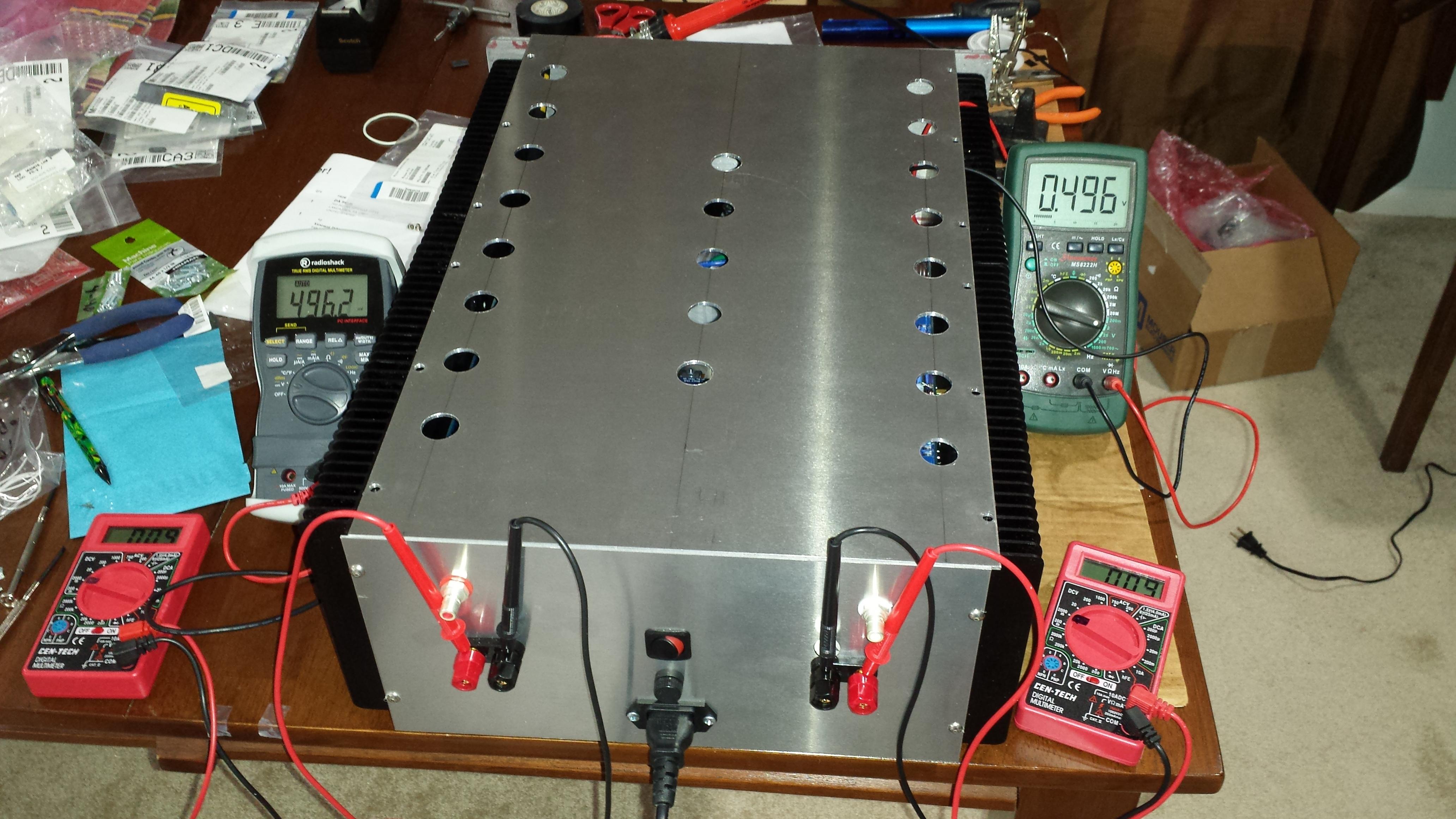

Are these the only changes needed to substitute SS R100's for IRFP240's?
I changed R7 and R8 to 3K, replaced the zeners with green LED's (mouser p/n 604-WP2773GD), changed trimmers to 2K (mouser p/n 652-3296Y-1-202LF). At my bias current, I have 1.5V from g-s on Q1 and Q2. My gate stoppers (R11,R12) are 110 ohms. Not sure how critical the caps are but I chose to use Nichicon Muse (mouser p/n 647-UKZ1E102MHM).
Thank you William!
So far so good.
The variac saved my butt, however, since I had set the pots in completely in the opposite direction. By 50v ac, bias was already reading .500 vdc.
As described in the build described here, go easy when adjusting the pots.
