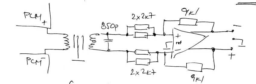

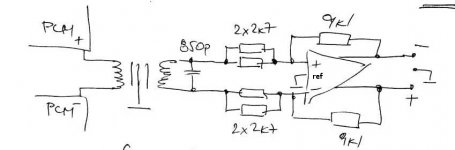

Sure, the input stage could be something other than a complementary follower, but I think there are good reasons for that choice. The input stage needs to have a fairly low output impedance, because of the load imposed by the transformer, which is about 100R at 20Hz and 200R at 40Hz. This suggests a complementary follower stage rather than common drain. Sure, an opamp could be used and would provide the benefit of more voltage gain. But that would lead us off of the Pass Path.
in my opinion gain is not needed and the jfet follower the F6 has just passes the signal on in two directions, enough (like 0 dB - 700 mV RMS while the transformer and the input buffer can go up to +20 dB) to saturate the output stages far above the 2,4V max and deliver linear behavior.
So this is the Pure Pass Policy: keep it simple.
The input config (jfet follower or like Jensen shows in its appl notes with an opamp) is trivial.
OPA1632 is SUSY chip - diff in , diff out
it demands pretty lowish impedance feedback net, and it's having low output impedance
I was using it connected to sec of Beyerdynamic 1:10 mic xformer ; xformer ditto on outputs of two (diff connected ) PCM1704 , then feedback net defining reflected impedance back to chips , to have linear freq through audio band
driving xformer with small bridge power amp , to drive output of small power amp ........
........ may I laugh ..... just a little ?
:clown:

well - if you need some gain , you can really put it instead of buffer and make nice integrated , with ball input
you can then connect two primaries in symmetrical manner , with overall FB connected from their CT to gnd (need to check that on paper , but seems logical in this moment :rofl: )
but - do not forget that 1632 (and TSHA cousins ) like lowish impedance NFB net , resulting in lowish input impedance ; you need ball$ to drive it , too

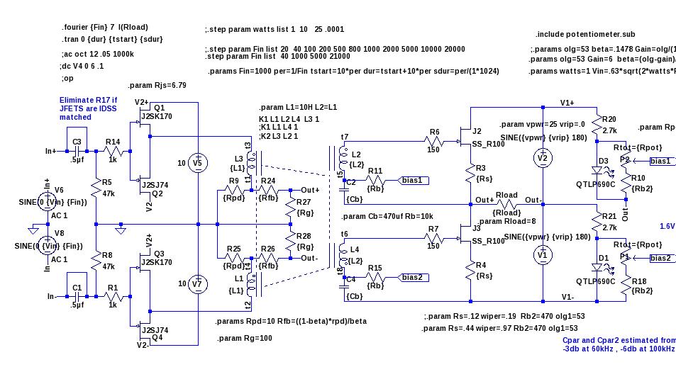

You do not need an opamp for balanced operation. Something this should also work and with floating power supplies will have 2nd harmonic cancellation. See also post #1055.

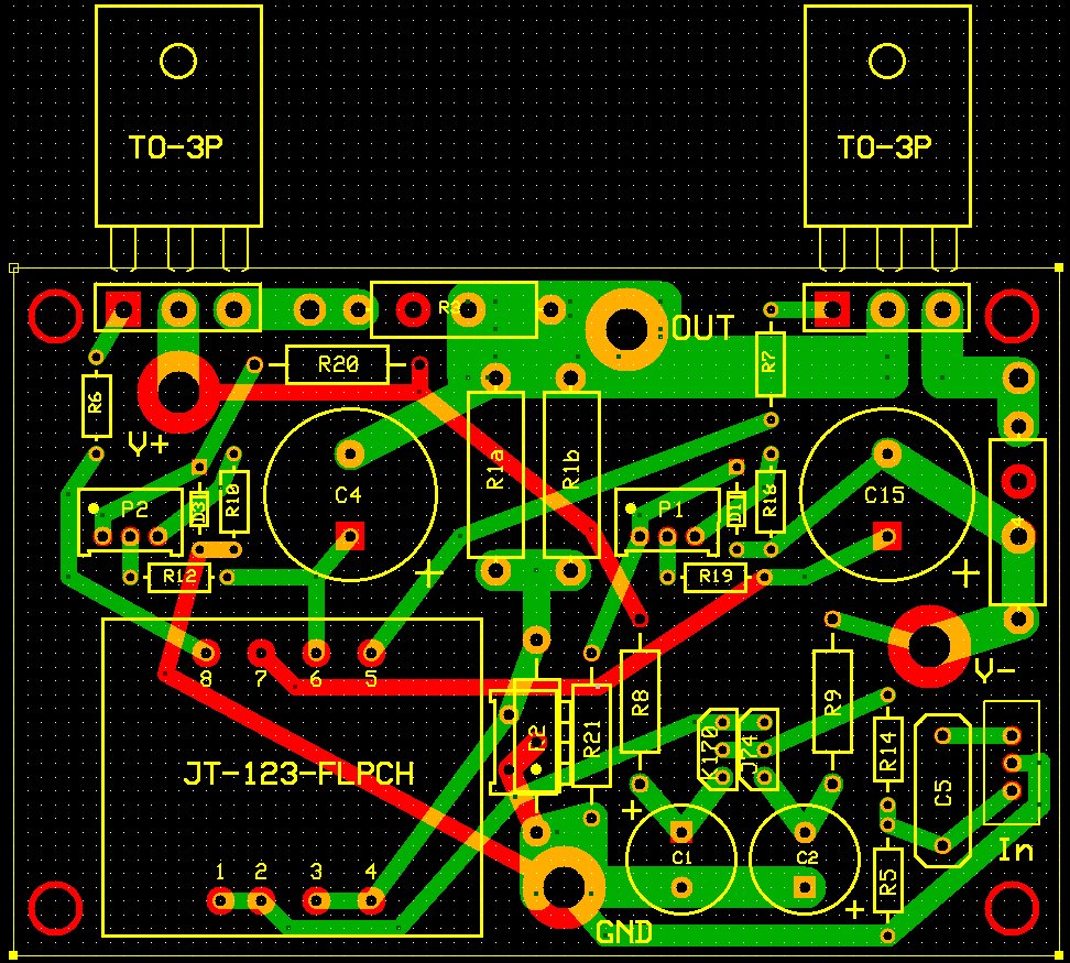

PC Board
I intend to order a prototype build of my PC board today. People who respond quickly can get added to the order. The cost will be about $30US per board plus shipping. Be warned that being a prototype board there could be design errors.
lhquam: You've thought "outside the box" of Conceptual F6. Your attached schematic is solely your design; most probably infused with inspiration by Conceptual F6. You have been free to explore, experiment and thus create a prototype bridge amplifier.
Yes, and no. One you float the power supplies, you might as well go all the way to the circlotron. The only difference is the position of the negative rail power supply relative to the lower output JFET (ie. swap the order). Once you have done this, you can avoid the transformer altogether using the "Amazing FET Circlotron" front end.
